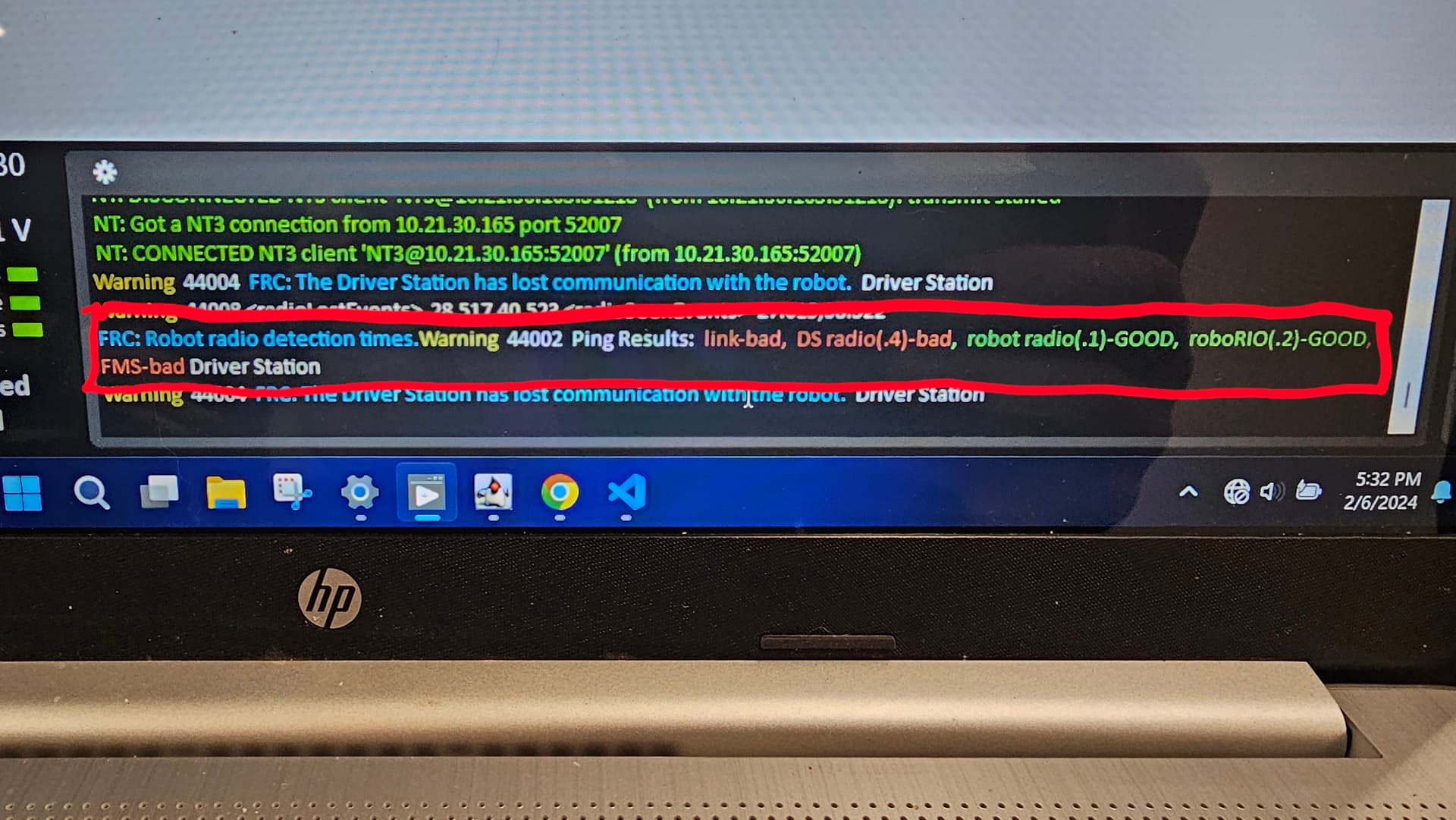

We’ve been having this issue with our robot where for seemingly no apparent reason, our computer will disconnect from our robot at random times. The computer will completely disconnect from the radio and everything.
At first we thought it was an update so we reflashed the firmware to both the roboRIO and radio. That didn’t solve it. We then assumed a wire issue, but nope. We disassembled and reassembled the robot twice to no avail. We’ve put the robot on a table and propped it up so the wheels didn’t touch the floor and ran the robot then, and even with only the wheels moving it still happens.
We’ve had the robot disconnect immediately after enabling, and had it run for 20+ minutes without it disabling, but eventually it disables. We try doing runs without moving it, and runs where we don’t stop moving the wheels. Both times it disconnects.
We’ve tried different laptops, different firmware, different wires. different radio, different batteries, different roboRIO, different fuses, and all seem to result in the same thing.
We have noticed that the swerve modules will suddenly draw tons of power (160 AMPS) and brownout which cases it sometimes, but other times it wont brownout at all and disconnect.

This is the thing driver station said when it crashed

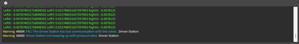

And sometimes it shows this error:

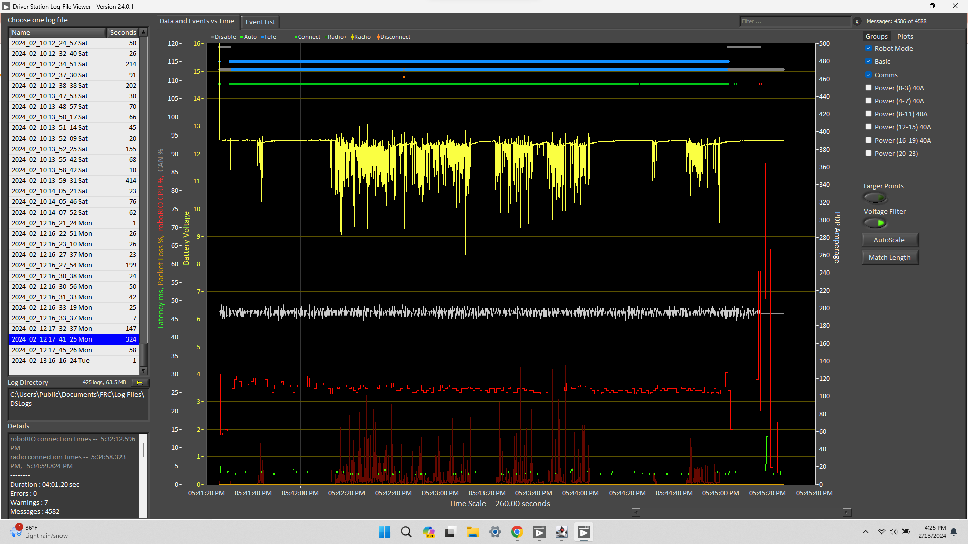

This sounds like a possible code crash to me.

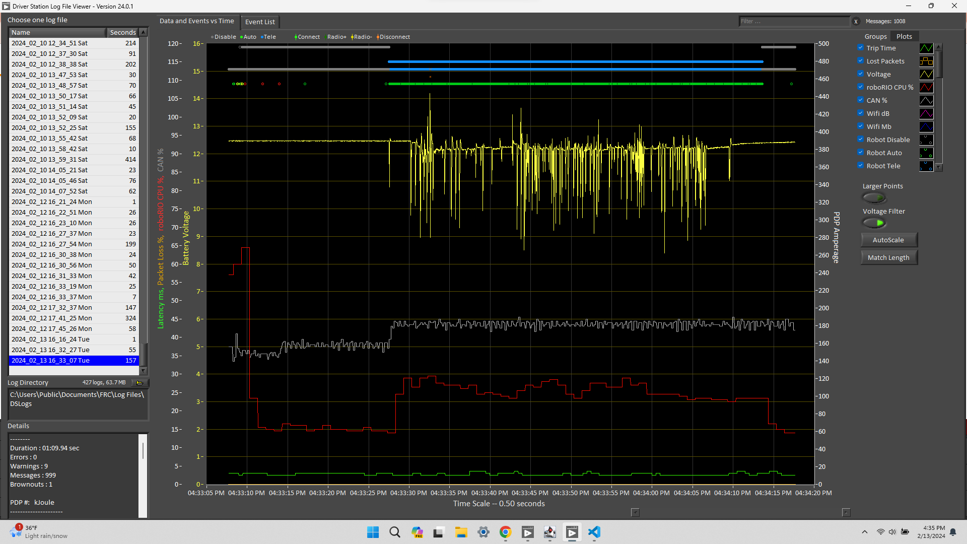

If you are browning out, I would expect to see brown dots all over log graph. I am not.
I see two occurrences of brown out on zooming in. Those may be normal my on your current limits. What are your drive current limits?
Are you using I2C by any chance? Anything plugged into that port on the RIO (REV color sensor) or anything plugged into MXP expansion port?
There’s something going on with the CPU utilization, but it might be a data atrifact in the wake of losing connectivity. Any events show up right around the time where the green line drops out? If you can share your logs from maybe a couple of occurrences of the problem and send a couple of pictures of the wiring on your 'bot, there could be clues there…
