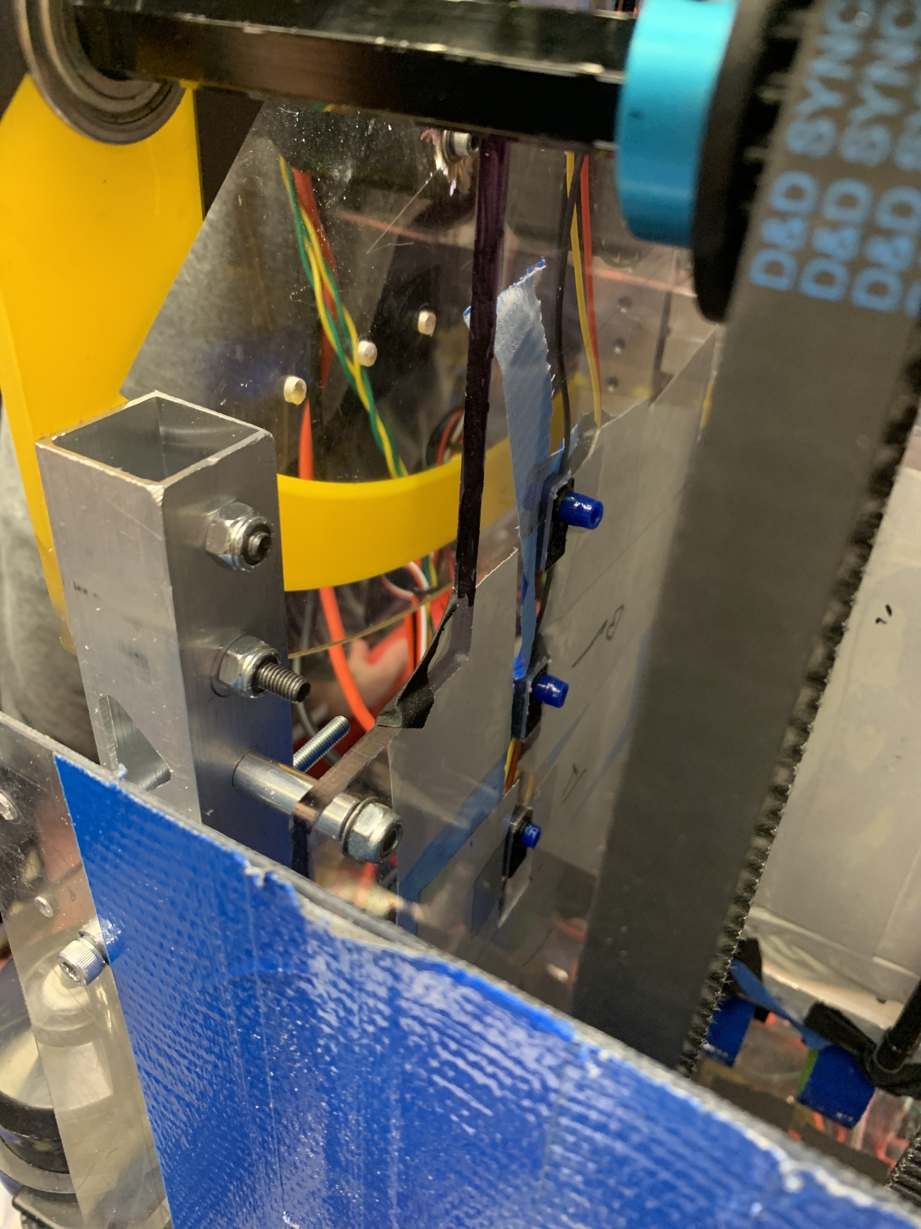

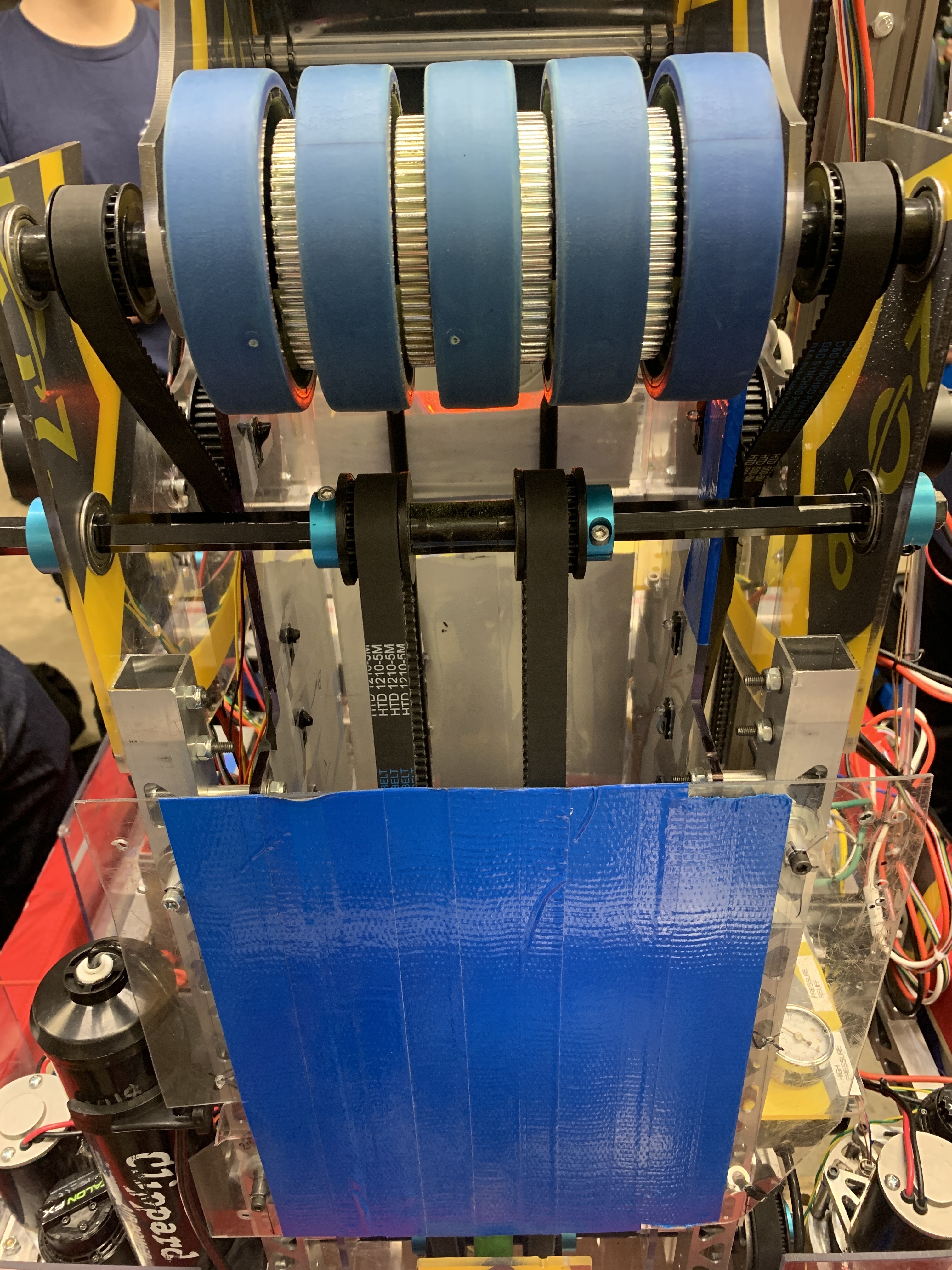

Opposite sides of the ball path, the blue tape wall is something we added between matches to block light. We also just wrapped some electrical tape around the receiver bulbs. I’ll let you know how it works out.
Good luck. Here’s what ours ended up looking like.
The biggest problem we had was the mounting, some driving and they wouldn’t be pointing at each other so we made a 3d print.
Tape and tape wall didn’t work. Next attempt: pneumatic tubing sleeves on receivers.

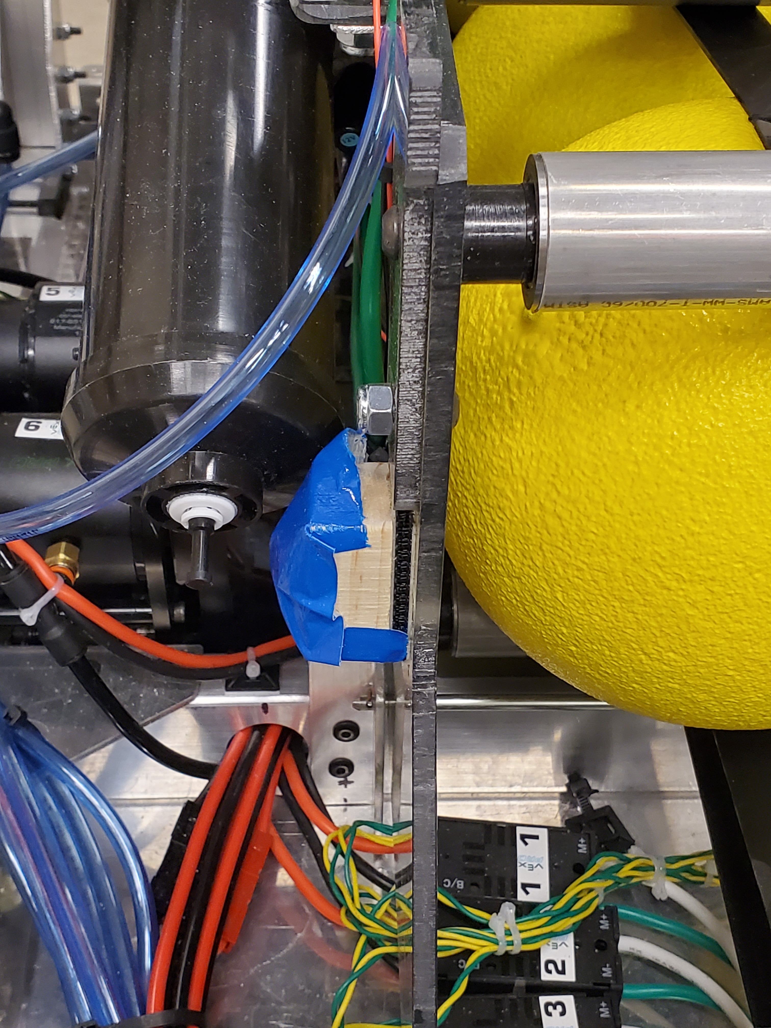

We have several of these sensors on our robot. The shooter (ball outlet), top of climber, bottom of climber all work fine. The ball intake fails. One difference between the locations is the distance to the ball. The intake is a couple inches wider than the ball, thus the sensors are spaced a little wider than the ball, with more room for extra light to get in. We tried tape and a 0.5" pen body light shield, they did not work.
Also, to be clear they are failing to detect a beam break. Which means they are detecting too much IR even when the ball is in place (tested with a cell phone flashlight.) I believe this is the same as the OP.
