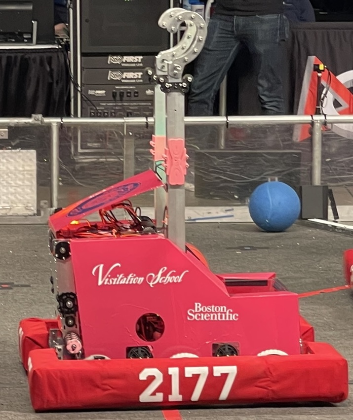

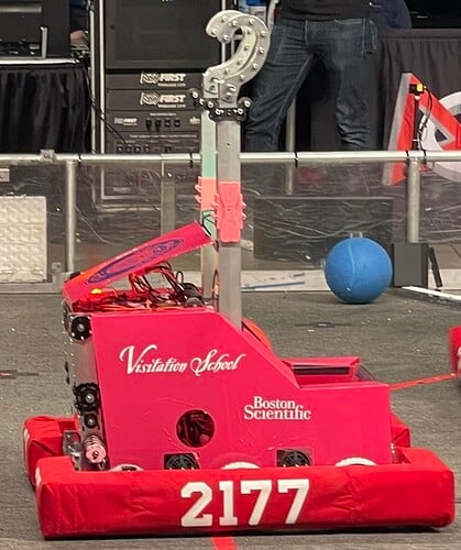

The best way to handle the main breaker is to put it behind a panel with an access hole. The panel gives you a great place to share your sponsors and make your robot easily identifiable, and you can cut the hole big enough to fit your entire hand it it while still providing all the protection you need!
