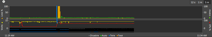

Brown out when tracking is running
When we run our tracking program it makes the robot brown out. Then all inputs from the controllers are delayed by a couple seconds.
The blue vertical line is where the tracking starts.
Could this, or another co processor help this?

I suspect you have something inefficient in your command to track, for example, a tight while loop waiting for something to be returned from the limelight. But as Bobby said, we really need to see your code to identify why it’s pausing the roborio processing (as seen in the broken blue line in the log picture)

As you can see the cpu usage doesn’t move.
But the voltage drops to about 8 volts and we lose robot code and comms. This is odd.

We had an issue with our code using and topping out our roborio, but we adjusted our code, so now the usage barely goes up. We also had an issue with it browning out.
But now when we use our tracking command the voltage only drops to at most 8 volts and then we loose comms and robot code for about 2 seconds.
So we called it “brownout”, but we are not for sure if this is the correct term.
Look at the picture in the previous reply.
It’s not technically a brownout until you hit 6 volts and the roboRio refuses to drive motors in Oder to keep itself alive. Your voltage drop is most likely caused by your tracking command trying to accelerate more aggressively than manual driving. However, you need your radio to be able to tolerate 8 V. How is your radio powered?
