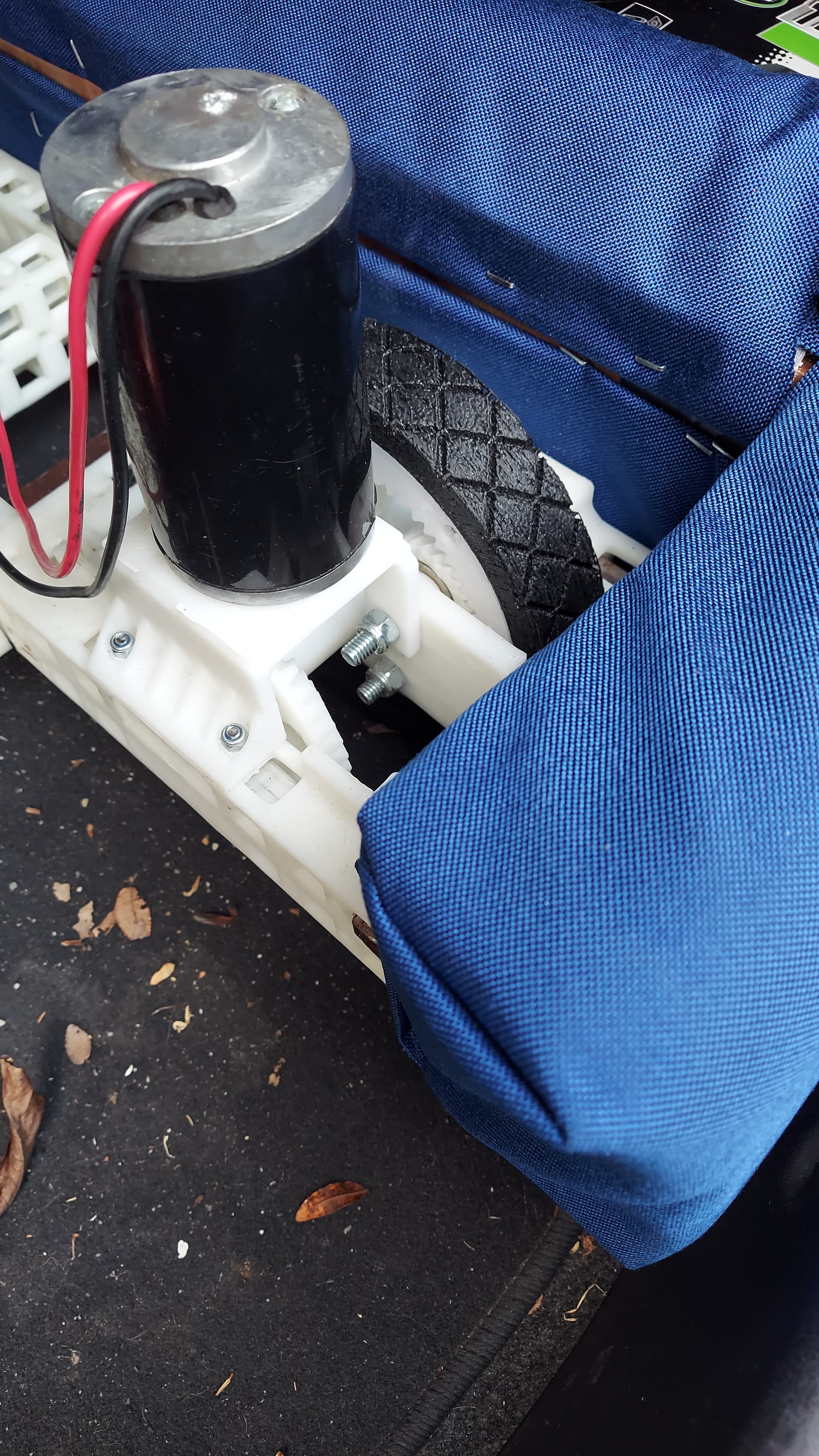

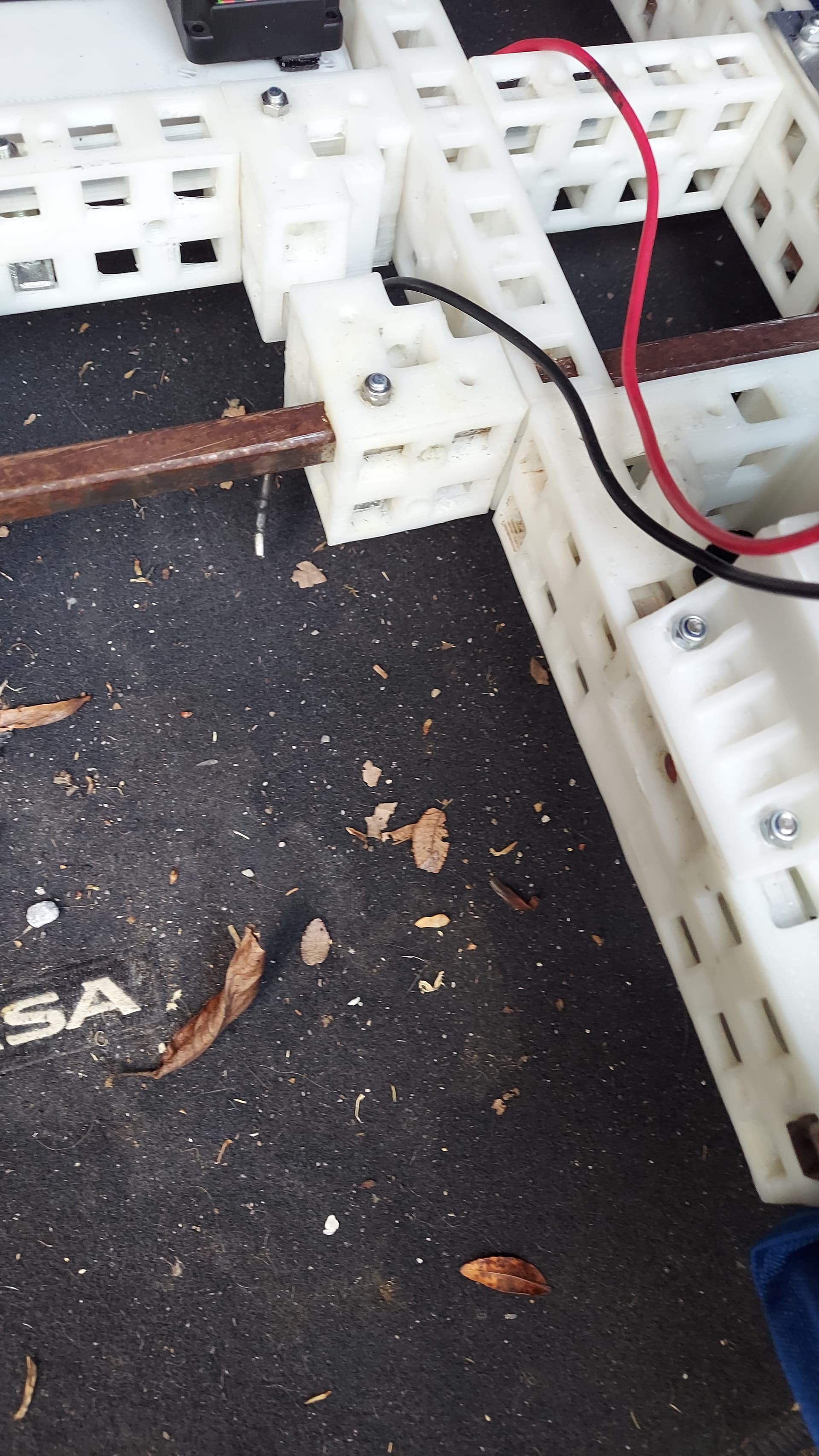

As you can see the 3DP part has 13.5mm square holes (1/2 in plus clearance) and in those in the outside of the frame are 1/2 in square 1/16 in wall thickness steel bars. The structure on the inside has same dimension aluminum instead of steel where they meet they are bolted together and to the plastic with m5 bolts and nylock nuts. So should you by magic remove the plastic you still got a bolted steel/al frame. All bolts are countersunk (printed that way) on the outside so the wood of the bumpers is flush on the steel/plastic combo and is bolted to the steel bars
This pic shows how the bumpers are flush to the frame and also allow a look at one of the drive wheels. We have a CIM motor with a 3dp bevel gear setup (19 : 41) feeding into a planetary that sits inside a 6 in wheel. All 3dp the ring gear doubles as rim for the TPU 3dp Tire - the one we need to make grippier if we get onto acrylic like material agin. The gears were printed in HIPS PETG and NYLON to allow evaluation of different materials. All 3 materials survived a 48 hour bench test and at least for a competition like Brunswick erruption none of them showed any wear or tear. So it might not be necessary to spend the $$$ to go nylon.
The frame was mostly HIPS and the motor mounts PETG. No wall was less than 5mm most were 6mm thick solid prints. As I buy hips/petg in quantity at about $10/kg there was about $110 worth of Filament in the frame about $90 Aluminum and Steel and some 608 and 688 bearings in the drive wheels. None of them loaded in excess of 20% of its rating. 5/16 hex bolts doubled as axles for the planets as that is about 8mm (7.9375) which means 8mm ID bearings will slide on nicely.

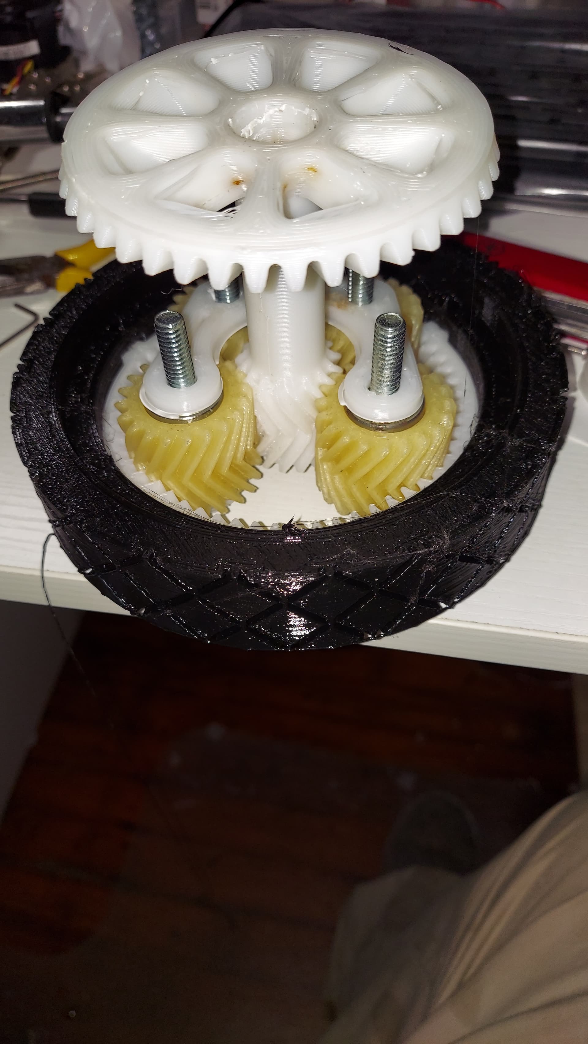

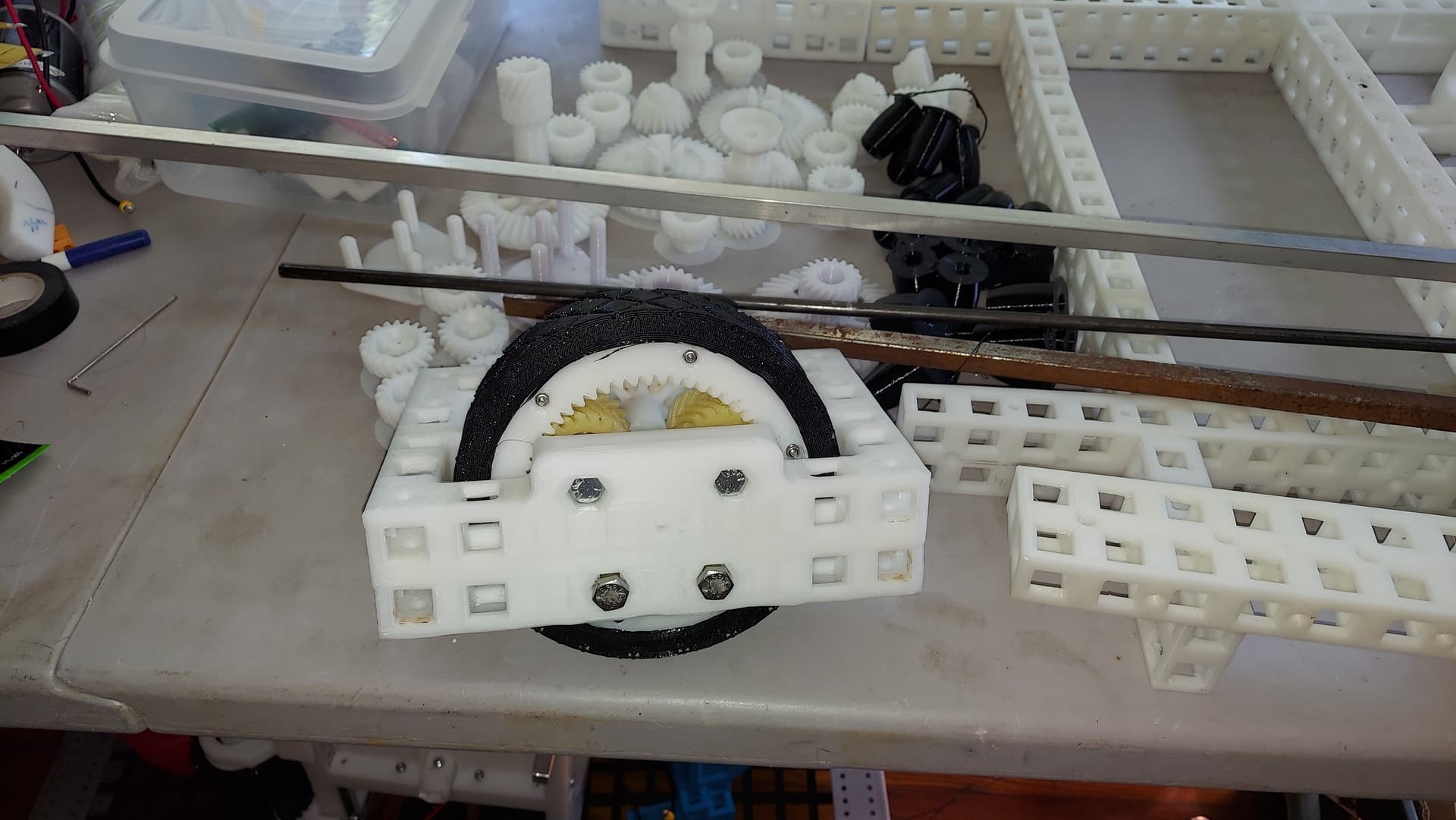

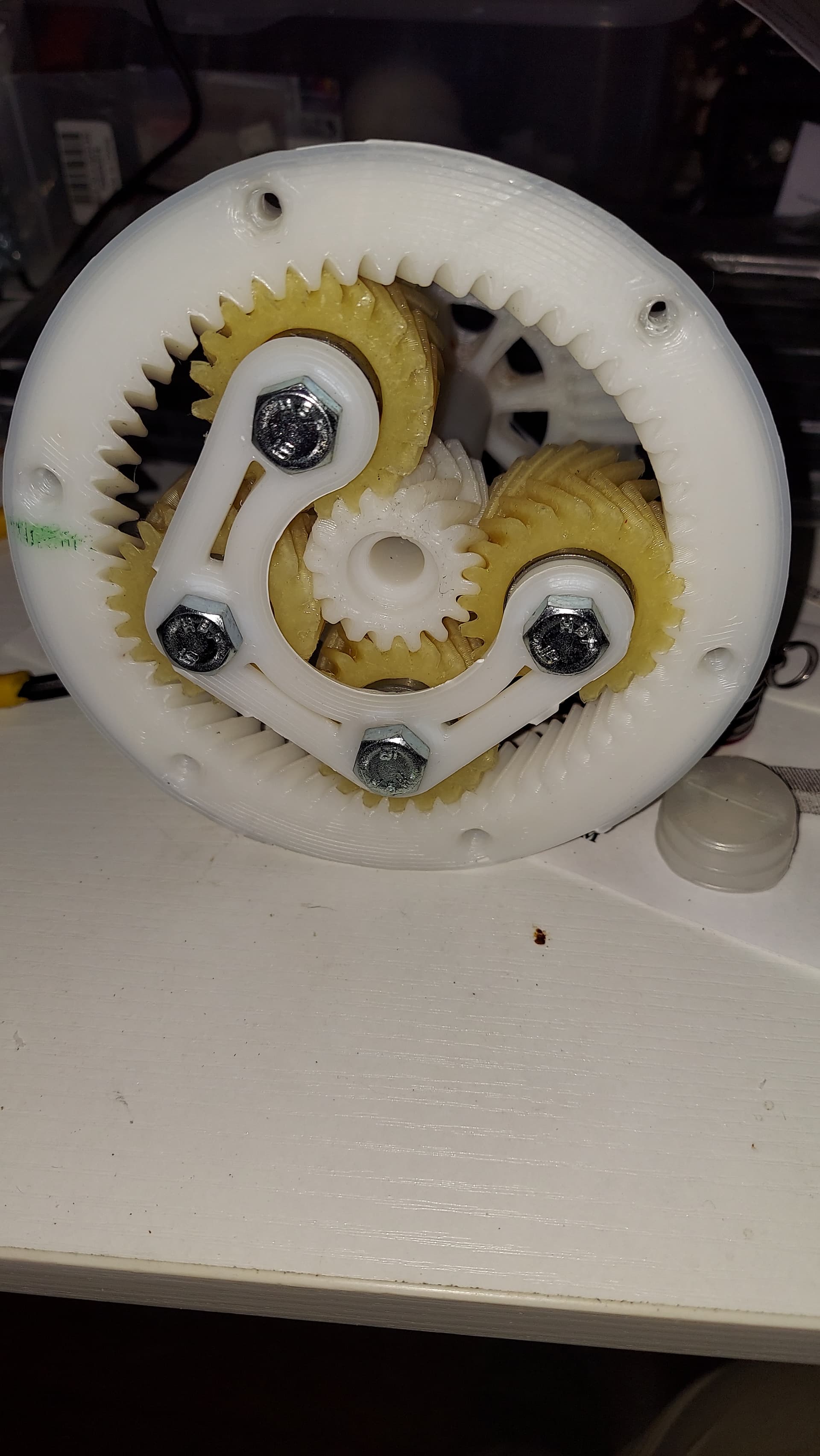

Just waiting for yall to drop a fully 3D printed swerve module now. what tools do you use to make the planetary wheels? and do you have any pictures of them assembled?
Here is the planetary with the alignement tool. The ring is 2 part so you can assemble it and mount the tire. The planetary are 1.5mm module atm The gears in this pic are slightly yellowed as my nylon does that after a while
Here is the Assy with the bevel input
Here is the assy dropped into the frame piece

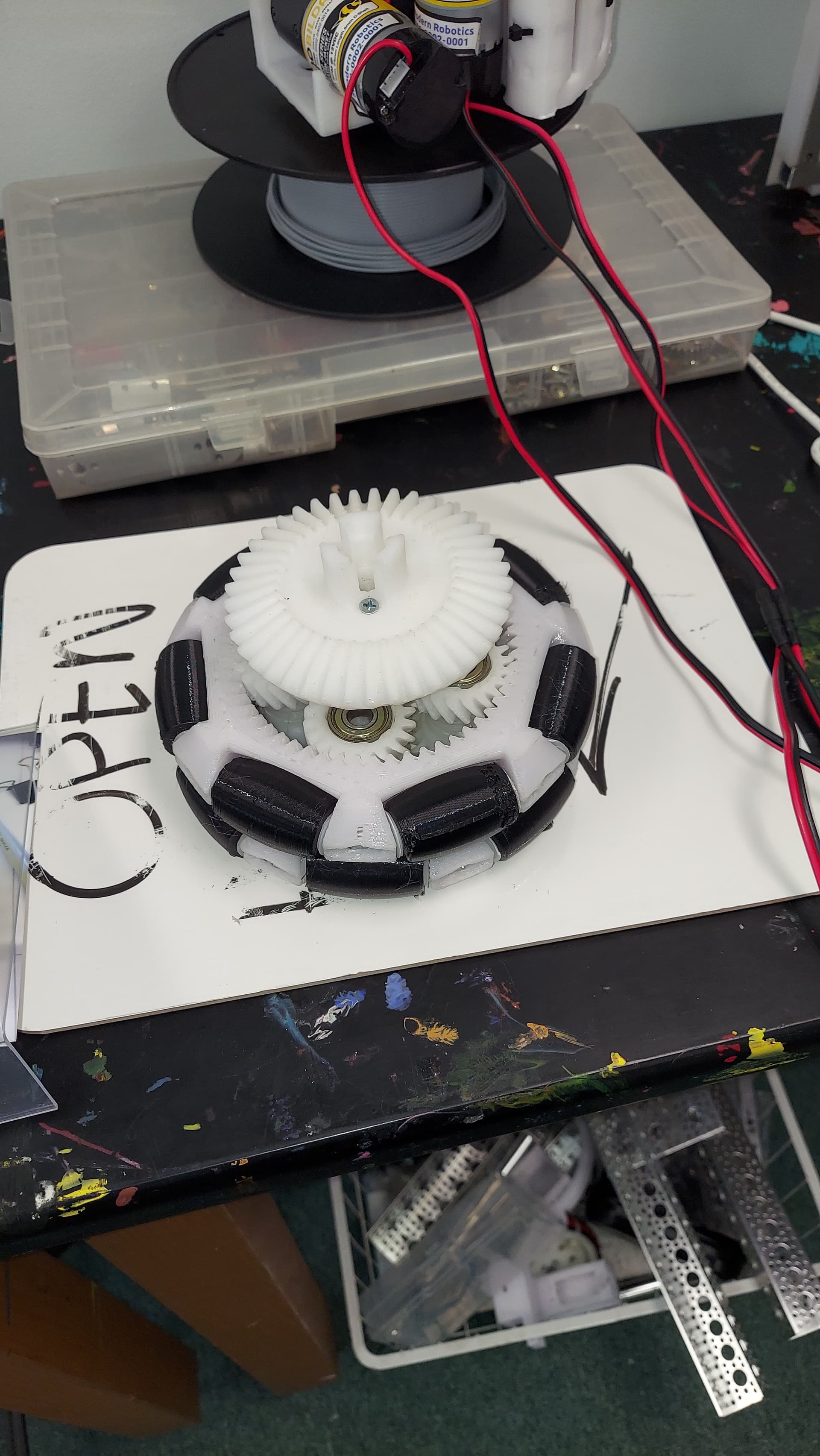

Here is an Omni Wheel version that still needs an iteration or more
