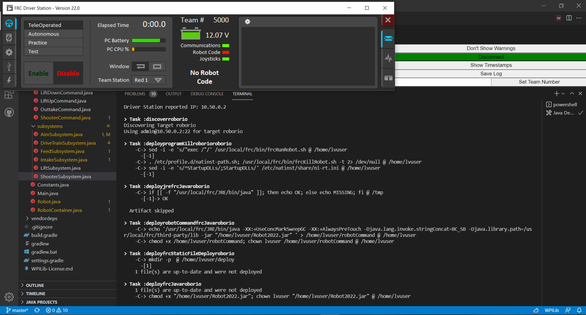

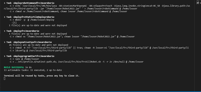

Build Successful, No Code Running Comm Status
We have updated our Rio to the the 2022 version, updated our laptops VS and had deployed code to our robot on Tuesday and it was running.
Today we turned on the robot and the red light was on the comm status. We have tried to deploy from multiple laptops and are getting the same message. It is broken into the two screen shots below. This is a new one on us after 8 years.
There should be something showing up in the DS console log. Click on the gear icon, maybe try doing a code restart in the settings tab of the DS as well.
We will try that tomorrow Peter.
