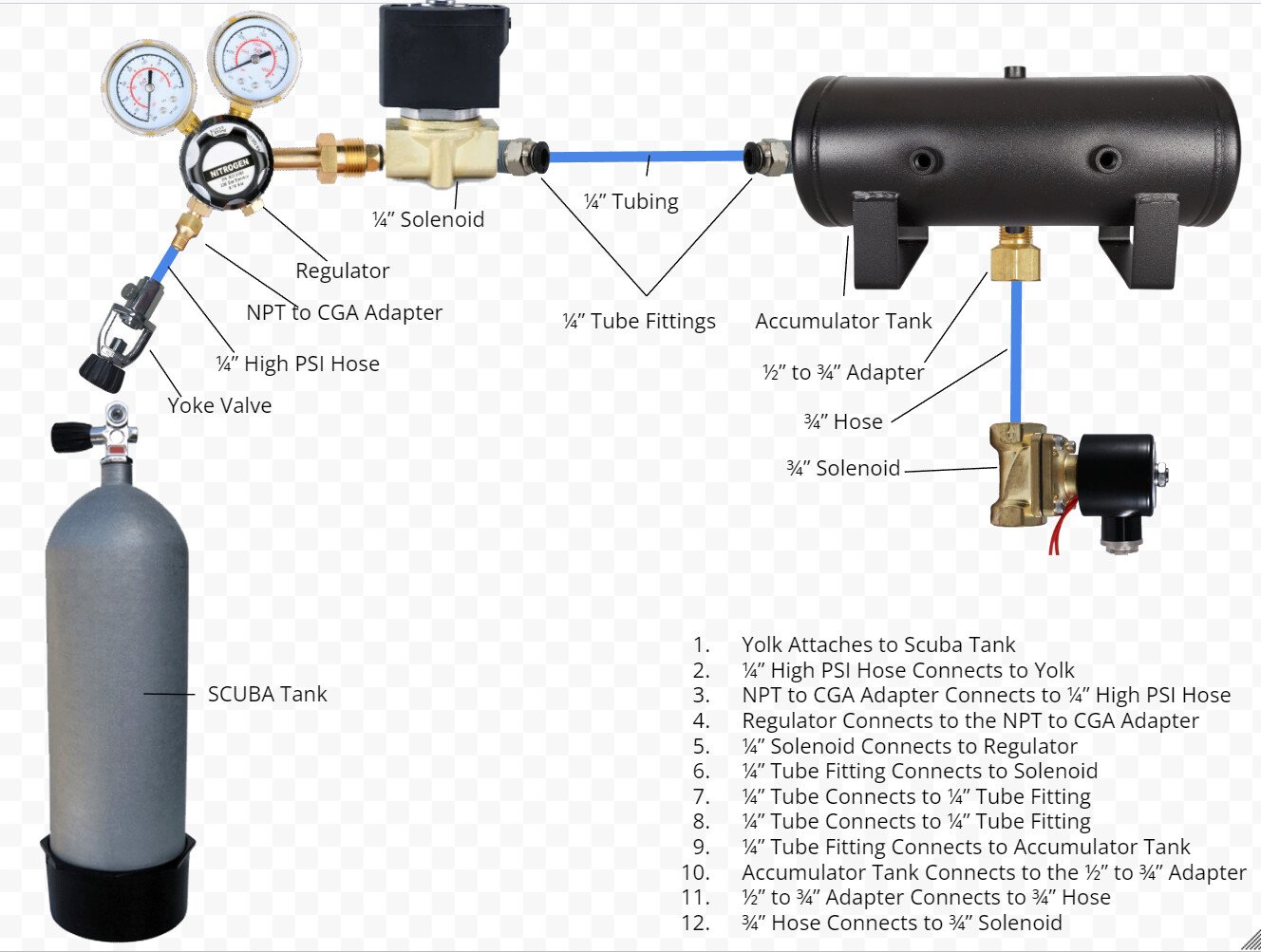

Hi, I designed and built a t-shirt cannon robot for my team last school year. Like everyone has been saying if you have the room it would be highly recommended to use a SCUBA tank. Ik they are expensive but we called a few local SCUBA shops, said what it was for, and they were able to give us an otherwise expensive tank to our team for free.
As for a holding tank (or operating tank as my team likes to call it), having one is very nice to have. If you do not use all the air in your holding tank after a single shot, it makes it a lot faster to “charge up” for another shot. If you do not have a holding tank then the wait time can be a bit annoying, especially since your output is 1/8" (although you do have 3 barrels so charge time isn’t as big of a concern)
If you could send a diagram of your current pneumatic layout that would be great. A CAD of the robot would be even better. Our layouts are super scuffed but it helped drive the “path of air” across so it was easier for other students to comprehend. One last tip DO NOT use PVC and make sure the parts you are using are rated for air PSI as well and not just water. There are a whole lot of t-shirt shooting threads you can search for that will explain more why but pretty much AFAIK when PVC pipes fail under air they will explode and shatter, ie a pipe bomb pretty much.

We didn’t use the 1/4" solenoid between the regulator and tubing
What tank did y’all use for the accumulator tank?
HornBlasters 2 Gallon 6 Port Air Tank Amazon.com
We used this but now it’s like over $100. At the time it was $60 and then a few weeks after we bought it they upped the price (timing lol).

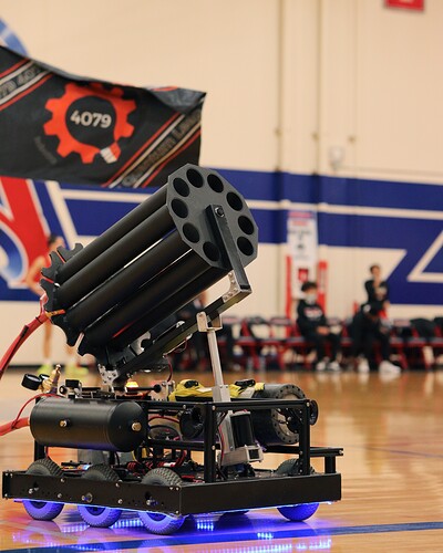

Here’s a photo of the whole robot at a school game.
3256 uses a scuba tank in their t-shirt shooter; I can’t find pix though.
If you’re pressed for time, why not get one barrel working first? You’ll have something to show, and that much more experience when you then add more barrels.
That literally looks so cool…
BTW, the high pressure regulator is backwards in the diagram.
A relief valve on the low pressure air tank is VITAL!

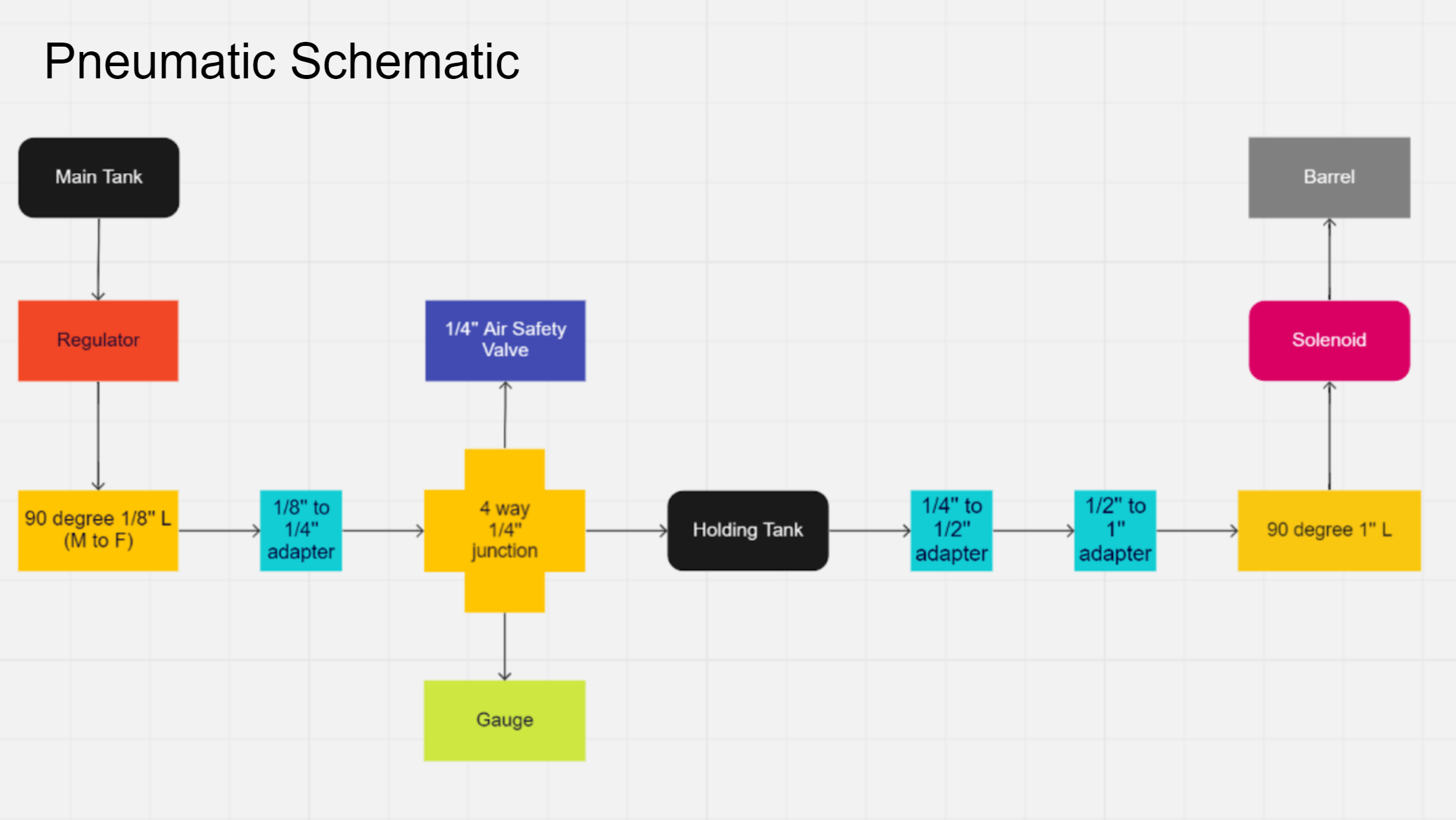

Here we have a schematic for our tubing if anyone has any advice, tips, criticisms please let me know
Most of that looks good! Glad to see the relief!!!
The thing that’s going to kill your performance is the 1/4" to 1/2" adapter. You really want a bigger hole on your tank!
Another way you could improve the performance is to put a section of 1" pipe in there to act as a tiny reservoir. It won’t help a LOT, but it will help some.
