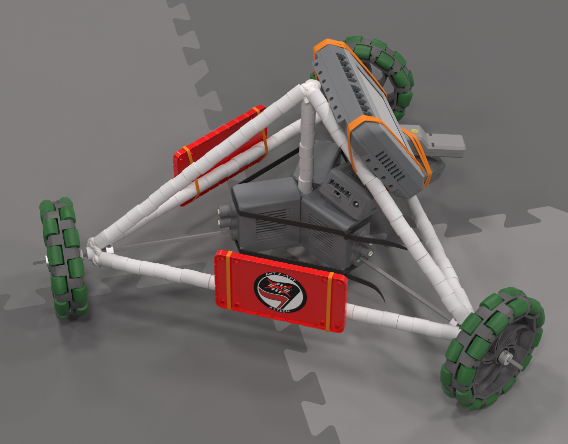

Building VRC Legal Chassis without giving money to VEX
If you are one of the teams looking to build VRC legal chassis, but hate sending money to vex, then we’ve got you covered!
Tetrahedral Tensegrity chassis will solve you moral dilemma!
It may not get you TC, but it will make you immensely proud of your build!
Steps:
  1. Get a pack of 1000 VRC legal Nylon Spacers from Amazon.
  2. Get 1/8" square steel rod and shaft collars from a local hardware store.
  3. Get 100 ft. of VRC legal 1/4" rope or paracord from your rock-climbing uncle.
  4. Find three old 4" omni wheels in the engineering room behind the bookshelf, where the freshmen team hid them last year when they lost the fourth one.
  5. Build the tetrahedral base, ensuring the rope is well taut and secured with zip-ties on the ends to prevent slipping.
  6. Go to a local VEX competition and enjoy seeing everyone jaws drop, while inquiring you what the heck they’ve just seen rolling onto the practice field.

I’ll make sure to show this to my teams, you can expect a Tetrahedral Armada coming from us in the near future.
This is quite possibly the greatest thing I have ever seen of all time
Can we take a minute to appreciate the fact that you’ve actually drawn the rope/knots in your CAD model :joy:

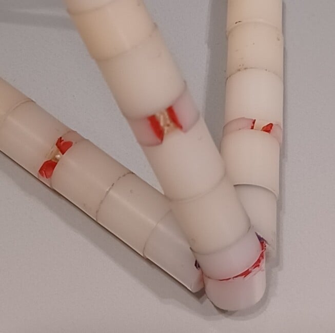

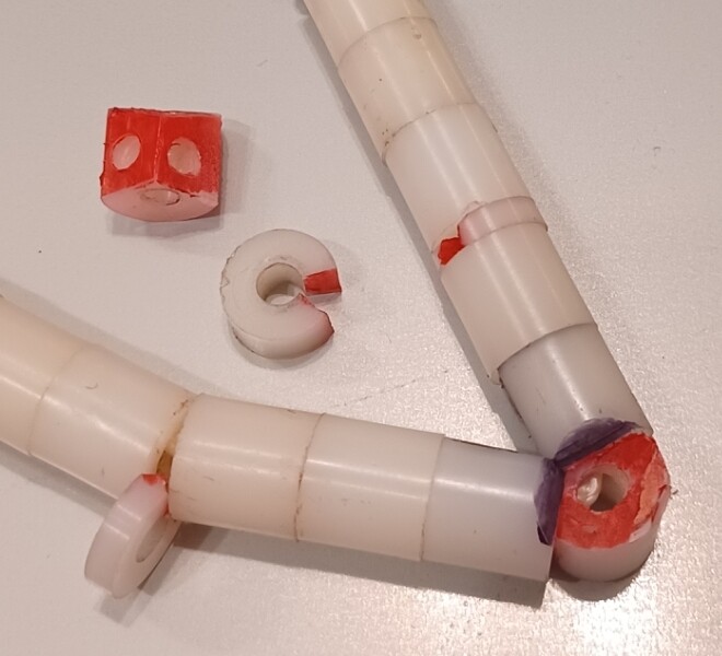

The trick to building this in real life is the custom ground corner and “pacman” pieces:
After you get all the right angles on the corners and pretighten the rope, assorted “pacman” spacers will let you to taut it for extra rigidity and balance the length of the edges:

Just like @OrangeMan said, I’ll use “pacman” spacers.
My “custom machining” was done with utility knife and hammer and then a bit of drilling and grinding with a dremel.

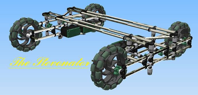

There were attempts before to build something less triangular, like the Stevonator chassis:
But just looking at it, you can sense all the screw connections loosening after the first test drive, unless you douse it daily with threadlock.
