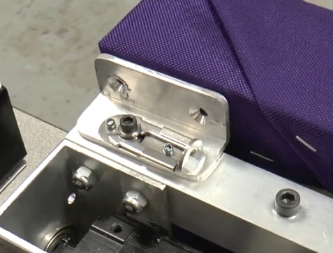

Closeup of quick release latches.
Can confirm, takes seconds to remove using the McMaster latches. Usually our robot is narrow enough that with bumpers it still fits through doors… not this year.
Highly recommend the latches.

Tried those McMaster slide latches this year, but really didn’t like them. We found they tended to catch on the way on and off, and the thin sheet metal frame bent easily under load.
Next year we’re going back to the old stand by. 1/4-20 clip nuts and bolts. Fast enough with a cordless driver, and as strong as you can get.
1895 used these this year to some pretty good success for our first time. Would recommend.
Yeah, the latches work great as long as the bumper mounts are rock solid. At OCR, in quarterfinals, some heavy defense actually bend our bumper mounts, causing the latches to bend as well.
I still like them, but we would need to do a better job of strengthening our mounts in the future

I just want to echo this point. We poorly implemented the latches this year. I think the two problems were we didn’t use thick enough wood screws, and the latches and posts were not positioned with enough precision. What ended up happening was when we came off hab level 2, the bottom of the hab would peel the small metal arms right off the post. I think this also had to do with the fact that this part was a single segment, not a wraparound.
Triple Helix photo of latches for references.
Can confirm, use of these latches is not advisable with single segment bumpers. For the most part they were okay, but due to variation in construction, our front blue bumper segment had a tendency to fall off during match play. The inspectors were not very happy with how far away you could pull the bottoms of the bumpers.
