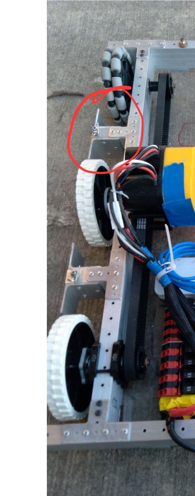

This means the bumpers have to be backed by contact with the frame every 8 inches - not that they have to be attached to the frame every 8 inches. The intent is to avoid having large spans of bumper wood that are unsupported, as a hit in such an area is likely to split the wood/cause bumper failure.

This is a pic of our practice west coast drive we made last year. See the angle brackets i circled, we had to put thise on to keep support of the bumpers closer that 8". With the kit bot chassis there is no need to do something like this.
