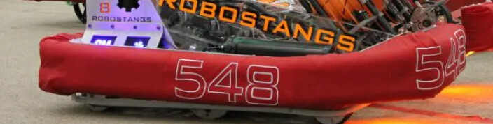

A more obvious example of this is 548 2012:
*we used the same bumpers in these years…worked out as the field obstacles are identical. I do not recommend this anymore due to more aggressive driving in recent years.
