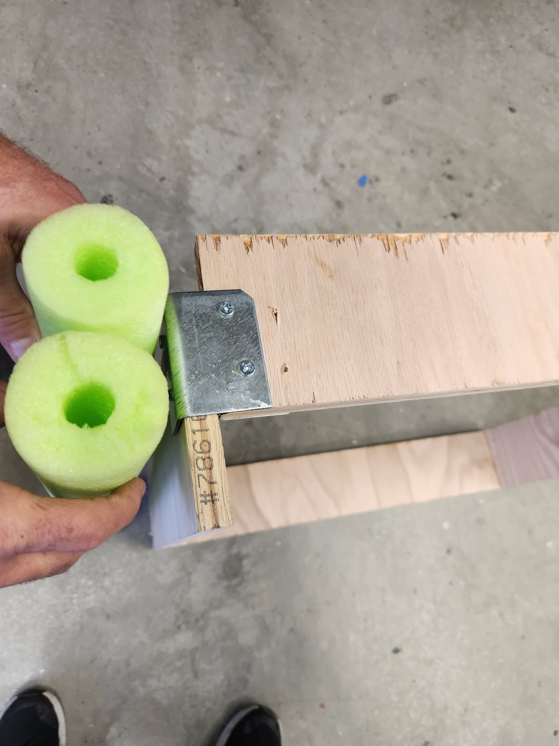

Quick questions for anyone willing to hear. We’re trying to have a one piece bumper that can intake in the front. The problem is that one of the sides we raised in order to intake but I’m not sure if we’re able to place corner bumpers in the right place to make it legal. Would anyone uave some ideas? Or should we switch to another design?
This is similar to what we did; however, we only used one noodle in that orientation rather than two. Take a look at R409 in the game manual. It has a picture of the single noodle like we used.
We did angled sides rather than a step change at the corners, but as long the bumper section looks about the same as the one in the manual, you will be fine.

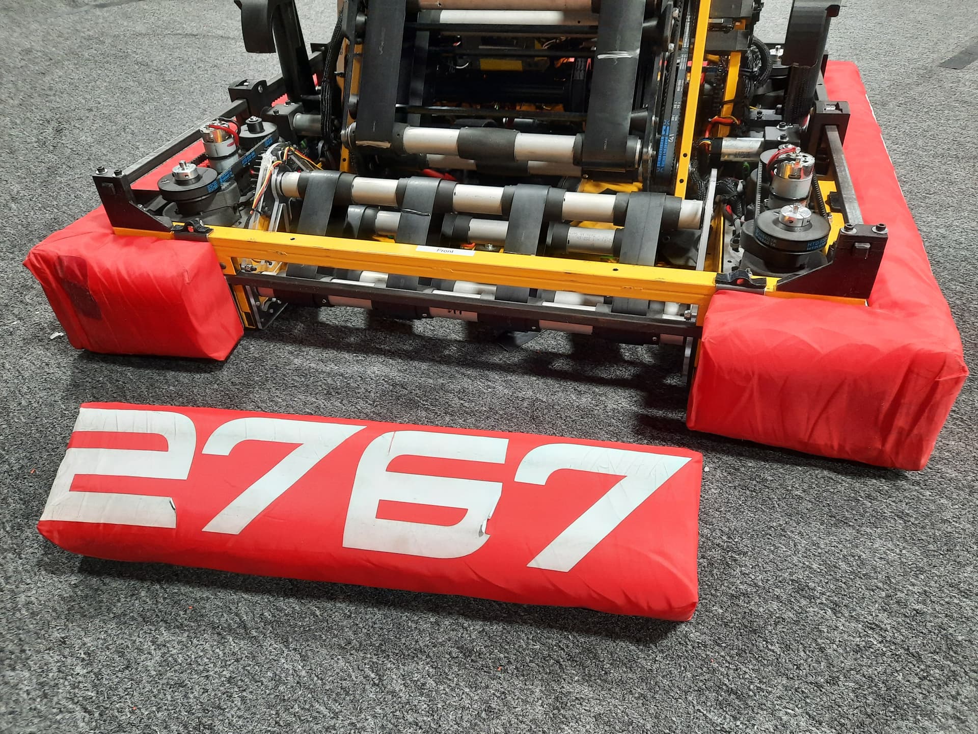

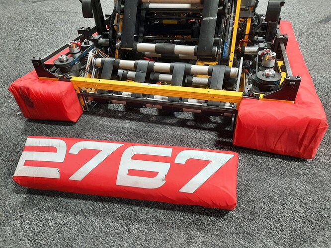

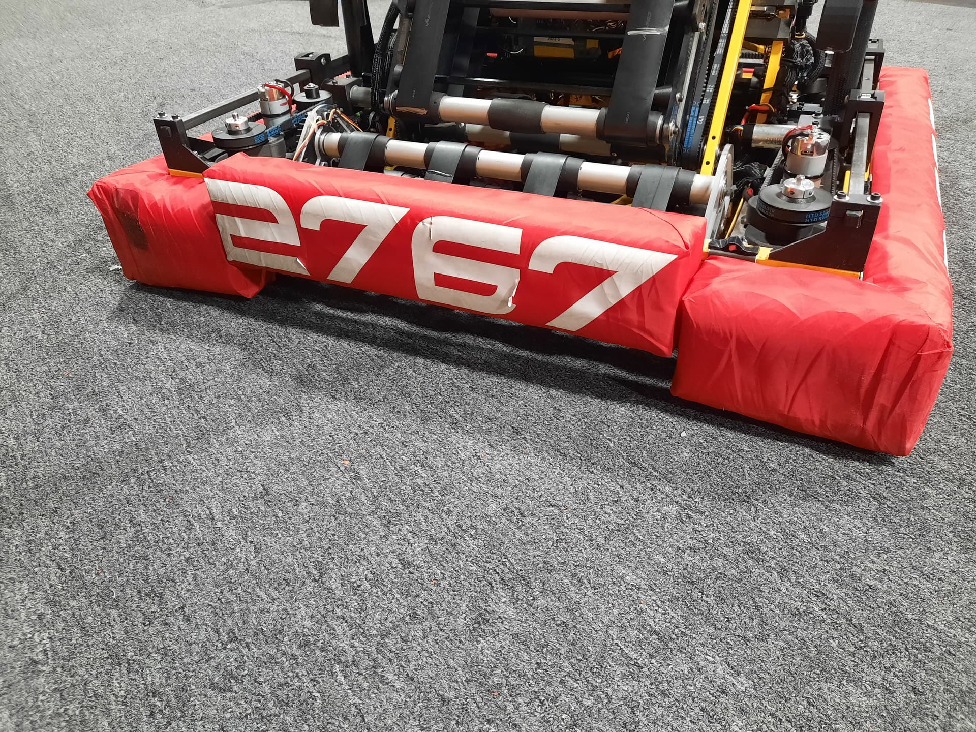

Have a look at 2767’s bumpers.

Yup, ours were very similar. We simply mitered the noodles on each corner. It means that the front corners you essentially have noodles meeting in the middle, with one above it on the front and one below it on the back.
Even with the bumper segments at different heights, you still need noodles protecting the corner!

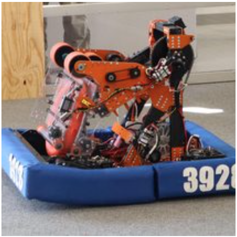

Safest course of action, IMO, is to “swoop” the side bumpers.
Numerous robots, including ours (see pic above), have passed inspection using that style.
I think Q&A 99 is highly relevant to this thread - any of the corner methods can be used. I would say you need a minimum of 2 noodles of height in the corner, but don’t have an issue with 3 - the whole point is protection, and we want to ensure overlap on bumper to bumper impacts.

I think it’s pretty clear that the rules around bumper corners were not written with segments at different heights in mind. The reason I think 3-high is OK is because I can look at it from each side and say “those two noodles are extending into the corner”. With my team, we mitered the noodles at a 45 all the way around, so the front corners might as well be 3 high - two high on each “half” of the corner, offset by a full-ish noodle. I think doing that is a completely reasonable interpretation of the rules, and with Q&A 99 saying that any corner method is legal for bumper segments of different heights, I have to extend that same logic to the others as well.
