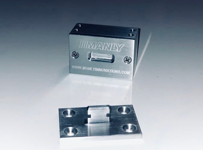

I know my friend Joe @Manly_Innovations would love to get these to market for FRC applications. I personally think they could be used for much more than just bumpers, such as implement switch-outs for different mechanisms. Obviously too late for this year to get production of these for FRC, but for next year…
This is from a 2018 thread HERE.
https://manlyinnovations.com/

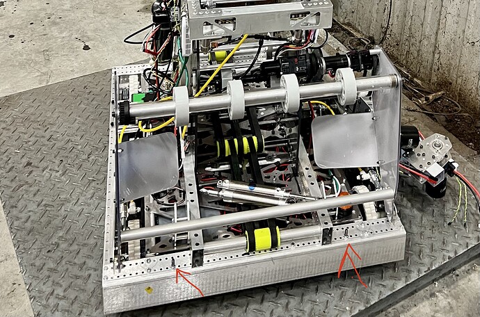

If that does what I think you are describing, it sounds like this would result in bumpers that are not supposed to pass inspection per build rules. As an RI, I’ve asked teams to fix bumper for similar reasons, but haven’t seen that with the AM brackets, personally.
For fun, my favorite instance was telling a team they could not, in fact, mount their bumper to an articulating frame perimeter.
It looks like those AM brackets could reasonably be used with quick release pins mentioned a few times here to replace the wing nuts. All good solutions.

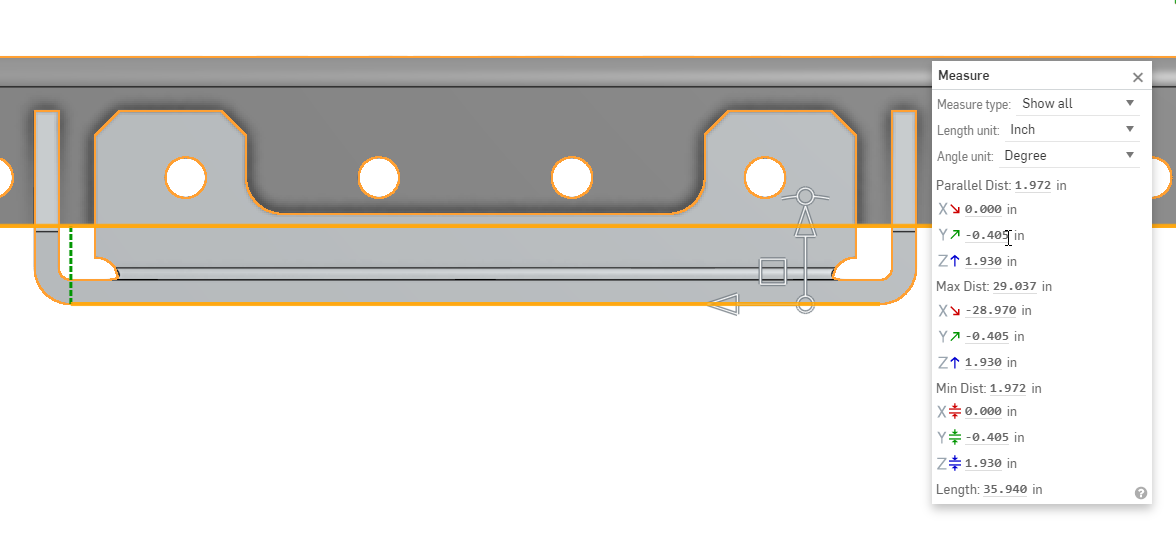

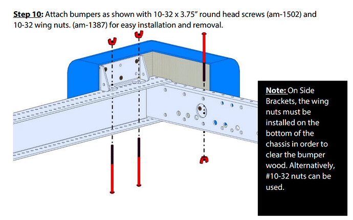

We used the KOP drivetrain for the first time in a while this season and decided to use the provided bumper mounting system. We used it as described in the picture with the correct side mounts. I’m glad AndyMark is providing a system for the KOP chassis teams, and it is better than the old system, but it was still a bit of a nightmare to install and get all of the bolts to lined up for each bumper segment. This year CHS has all 1 day events, so we never had breaks of more than 1 or 2 matches and it was definitely a longer process than you’d expect to get these on and off.

And that’s the problem. All too often, trying to fix it at an event causes huge problems for teams.I pulled the CAD for the outside plate and the front bumper mount into onshape to show the problem - it leads to a gap of .405", well more than the 1/4" allowed in the rules. I wish Andymark would move those holes in the frame back a bit (at least .155") towards the bend, so when teams make this mistake they still end up with legal bumpers.

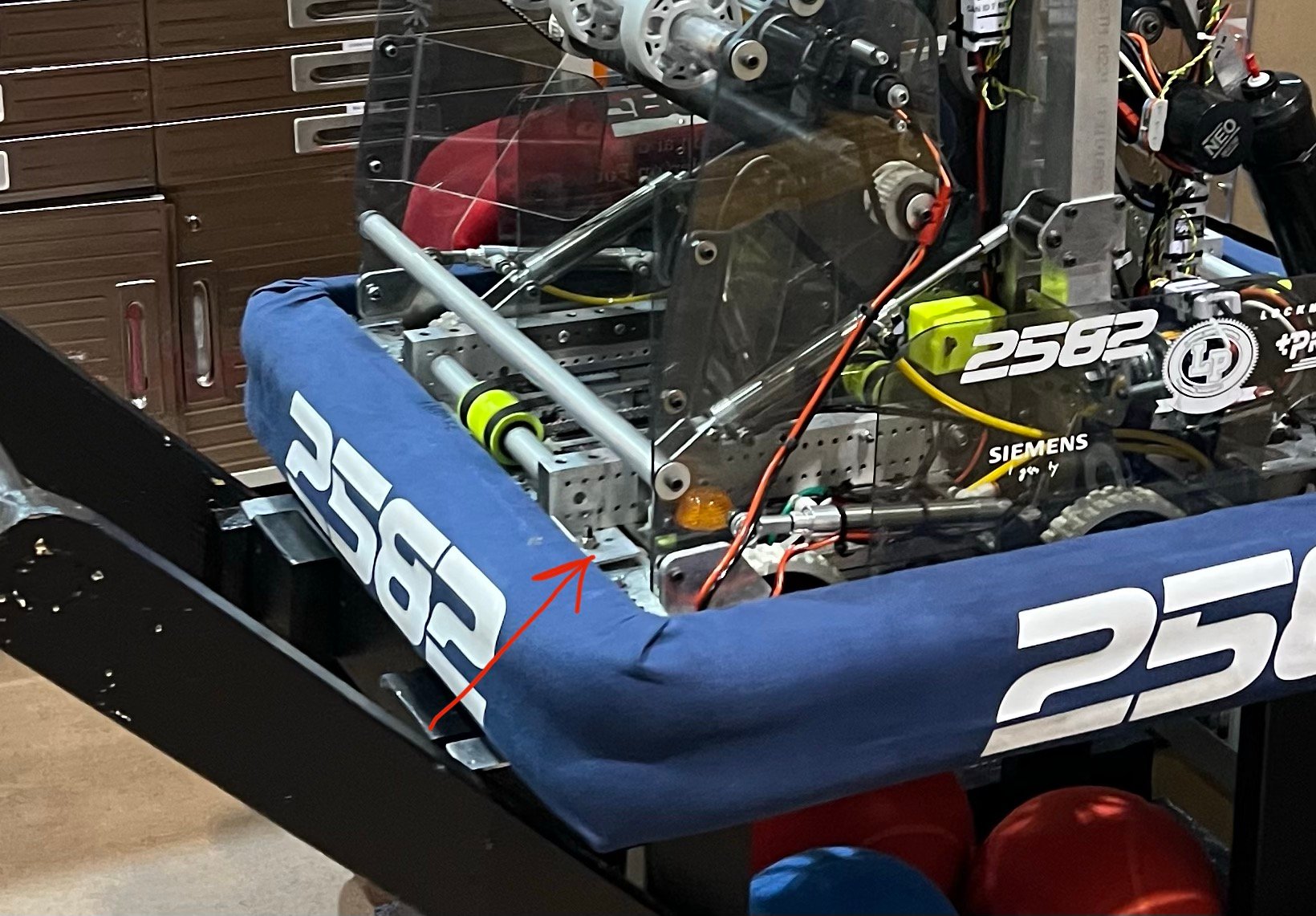

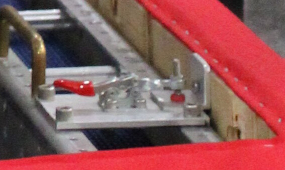

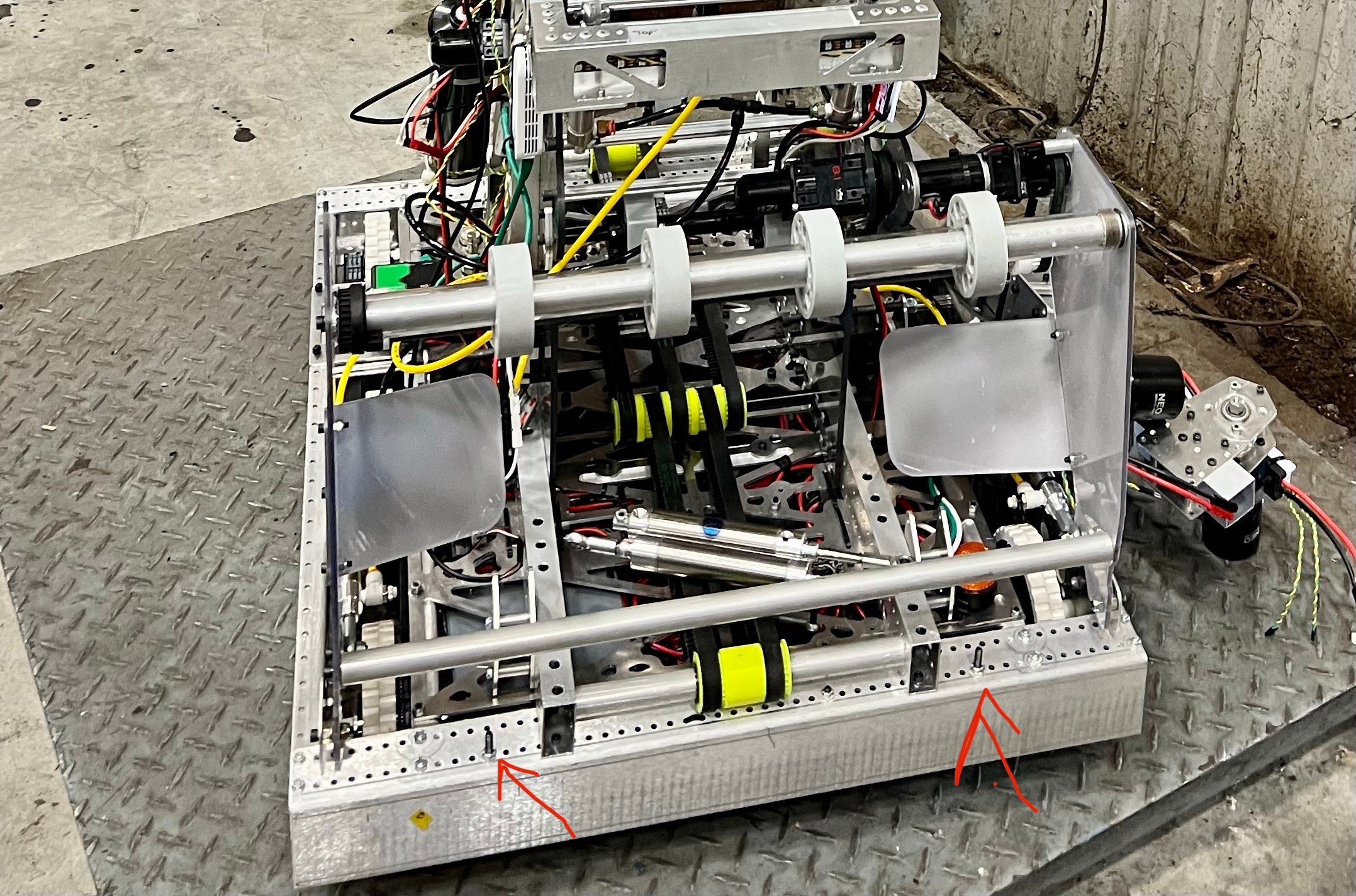

One thing that I haven’t seen mentioned here (edit: looks like @awulfing posted about this method earlier in the thread - the method seems very popular in the PNW!) is the use of toggle clamps to hold down pieces of aluminum angle that are attached to the bumpers. Here is a short description from EricH about how to do this:

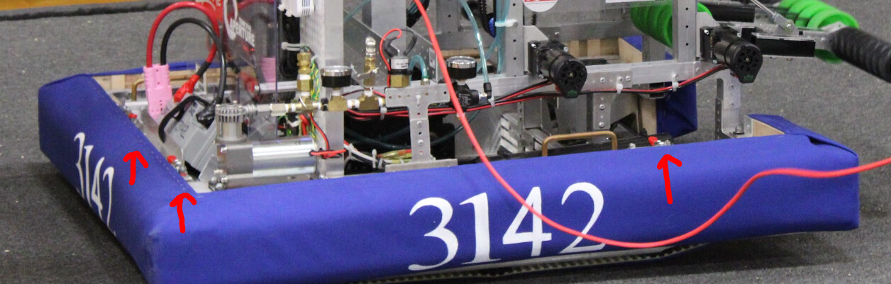

2930 has used this method in the past. I believe we may have gotten the idea from looking at some of 1983 and 5803’s robots from around the 2016ish time period. 3142 also started using this method this year, and we specifically use this clamp: https://www.mcmaster.com/5128A61/
Here are some images of the clamps used on 3142’s robot: image
Because our bumper has a gap for the intake, we have to use screws to attach the bumpers on that side. But I think having 2 screws to replace is better than 6…

A lot of the issues with bumpers come from how the bumpers are built including the order in which the steps are done. Often, there is no thought given to how to make different parts line up properly. One of the teams I was inspecting at Channelview took over half an hour to get their bumpers installed, probably for the first time. The last AM bracket (screwed to the bumper wood) just would not line up with the chassis. Taking a closer look, I noticed they had just screwed the brackets to the wood with no attempt to make the brackets line up with the chassis so one of the brackets was about 3/4" too high. The solution was to remove the bracket, clamp it to the top of the chassis rails then screw it to the bumper.
