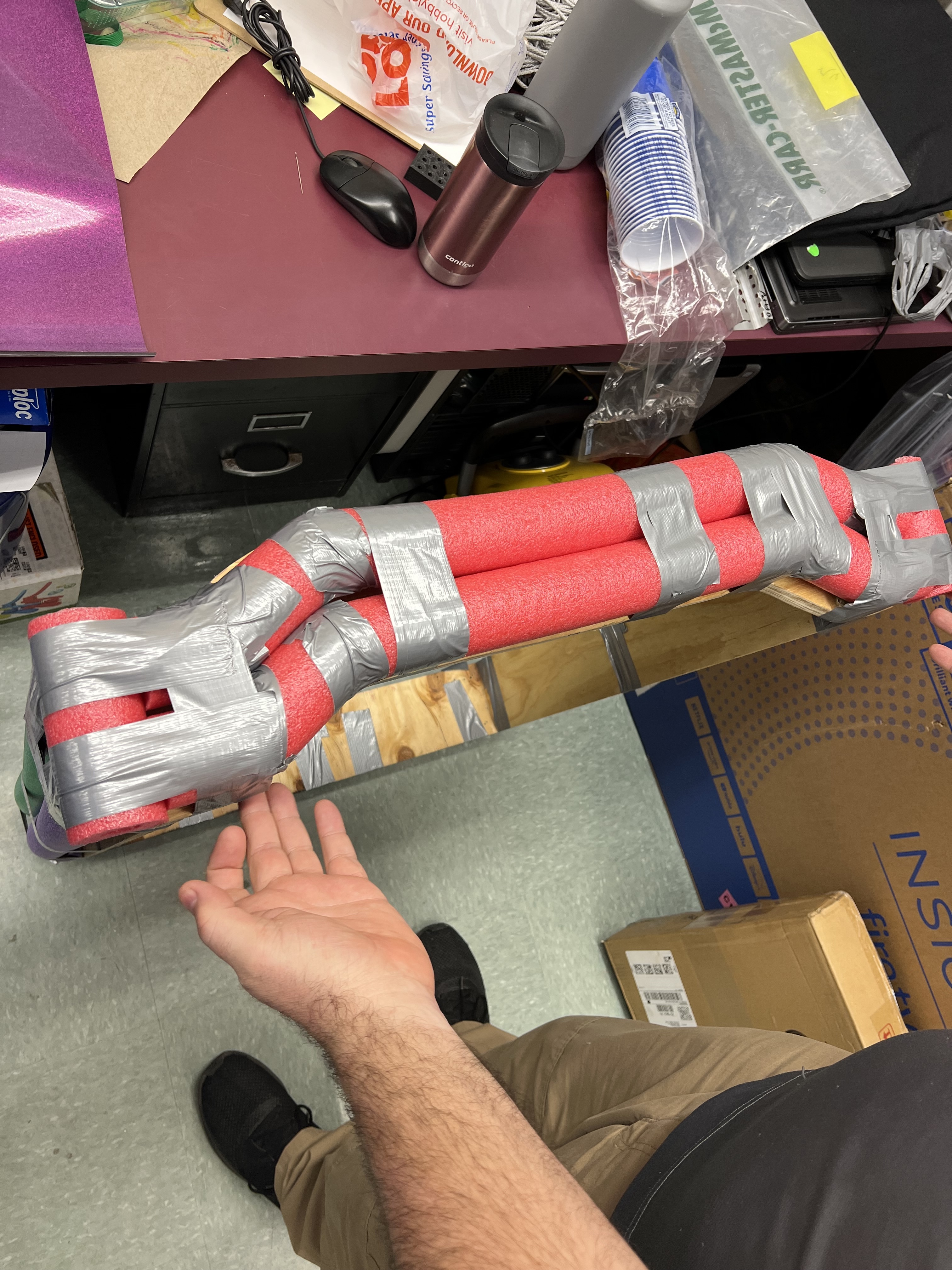

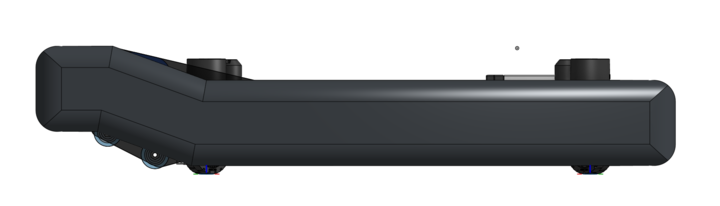

We are thinking of doing something like this on the sides…

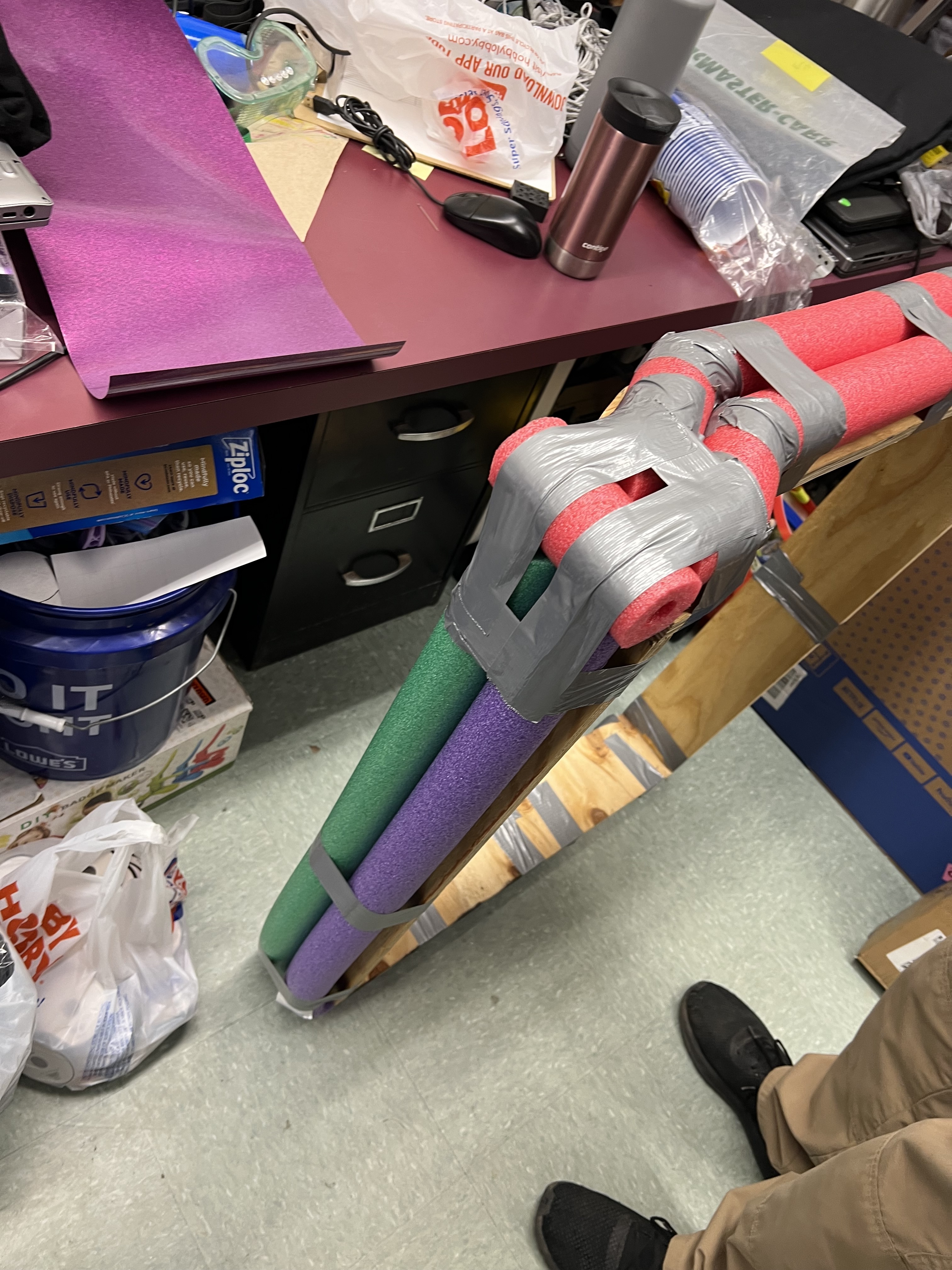

These are our practice bumpers that we are working on. I think these noodles and layout meet all the requirements in the rules (well they will when wrapped with fabric). The highest point when mounted is about 7 1/4 from the floor the plywood is between 4 1/2 to 5 1/2 inches in all places. Noodles are of legal size. Please let me know if we are missing anything.
Yes to both designs above. That is the intent of the rules that have been in place for many years.
