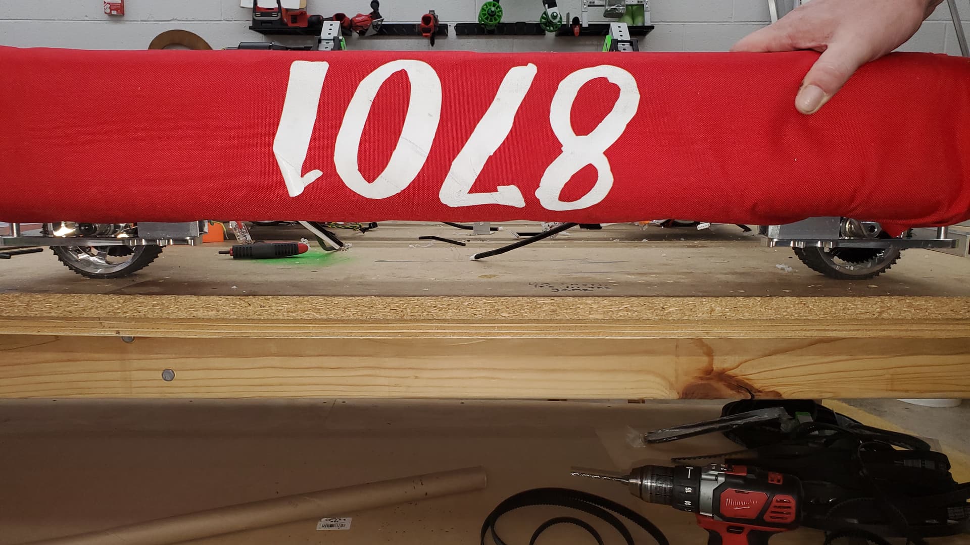

Hello, Our team has been working on confirming the rule behind bumper configurations. We require some clarification regarding our setup. We have replaced the 2x1 section on the front of our swerve drive with 1x1 to accommodate an under-the-bumper intake. We are wondering if we can raise one side of the bumpers higher off the ground compared to the rest. This photo shows a mockup of what we are thinking. We appreciate any help that can be provided. If needed, we can provide more photos or information. Thank you in advance.

Yes, one of your segments can be higher than the others, so long as it still fits within the described bumper dimensions and locations (around 3.5" from the ground max iirc)
Just to clarify. The maximum is 7.5" from the top of the bumper to the ground and then the backing board must be 5 in. ± 1/2 in. This can get you up to a 3" gap although it would probably be advisable to give yourself some amount of margin.
