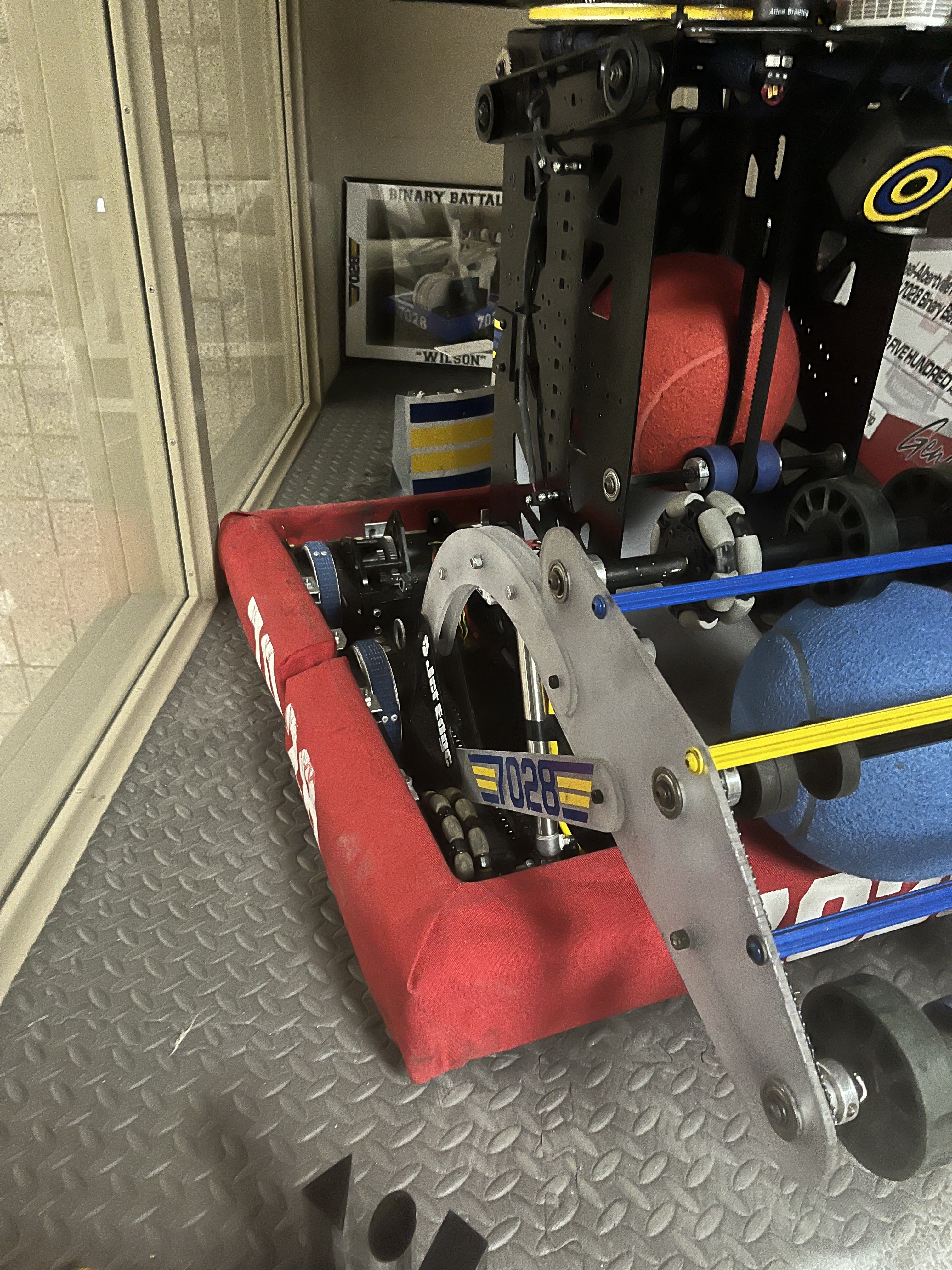

This year you must have bumpers that go completely around the your robot, do you suggest using reversible since they will be harder to take off?

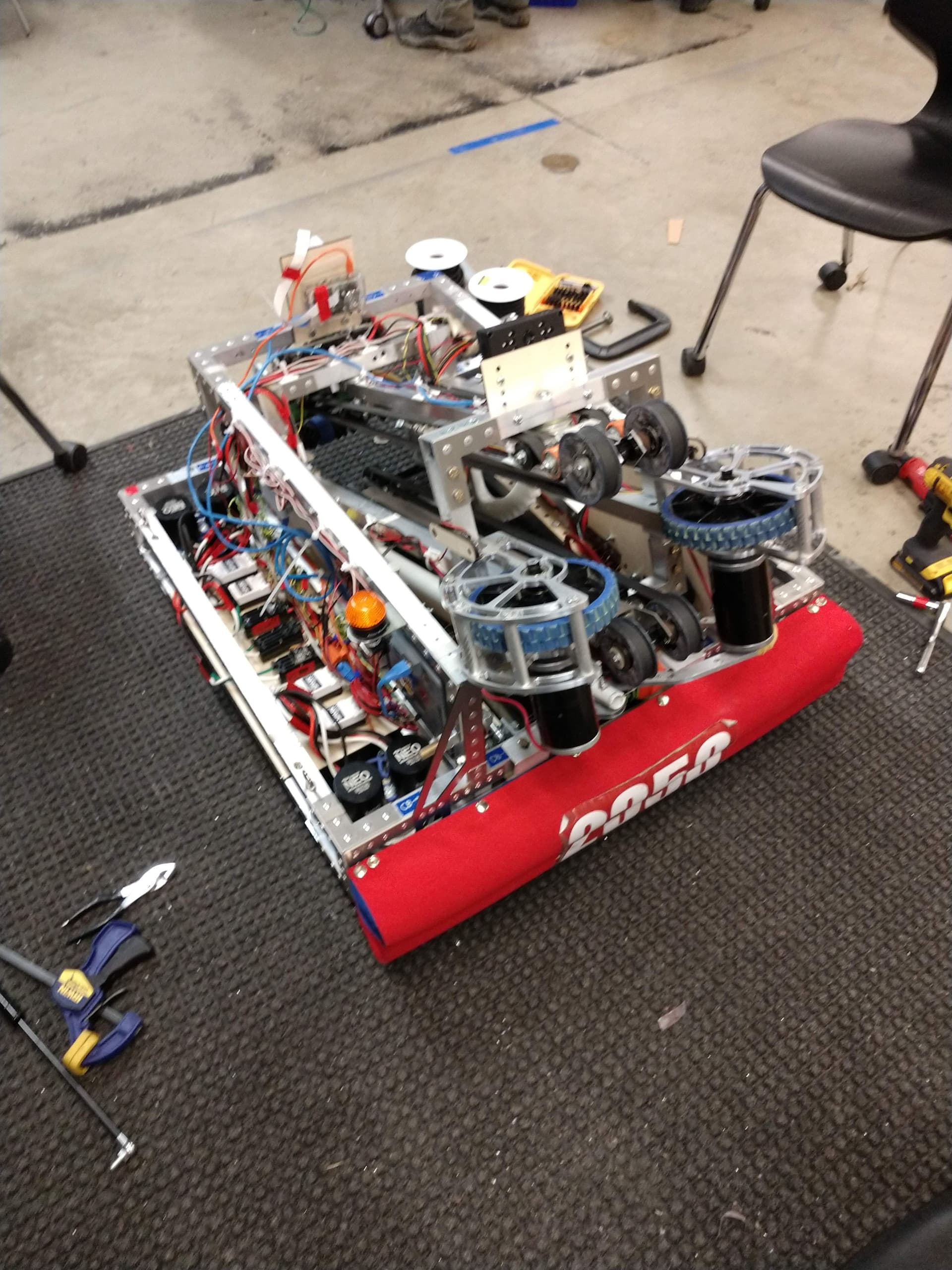

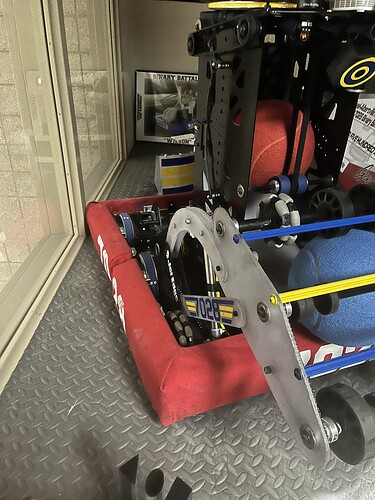

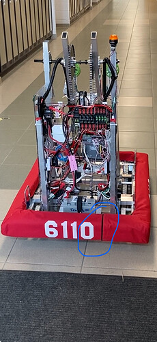

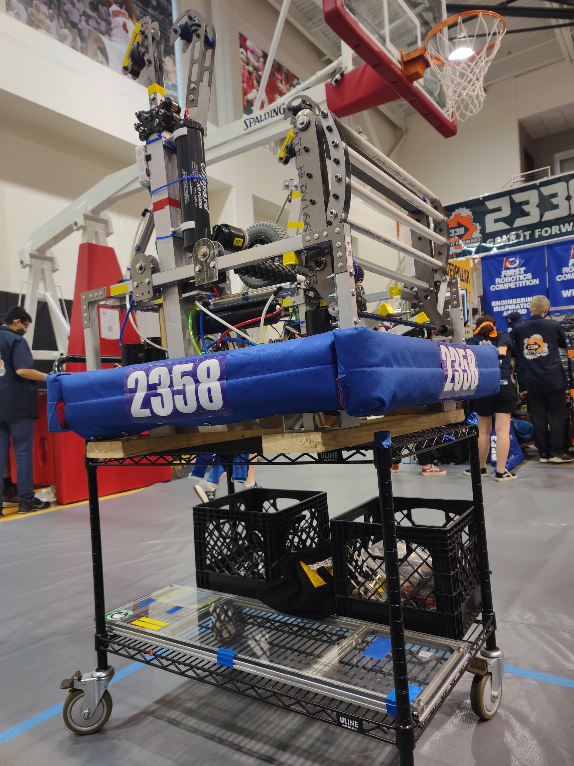

What my team does is we have 2 bumpers, front and back that border together.
Example: my team’s robot from rapid react
Don’t do a full square. It’ll be a PITA. Do two U-shaped or 4 corners. Just leave very little gap.

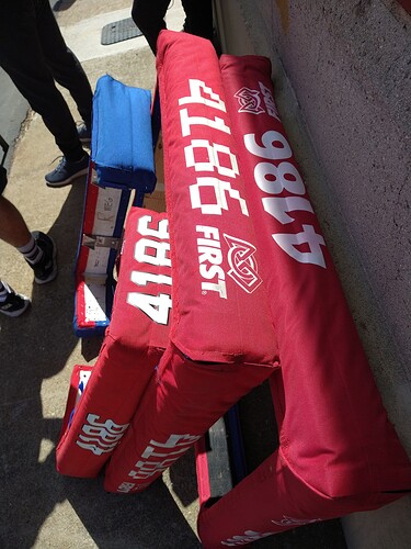

We’ve done reversible for years and won’t go back. We do 4 straight sections, one for each face. Makes them easy to flip in about 30 seconds.
I would love to see a photo of yours. We are a 2nd year team and did corner bumpers last year.

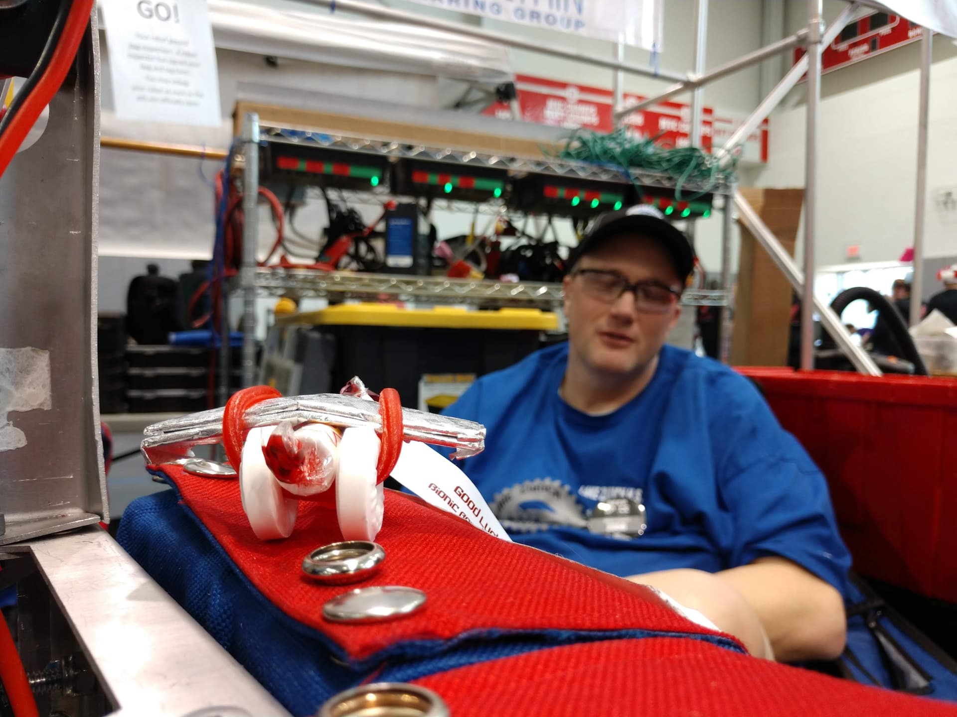

What we did is have our hook velcro on the top and bottom then on the flap we have loop velcro on the flap. To make sure we didn’t stick to the carpet we have a strip of loop velcro along the bottom when we are blue.

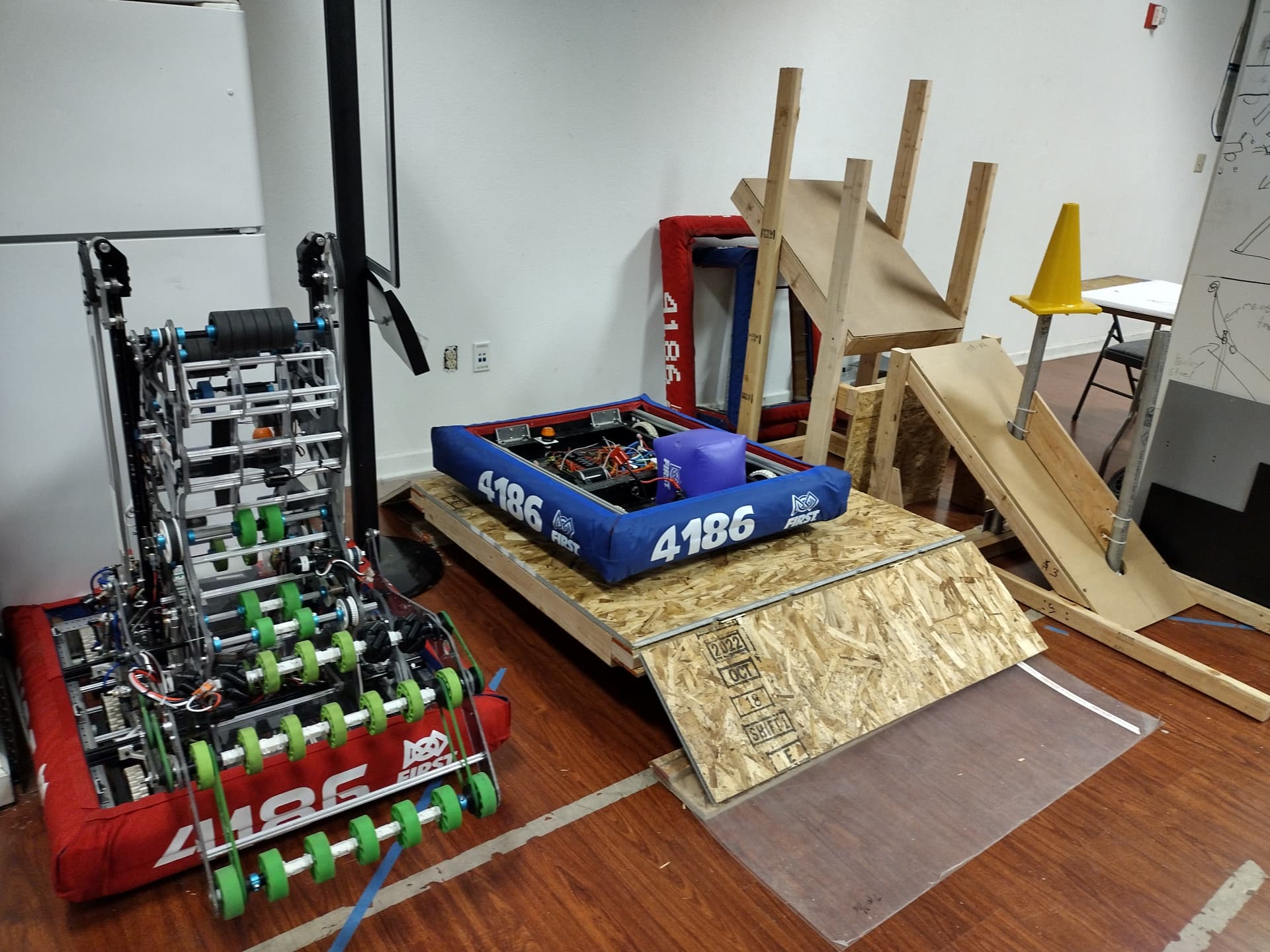

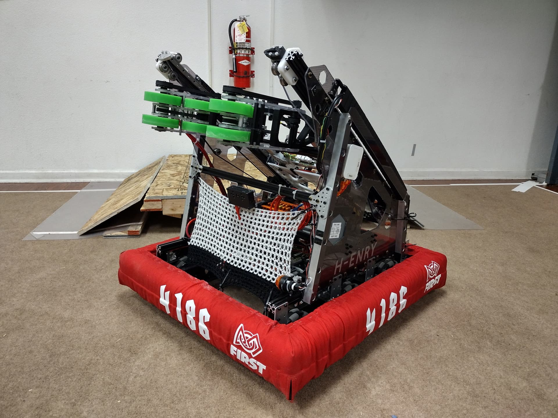

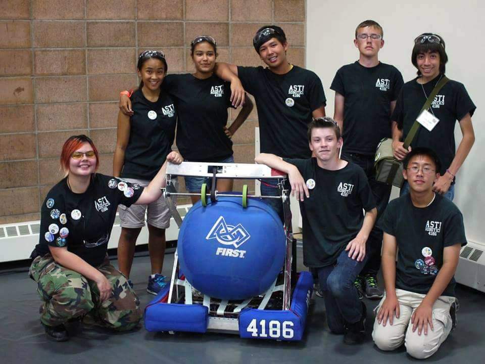

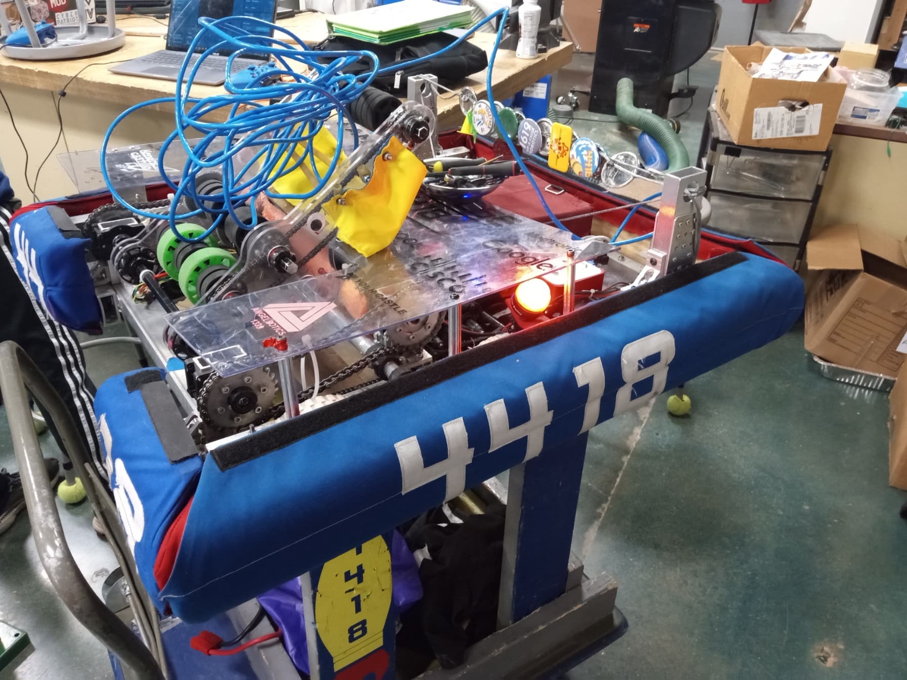

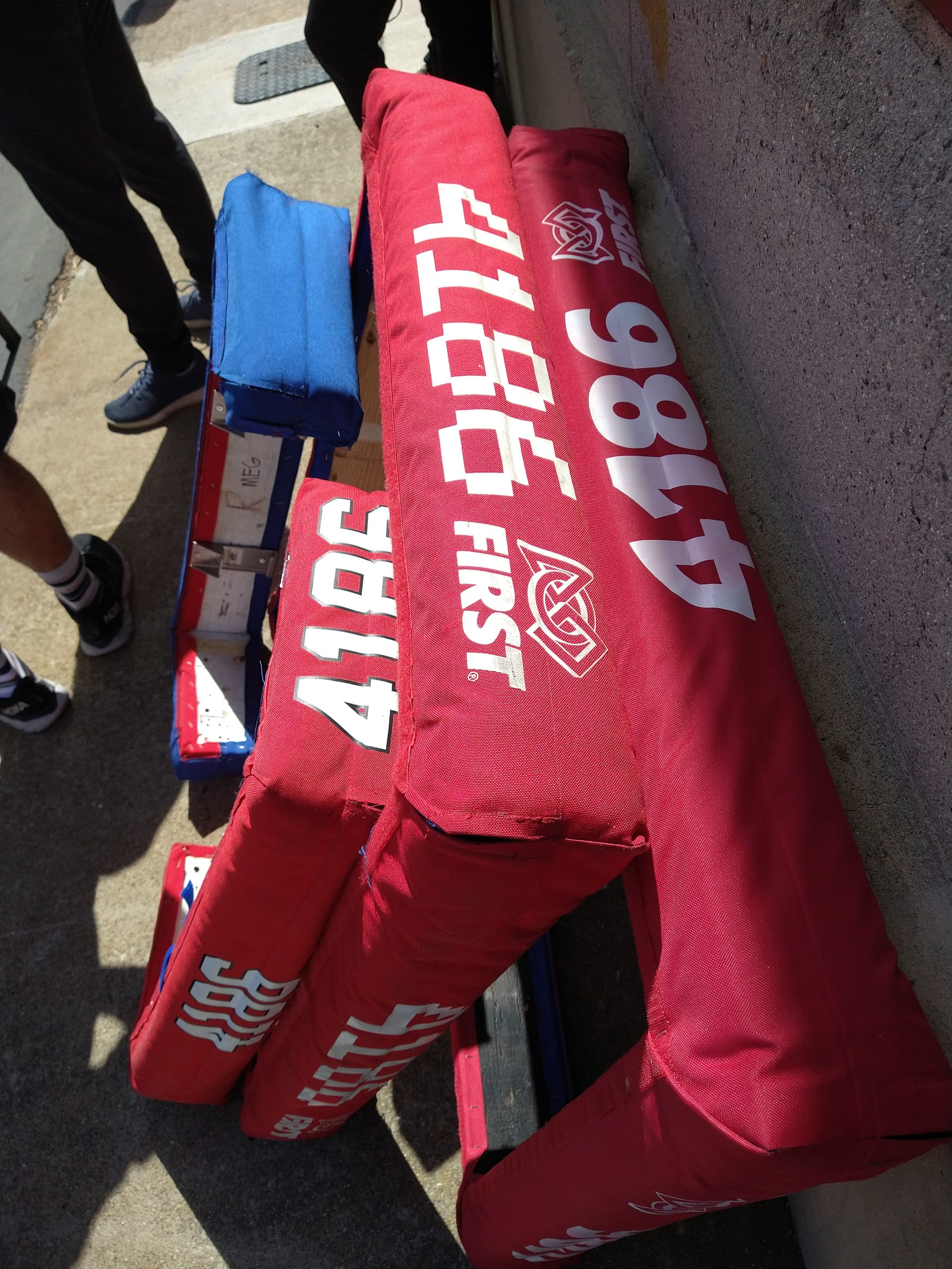

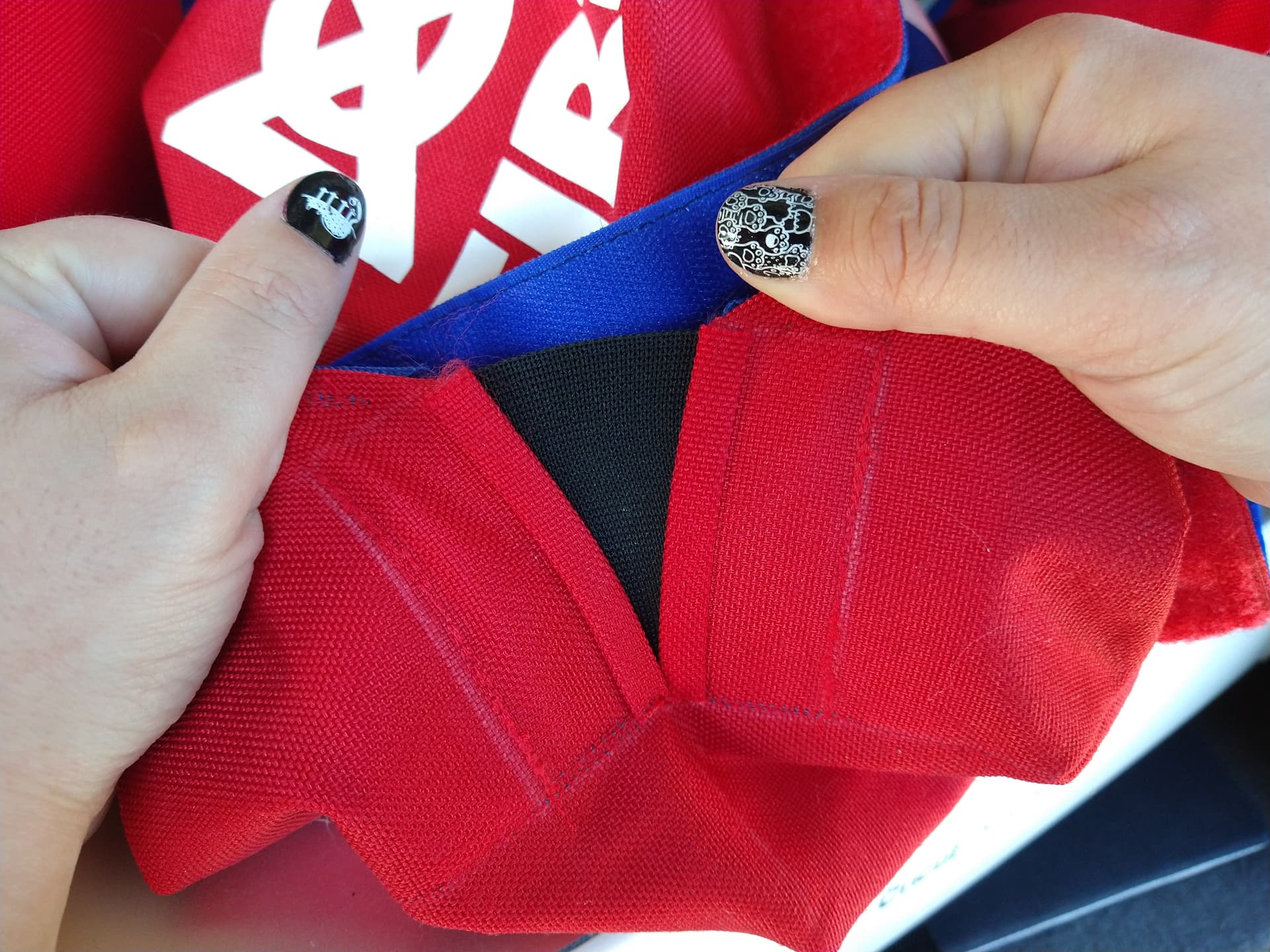

We’ve made instructions for them. I’ll see if I can get them and post them. Here are some pictures of our previous bots that kinda show the bumpers. There is a middle flap that goes up or down and snaps into place. The lower half is one color and the upper is the other. So snapping it up makes the whole bumper the bottom color and vis versa.

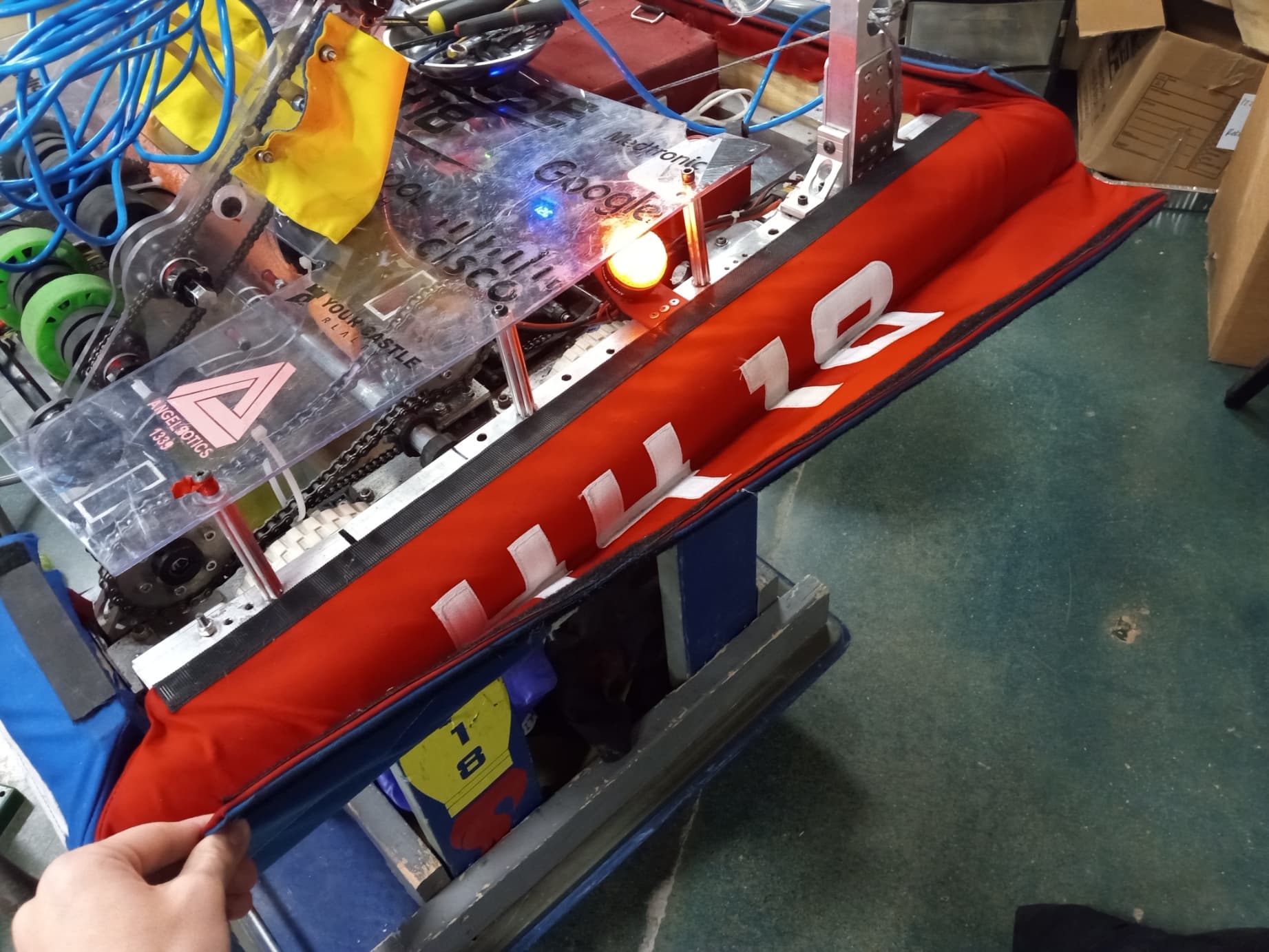

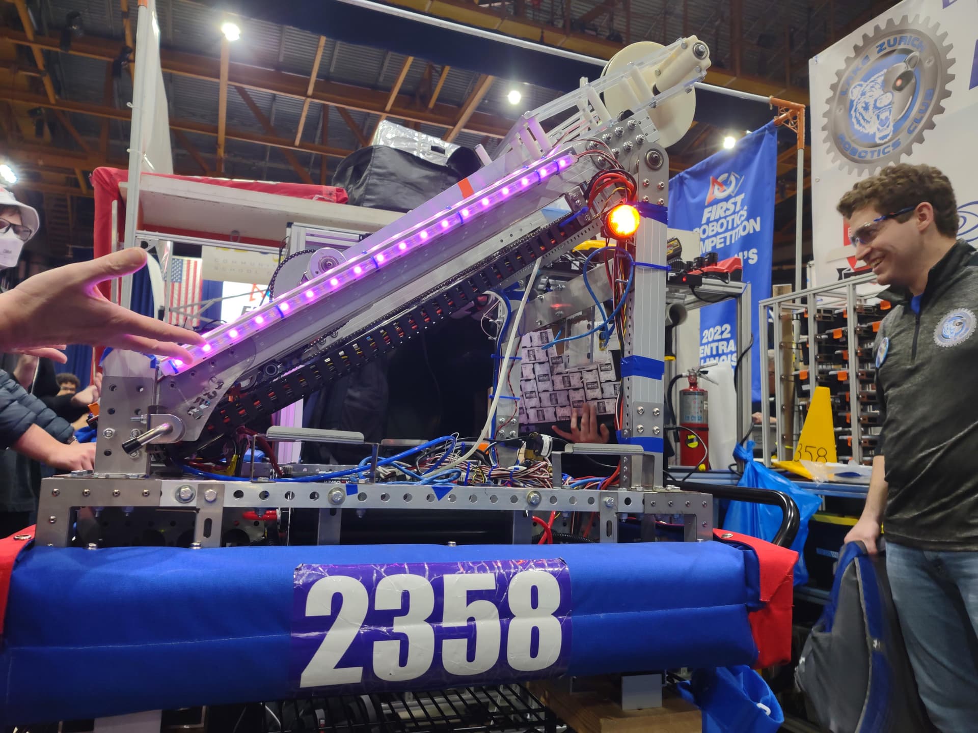

Reversible are waayyyyy better. We have our blue one as the main fabric that’s stapled then have the red fabric over it Velcro’d on.
You can see here we would just peel off the red if we were blue and vise versa.

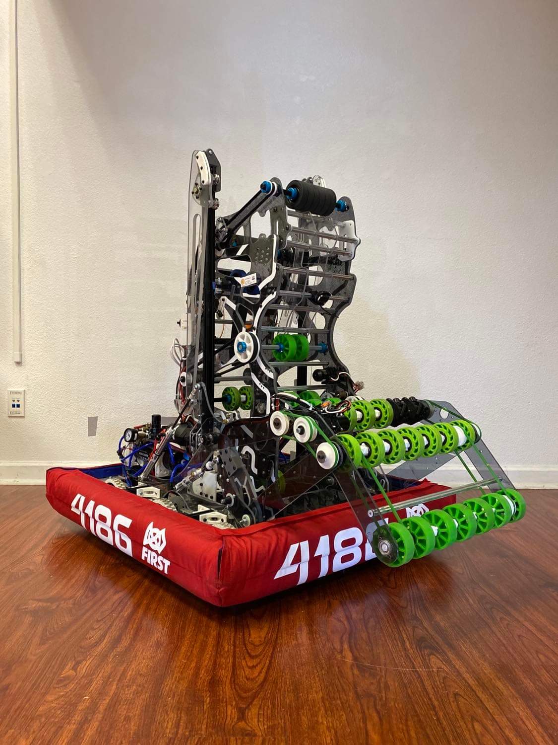

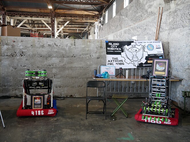

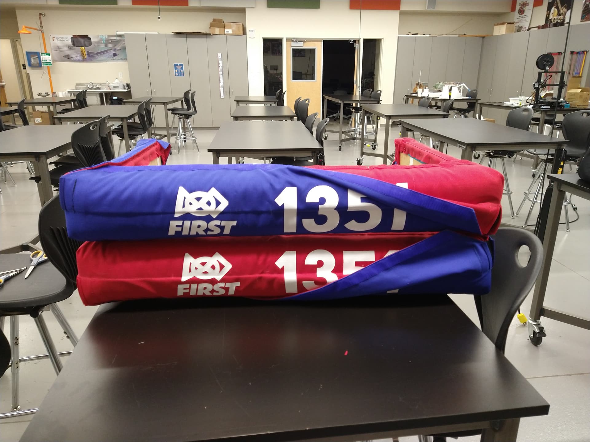

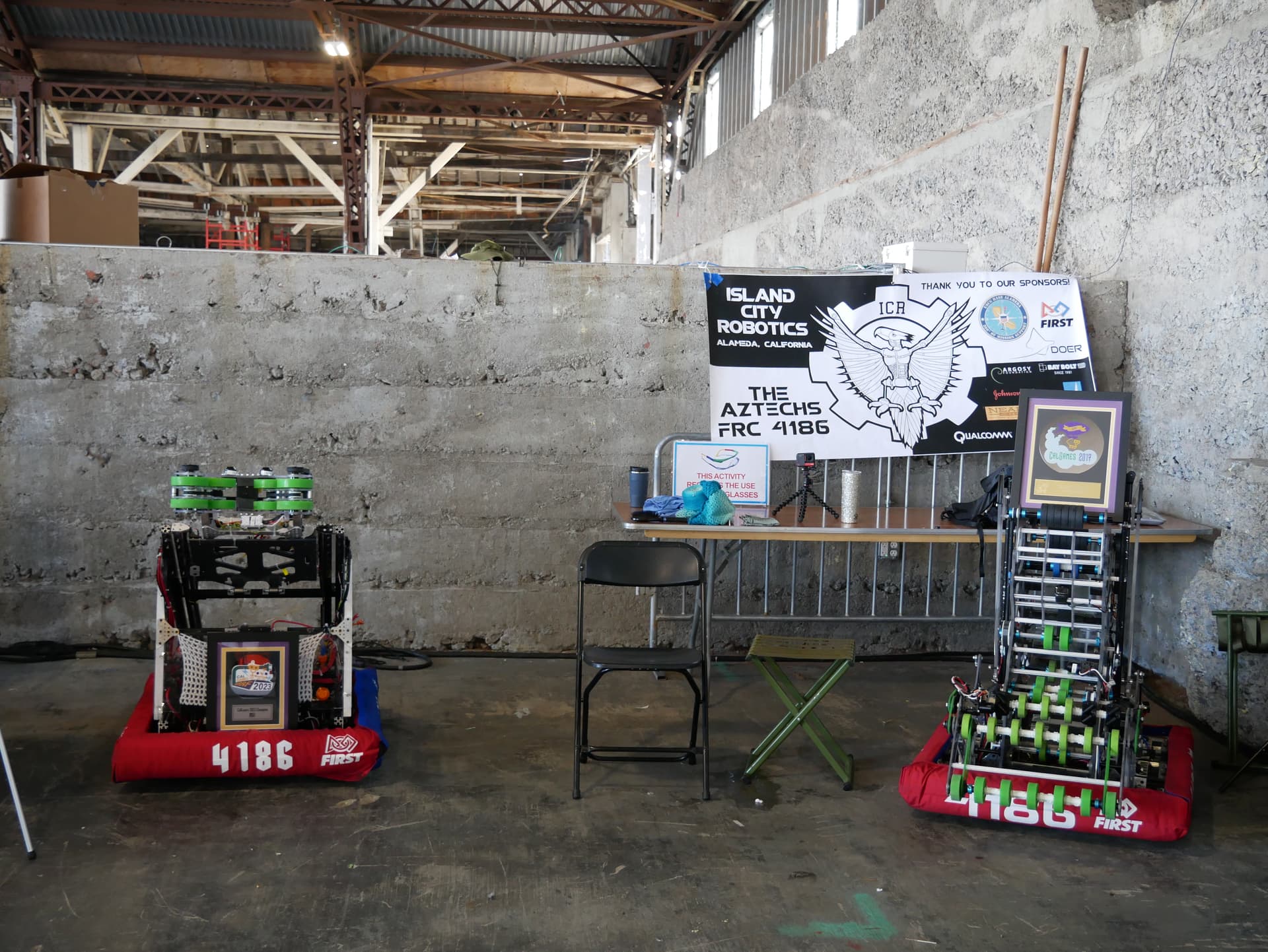

My team, 4186, has used reversibles since 2013. We also taught 1351 our method the years I worked with them, I don’t think they still do it though.

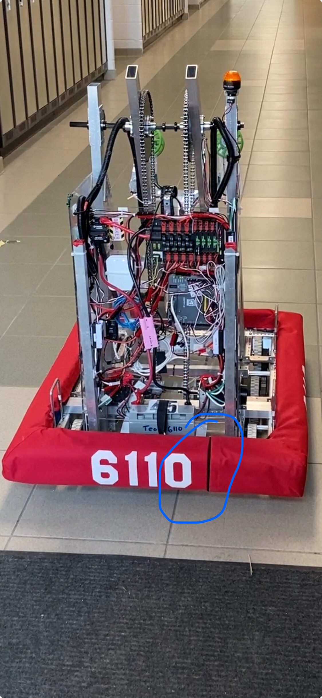

We do full perimeter bumpers the last few years, though we have done U shaped bumpers in the past. We find the full bumpers easier for us to implement with our method of doing them. We use super wide elastic in the corners to keep everything right and tight, and it also helps with the floppy flap problem… We lost a match our first year doing reversibles because a flap came detached and we swore NEVER AGAIN and that we would perfect them if it killed us :stuck_out_tongue:
We’ve been meaning to release a guide for years, we’ve been very happy with the latest version of the design and get tons of compliments from inspectors, judges, and other teams, AND we don’t ever have to worry about what color we are. It’s great! It takes a lot of stress off of the pit crew.
Hopefully you can kinda see how we construct them, and if anyone has questions I am totally happy to try and answer!
Here’s some photos:
