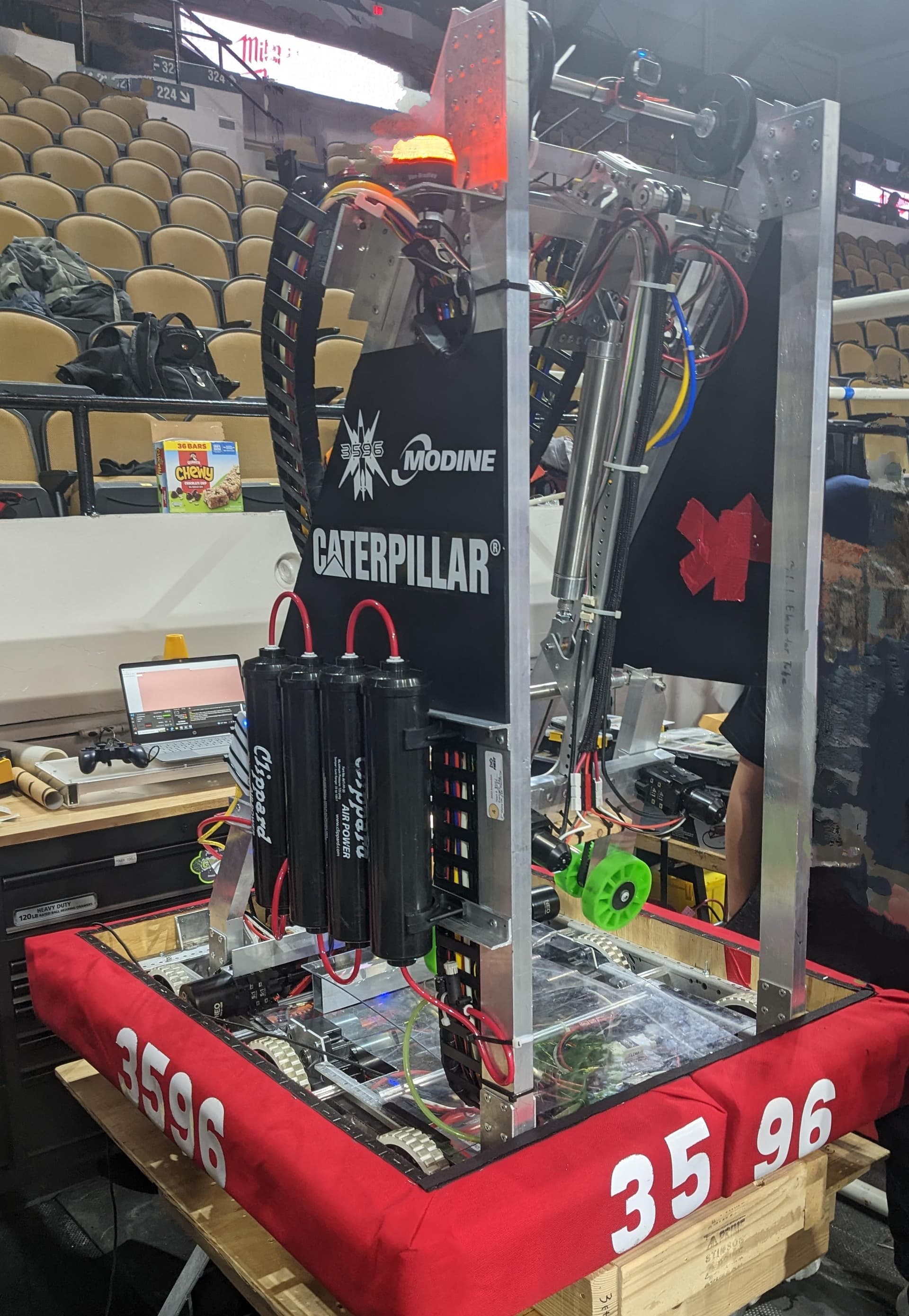

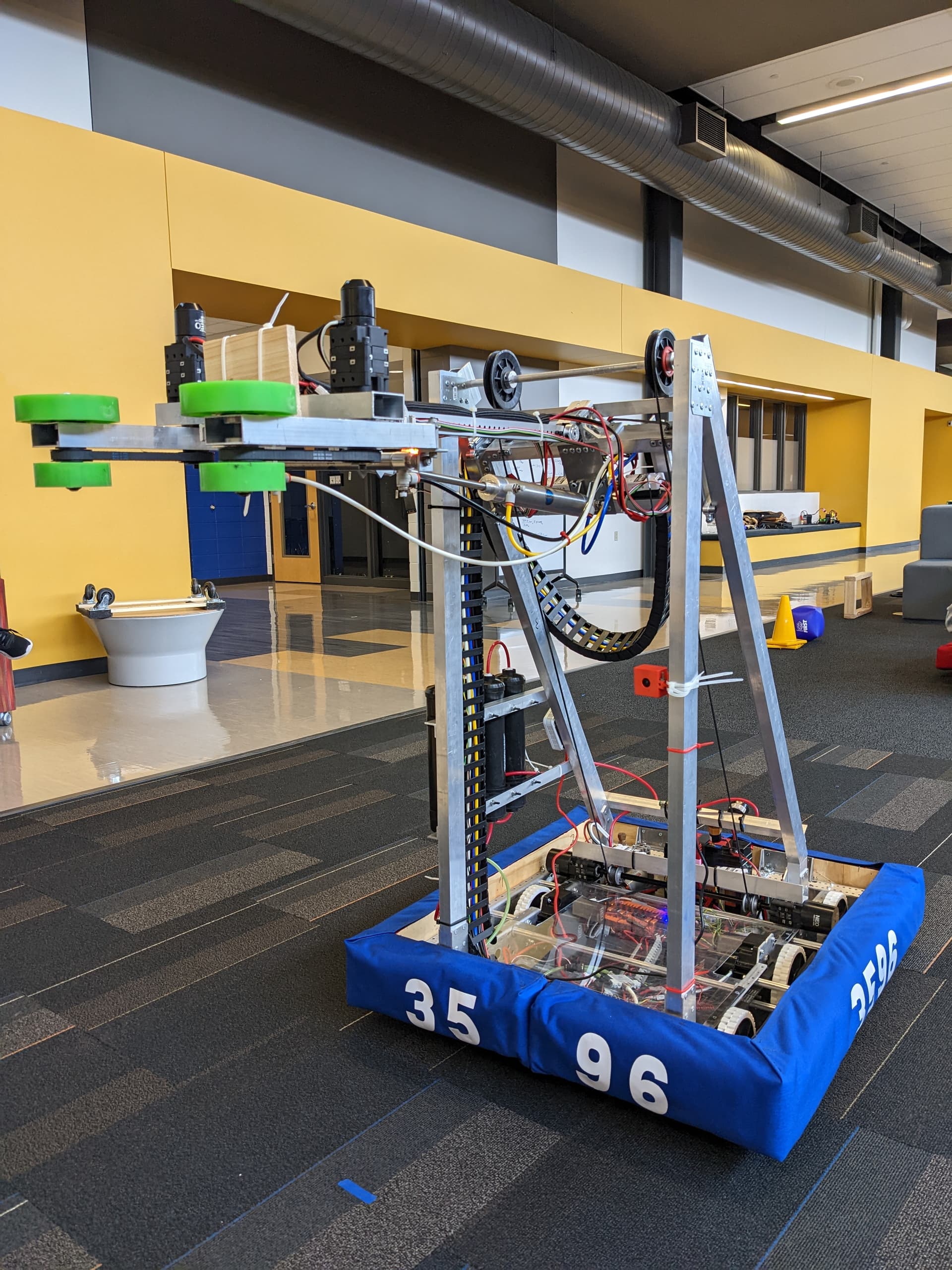

OMG I thought the 2022 bot was ours for a sec.

We had 4 bumper pieces and they were reversible.
