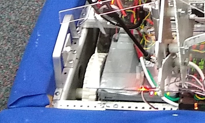

We have decided to go full bumpers this year (all around, no gaps, Everybot style). But we are not sure whether we should go a single bumper and have a cover go on and off, or 2 bumpers swapping the entirety per need. I (personally) dont see an easy way of putting the cover on as easy as bumpers with gaps. I feel like they would be more prone to being ripped off. Not to mention, we are planning on using some slickier material?
If any team has had experience with this, please tell me what you’ve learned.

We’ve used a similar design bumper most years, which is 4 full length pieces. Each has two 5/16" bolts sticking out, from the inside. The bolts we use are “fanged elevator bolts”, look them up on McMaster-Carr. We build some type of bracket that is attached to the top of the robot frame, and the bolts go through the brackets. A nut at each end of each bumper holds them on, they are relatively easy to change, usually takes a couple students a couple minutes.

Two sets. If your bumpers go all the way around, all you need to do to secure it after lowering the bumpers into place is put in about four wing nuts or bolts from the top roughly equally spaced around the perimeter.

We us a post and R clip system for mounting. Very simple, robust, and fast to change. 4 clips per bumper section, 1 Pit Crew member can swap them easily in under a minute.
