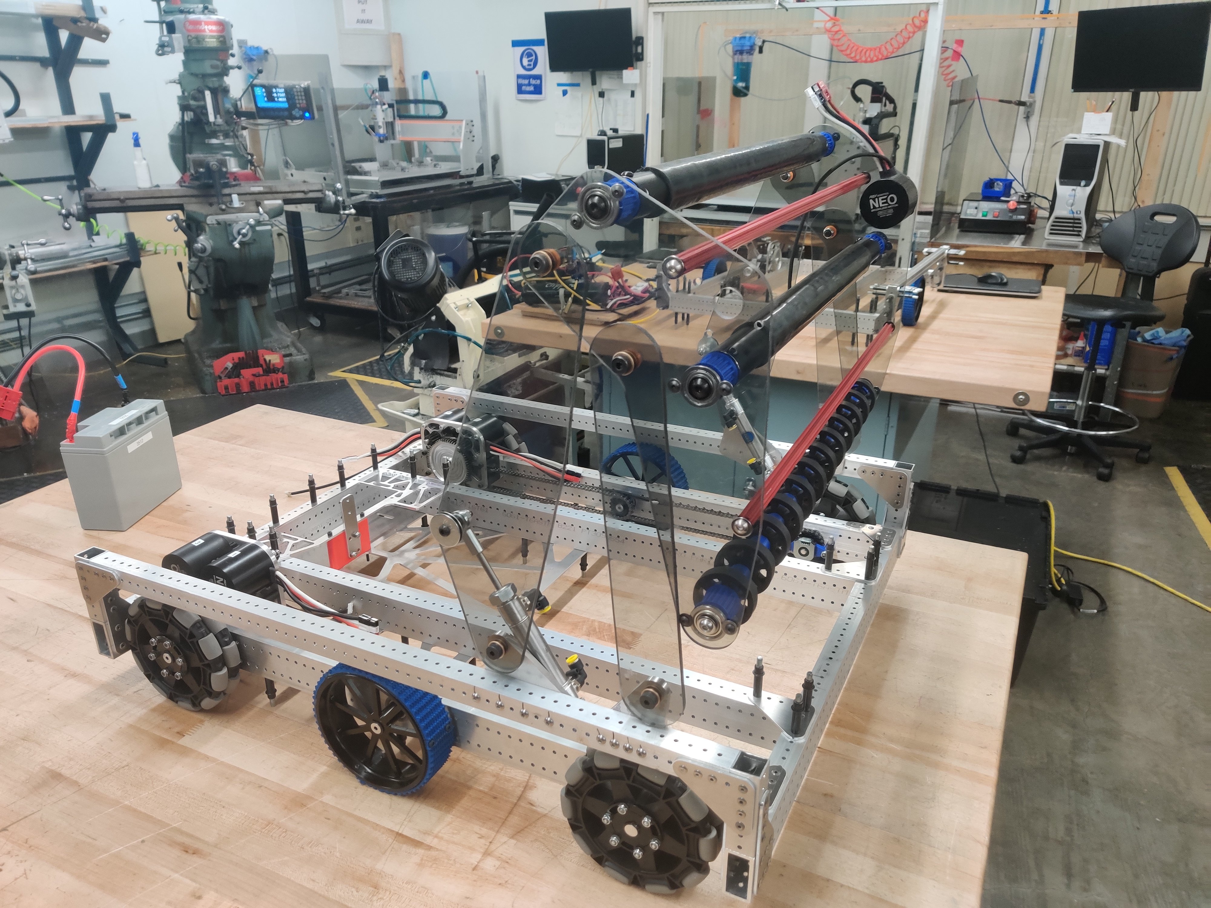

We used them on the pivots of our 4-bar mechanism a few years ago.
After the 2022 season, we’ll never make a pivot on an FRC robot without a bushing again. They are cheap, come in a variety of sizes, and work great.

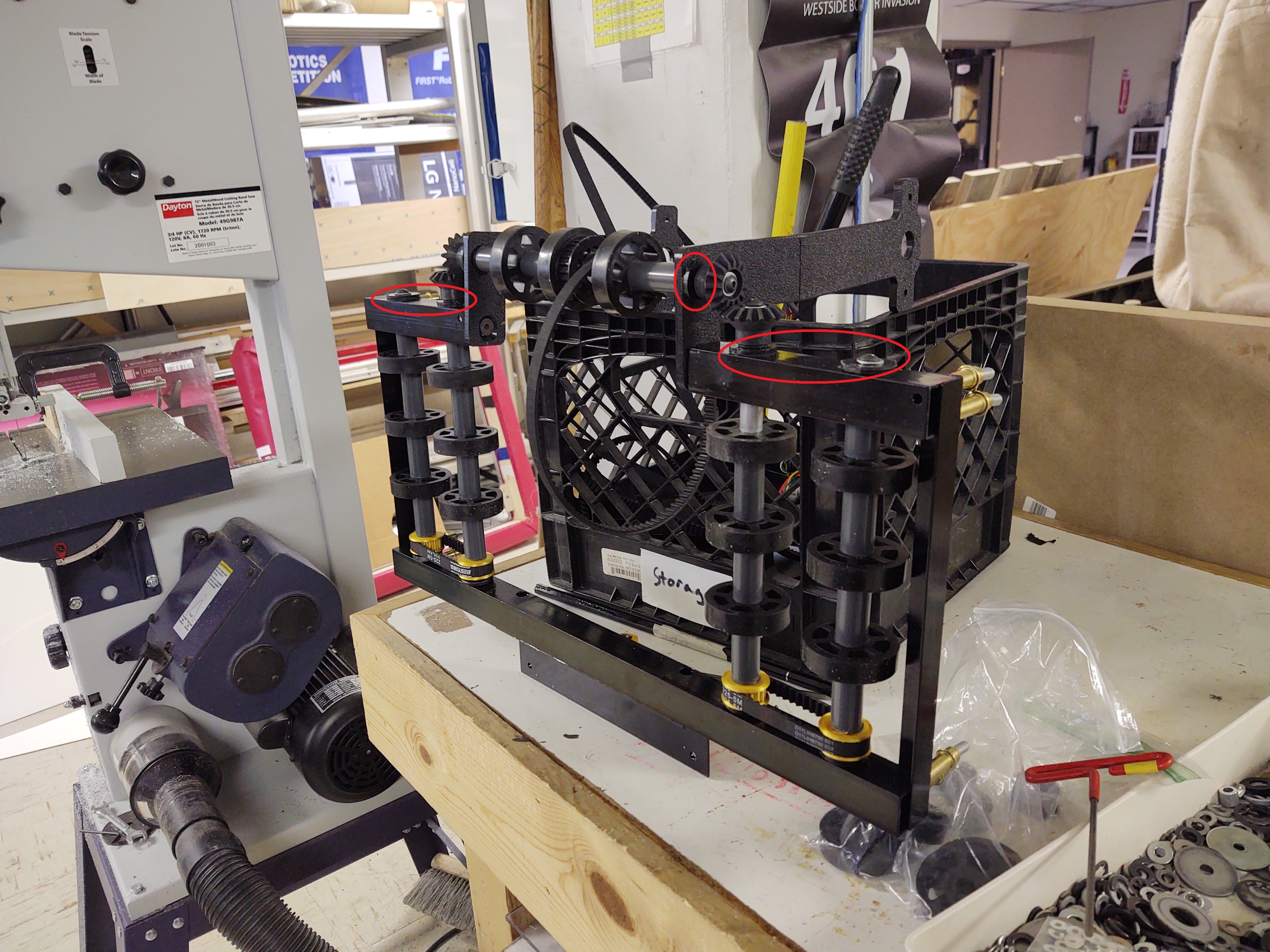

We used oil embedded bushings in 3 ways:

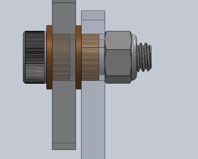

What’s the best way to keep them from falling out?
I’m starting to incorporate more bushings into my designs. Typically we throw bearings everywhere, but I know that 50% of the time it’s not necessary
Probably similar to the methods in this thread.

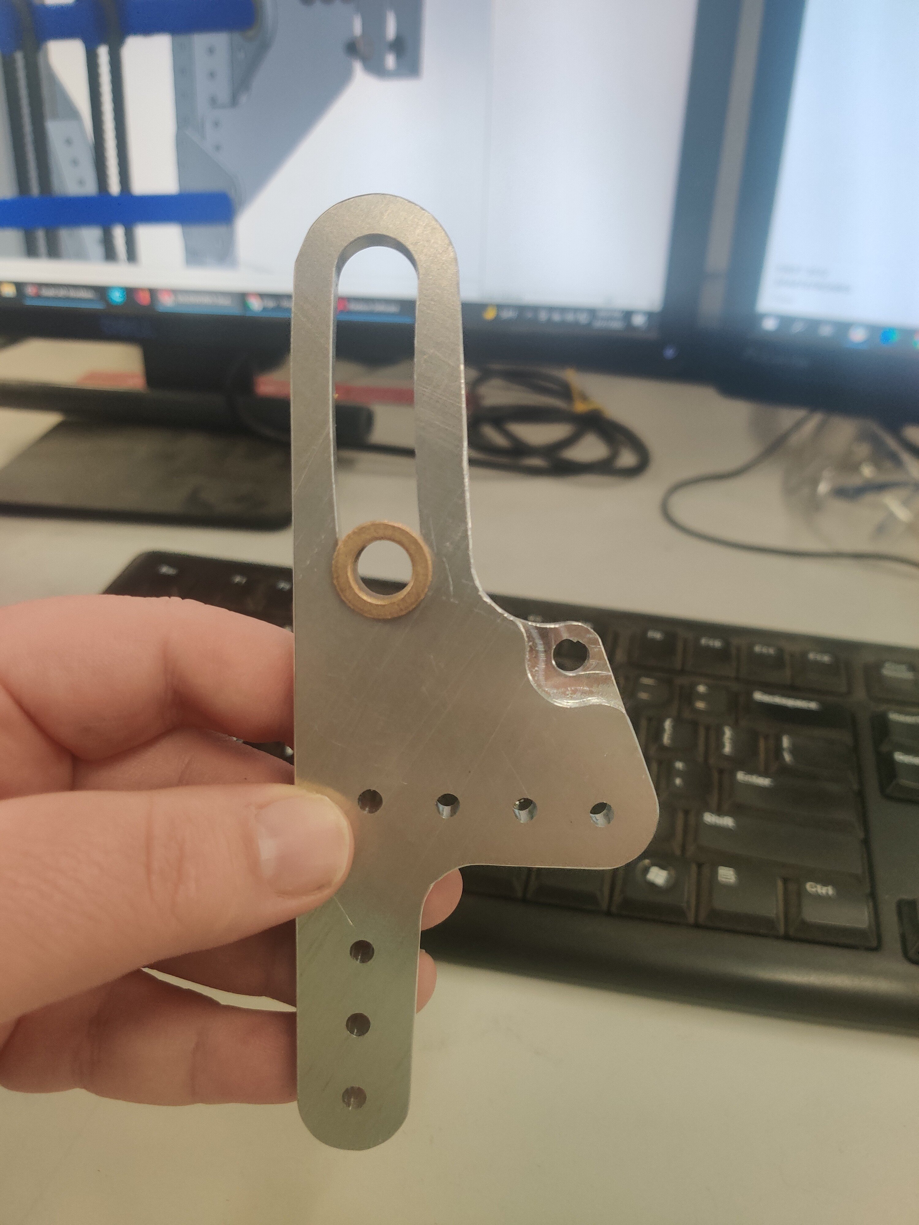

Here’s the stack up of components for the intake pivots which used flanged bushings:

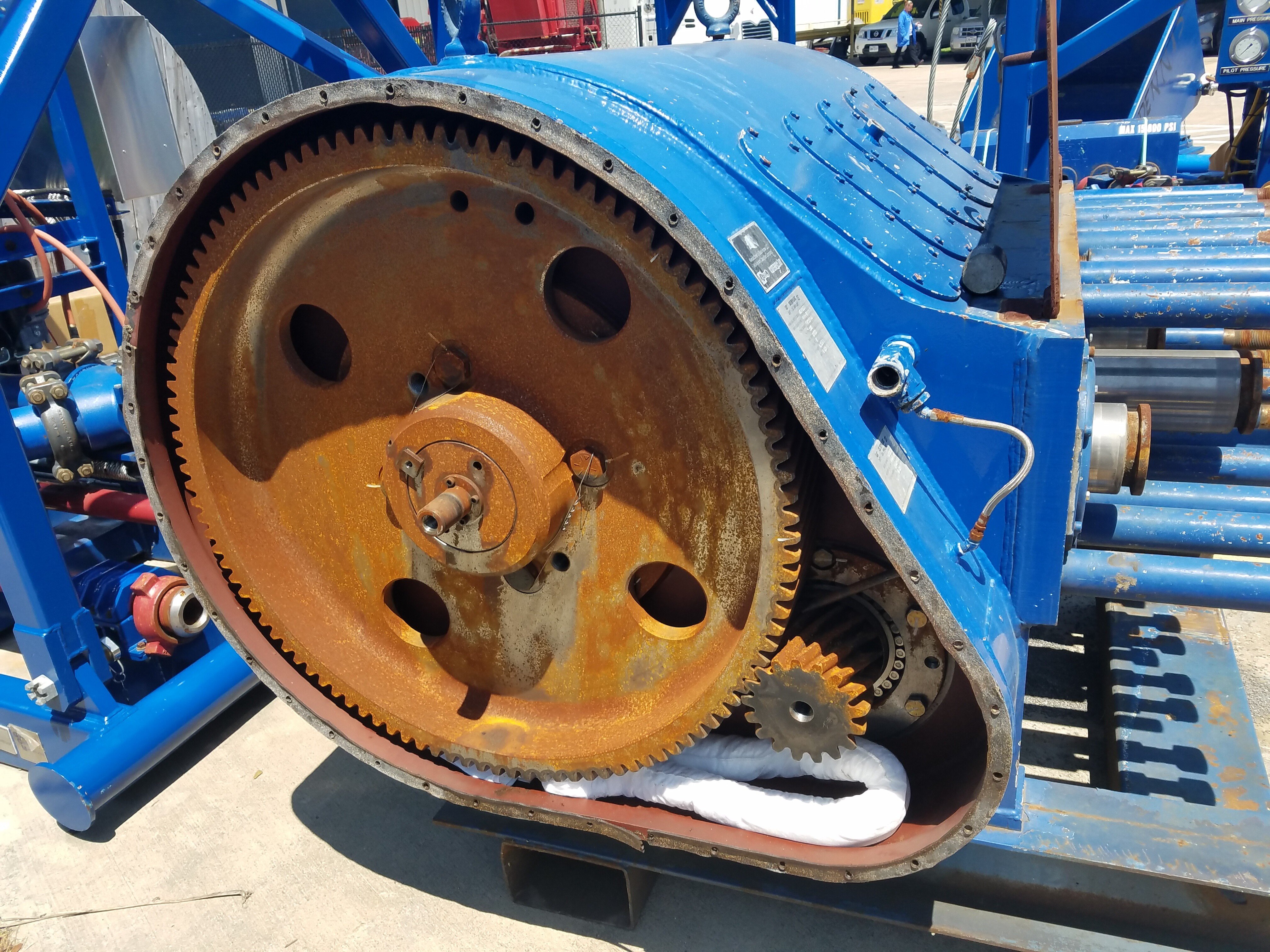

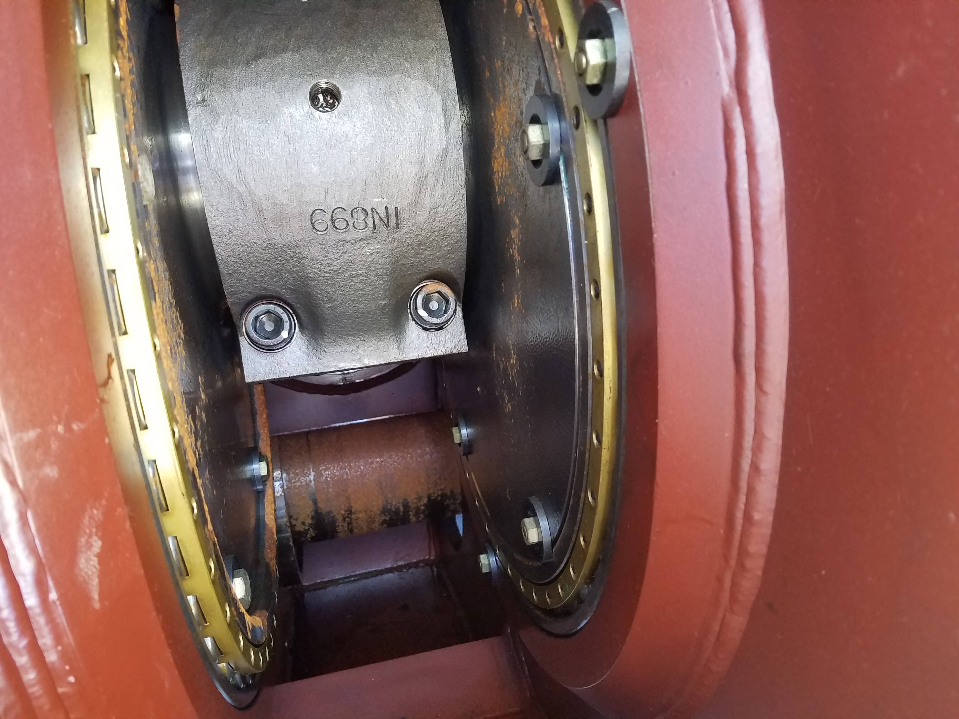

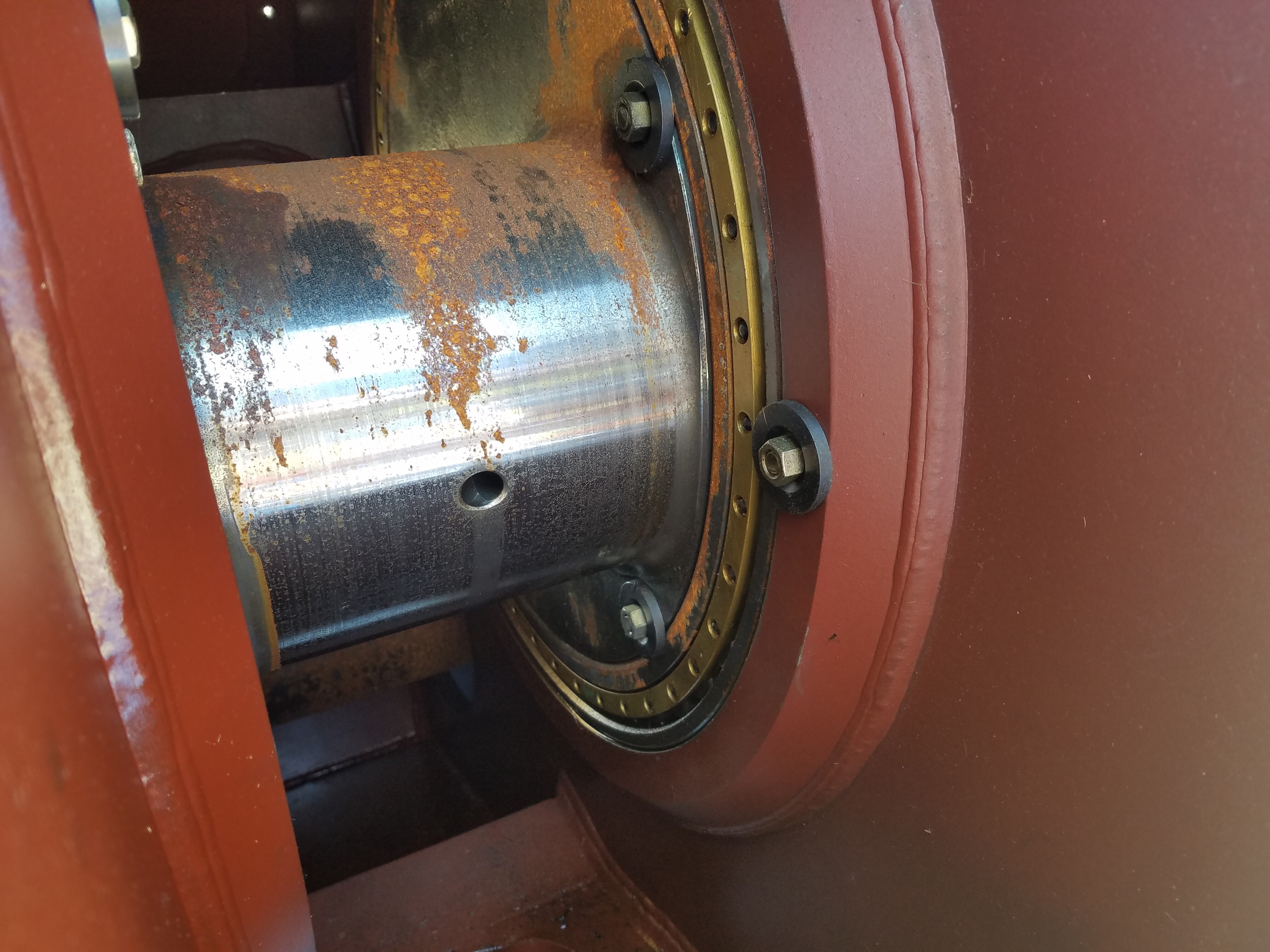

Now I want to find one of my pictures of a 80,000-100,0000 pound capacity bushing :wink:
Fraction pump bearings and gears, enhanced with extra rust…
That is fed with oil pressure, wouldn’t that technically be a fluid bearing?
Stop being so technical, Mark. Oh, wait …
