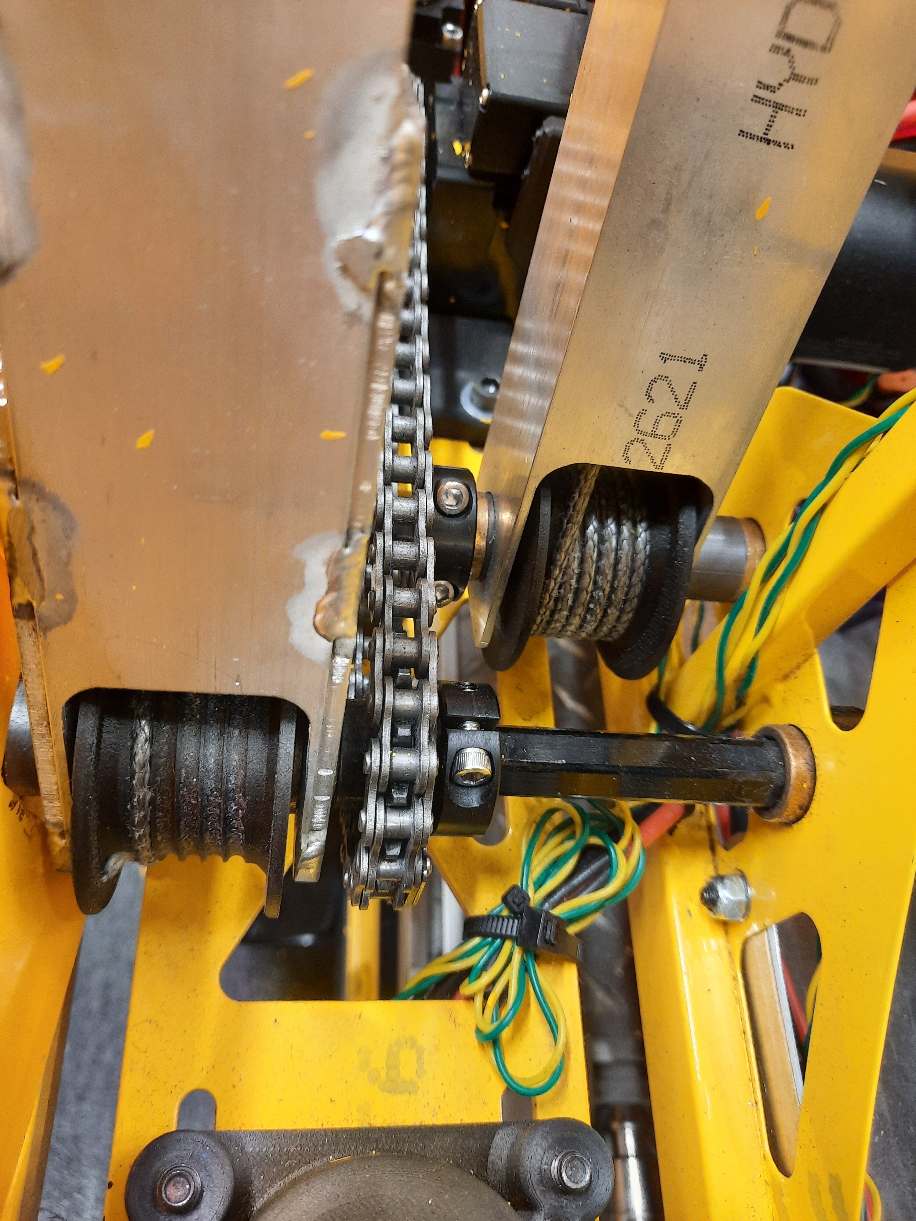

Our ball elevator used thrifty bushings for almost all of our thunderhex shafts. And we also used them for our 4 bar intake for the pivots that allow it to move. (Not motor driven shaft)
We have been very very happy with how simple and well they worked. We probably saved over 1lb by using them strategically in our design.
How did you know?!
Here’s where Cory is talking about:
My understanding is bushings are great for high loads because of the large surface area however thunderhex limits said area to 3 blunt points sooo…
This is an issue even with the bearing except the 3 blunt points aren’t sliding
