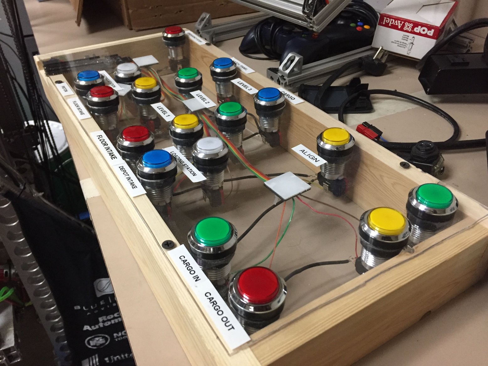

  1. We used a PSoC 5LP from FIRST Choice and some buttons from Amazon. Then made the housing with 1/16" polycarb and wood pieces.
  2. As difficult as any off-the-shelf joystick
  3. No, you read it like any other joystick, each pin on the PSoC corresponds to a button or axis

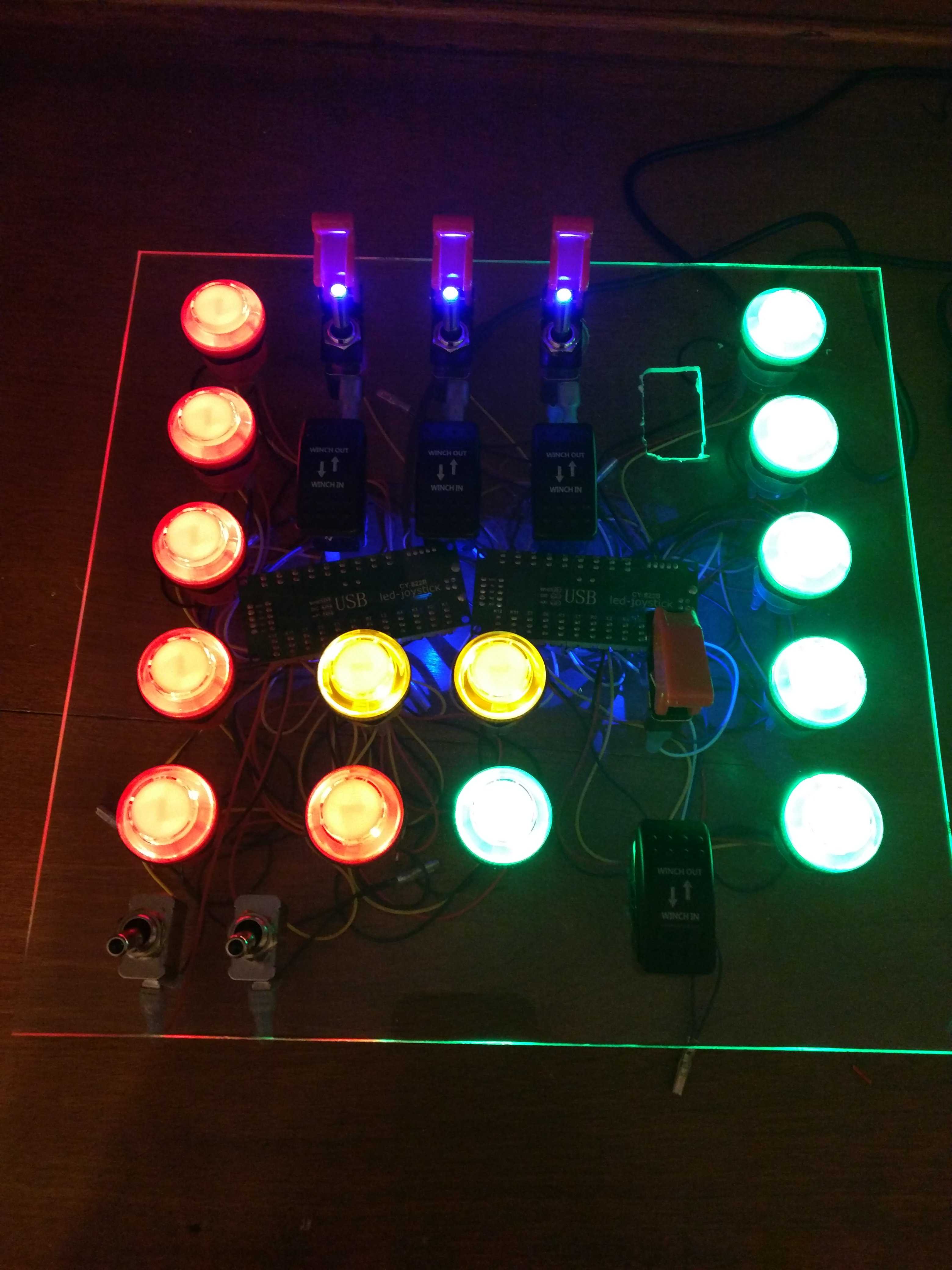

We had a lot of teams walk past our pit and backpedal and ask us questions when they saw our button panel all lit up on our driver station.
I’ve procured the parts for our button panel the past few years. The main components the past few years have been from Amazon, but as others have mentioned, Digi-Key, Sparkfun are also reputable vendors to look at.
The EasyGet USB arcade controllers are very easy to use and we like them because the students need to have EVERYTHING LED, which this controller supports. The controller is able to power light up micro-switches and run a signal back to the controller with one connector. The connectors are solid on both ends and we haven’t had any issues with loose wiring (quite the opposite actually when you miswire something). If you want to connect the leads to other switches with larger blades, you may need to get spade connectors that you can crimp on the ends. We used a powered USB hub to prevent over-current issues on the laptop (and to save on repeated insertions to the laptop ports)
The controllers support connecting up to 12 buttons, plus 4 more if you get creative by re-purposing the analog X and Y axis inputs for the traditional stick controls. We used 2 controllers and maxed out both of them with push buttons, switches and momentary rocker switches
According to our programmers - not difficult at all. Because we use two joysticks for driving, when you plug in these USB controllers, they appear in Windows as two more joysticks. The programmers were able to easily map functions to each button press as they normally did for the driver joysticks. The Driver Station software recognizes them as Generic USB Joystick and it is easy to troubleshoot and diagnose button press issues.
Nope, see above. We actually wanted to add a few more smarts to the panel by adding an Arduino and some digital relays to control the +5V to the LEDs to control them to be either ON, OFF, or FLASHING. This would indicate to the operator when certain operations could be performed, but we had to scale back the idea to “get it working first, then make it better”.
Rest of the build is just polycarb on a frame that we re-use every year. Dimensions are roughly 1’ x 1’ which can make spacing difficult, but definitely plan ahead before you cut & drill.

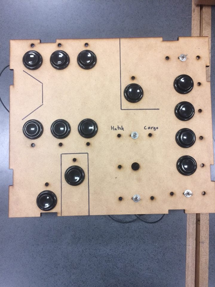

Unfortunately I don’t have any great pictures of our operator control box in it’s finished state, but here’s some that are pretty close to finished.
Video
We’re not using a kit per-se. The buttons are all SparkFun Arcade buttons which have a fantastic clicky feel and have proven to be dead simple to mount and incredibly robust. The Switches are toggle switches from Digikey along with a single covered toggle switch. We have a ton of standard 5mm red LEDs for feedback (with 100 Ω current limiting resistors).
All of this is controlled by an Arduino Due using the Arduino Joystick Library. I used a screw terminal prototyping shield for the Arduino to make it easier to re-use the buttons later. For maximum redundancy and protection against failures, each button and switch has it’s own independent ground and sense/power pin. That way a single wire coming loose will affect only a single element of the device. This made wiring a terrible pain, though.
The box is laser cut MDF with custom sharpie accents until such a time we manage to design and print a label sheet.
Super simple. The Arduino shows up as a standard joystick with the buttons you’ve specified. In our case we have a gamepad that has 22 buttons and no axes. As a safeguard, we added some code that ensures each toggle switch is reporting only one direction at a time and the code goes into a failure mode if this assertion fails.
Nope, if you can map a standard joystick, you can map a custom box.
If you would like our code for the box, feel free to PM me. It’s currently mixed in to our main robot source repo, which we will release after the season ends.
