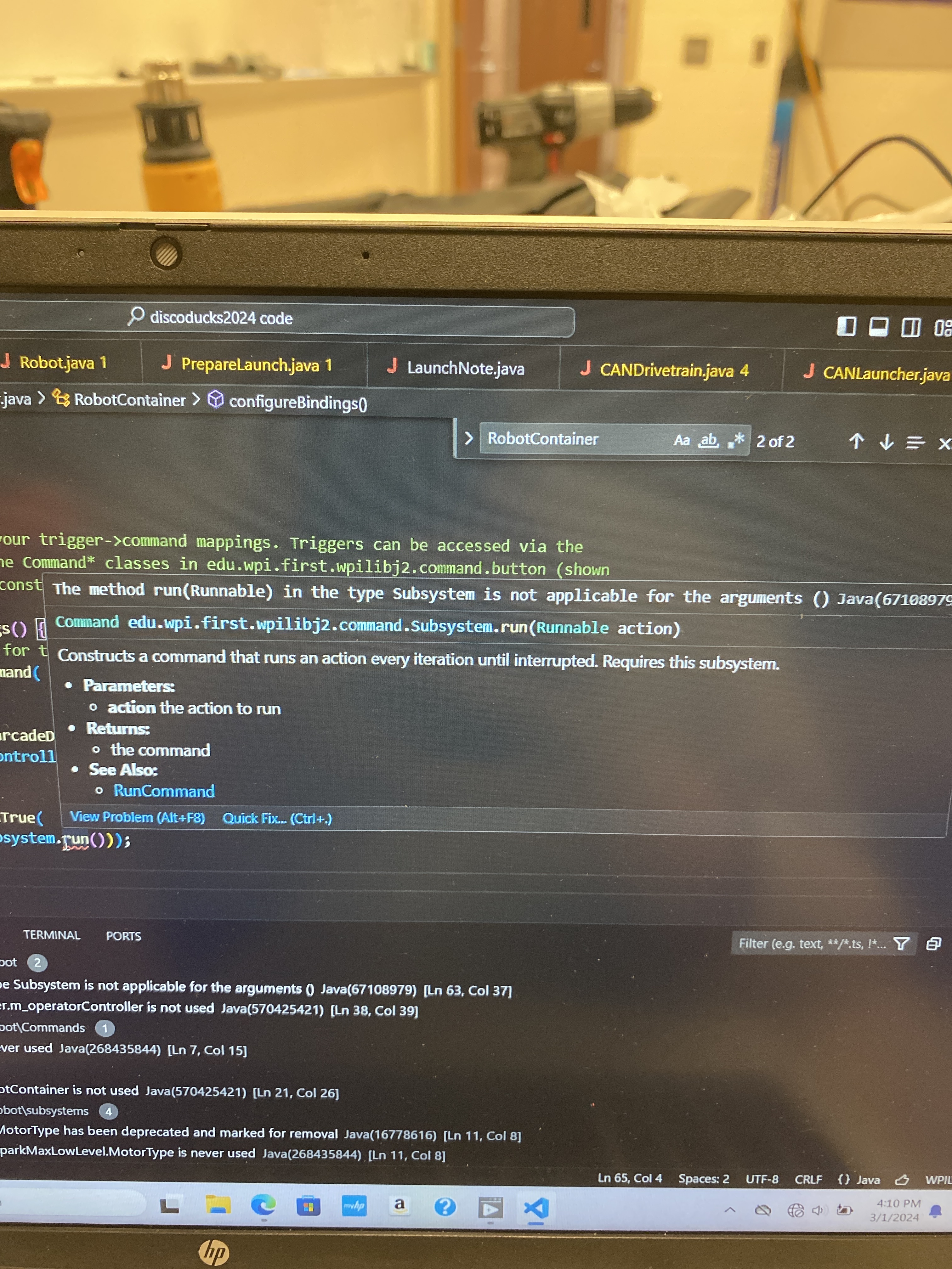

We are trying to use the code provided but when we get to the run at the very end in robot container it’s telling us that it dosent exist in robot container. If you could help us fix this it would be amazing
I believe that was a typo, and the line should be
m_subsystem.runOnce(m_subsystem.run()));
This is what it’s telling me now
Sorry about that, bad method name on my part. run() is a method to run a runnable action and that is what is happening here. Replace that with whatever your method is called.
