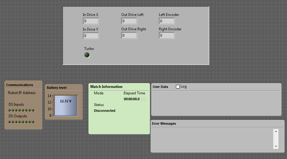

In the Dashboard directory, the DashboardMain.vi file is a stripped down version of the dashboard that we used this year, which was based on the dashboard example provided with Labview. I included a few supporting VI files that came from the example that handle the communication protocols.

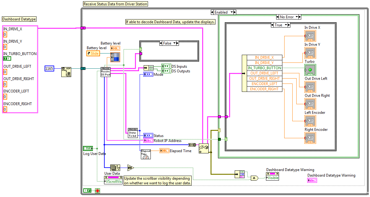

On the LabView side of things, we simply took the example and stripped out their processing and added our own. The key to the whole process is the packet parsing which is done via the data structure on the far left. The order that the data is packed on the C++ side must match the order that the elements are in the LabView data container. Once the data packet format is set up, it’s as easy as adding the necessary processing on the right side of the diagram. You can make it as simple or complex as you’d like.
Hopefully this will give programmers that are intimidated by the dashboard a good point to jump in from.
