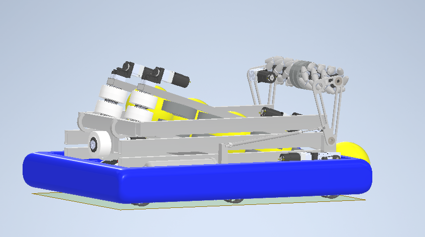

Robot Fully Compacted:

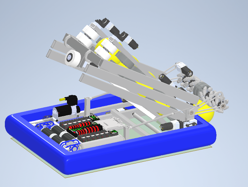

Intake Out:

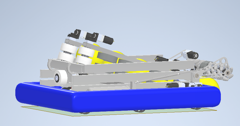

Shooter Angled For High Goal:

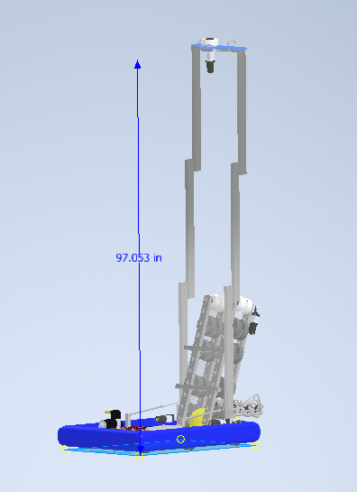

Climber Fully Extended:

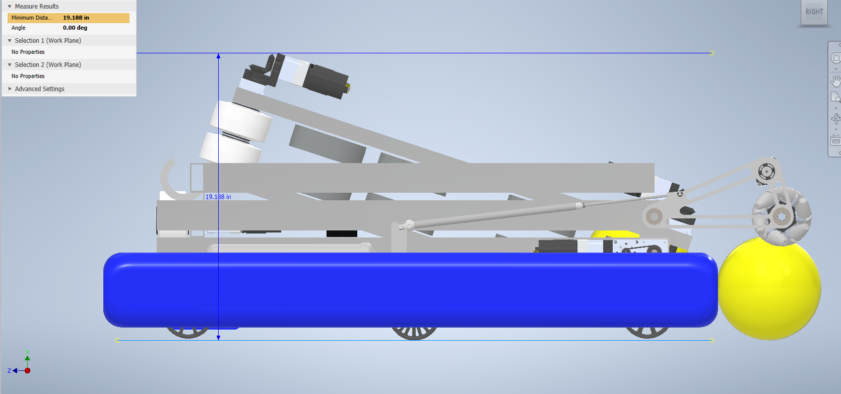

The Robot is Very Short:
