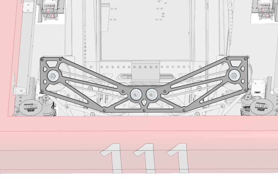

Hi everyone, I’m just here to ask a question that’s always been on my mind looking at experienced teams’ robots and how they get this cadded out either quickly or if there’s a specific rule they follow. I’ve wanted to expand my team’s cadding skills with part design but currently, we just use octagons to save weight. I may not know what it’s called, I know it’s something with topology but if someone could help that would be great.
Example (111 robot cad)

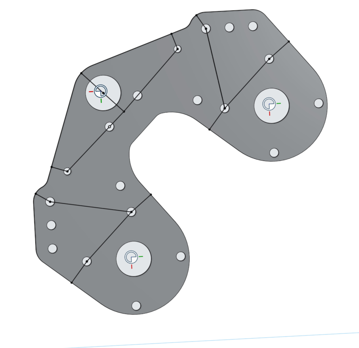

I guess I’ll use the 12 motor swerve addon I designed for an example.

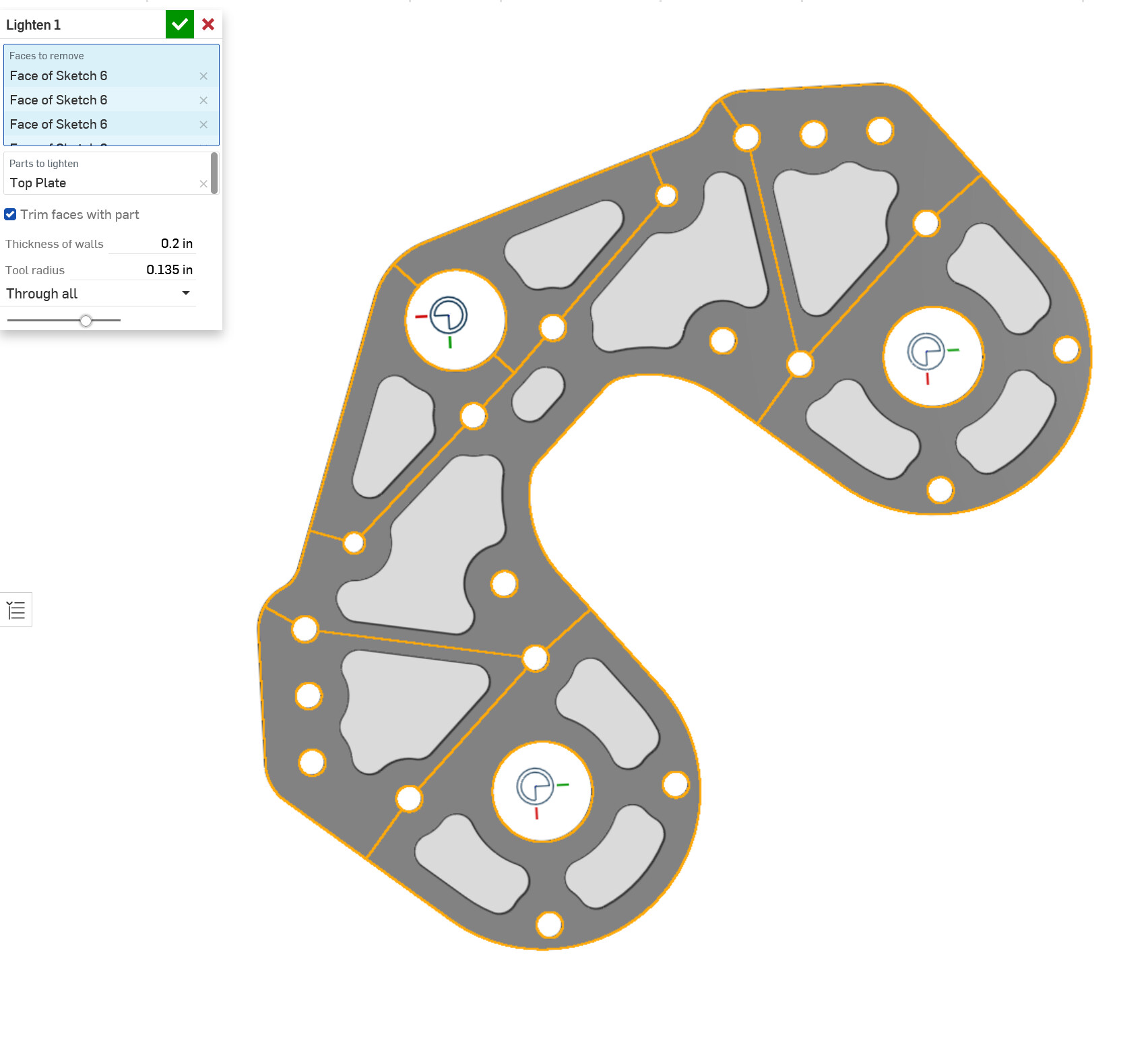

We start with the plate without any lightening, then draw lines where we need there to be aluminum to support everything.
Then, we use the lightening feature from someone? not sure who tbh. Here’s the featurescript link: Onshape. It’s also linked in Getting Started | Onshape4FRC.
That was a lot faster than I thought it was to say that, but hopefully makes sense

I really like the “Lighten” addon already mentioned. I draw lines between all critical load areas and fuss with the widths until it looks decent. You will want direct load-bearing elements between all gear, pulley, and sprocket pairs to maintain their center spacing and minimize the risk of those elements disengaging.
