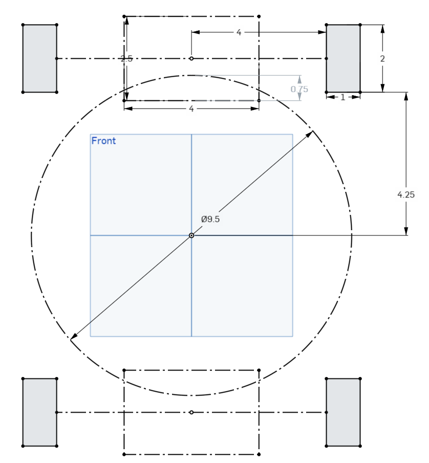

If I understand where you’re at in the process, my advice is usually “set up for where you’re going and start with what you know”. (Note I’m a Solidworks professional and have no OnShape experience, so my terms might be odd.)
Is your question just “what’s the parabolic arc generally look like from here to here?”, and all you know is the game field? Then maybe you just give yourself a 2D plane on the field CAD or a blank sketch with some reference geometry for the origin and target.

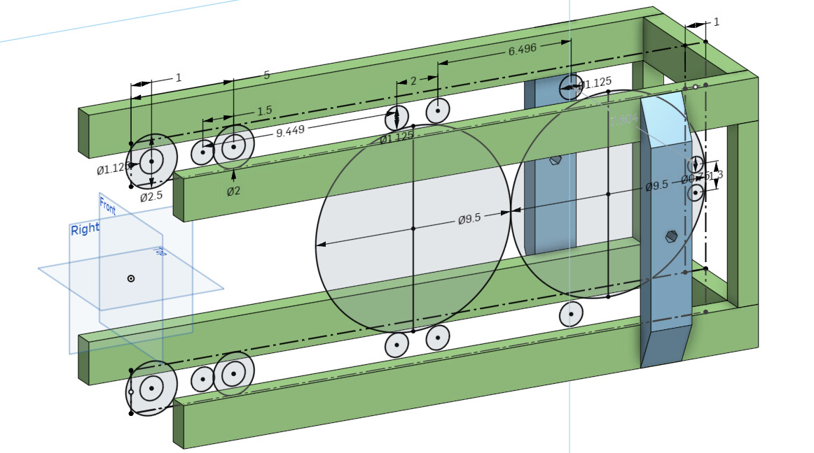

Here’s a master sketch of a ball, with the main frame tubes arranged around it to start.

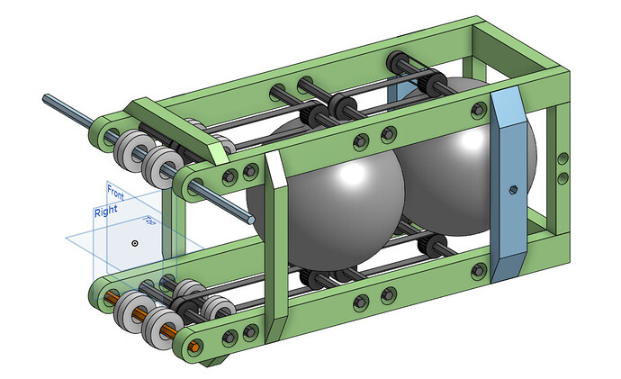

Next I’ll extrude the main frame geometry and create a sketch of where I want major elements to be, in this case I sketched the places I wanted stored balls, and the places I wanted wheels, gears, and belts.
Finally I’ll add power transmission components, you can do this by using derived parts, featurescrips, or by mocking these parts up yourself. I did not reach the stage of adding motors in this concept by the time I abandoned it, but that would have happened next.

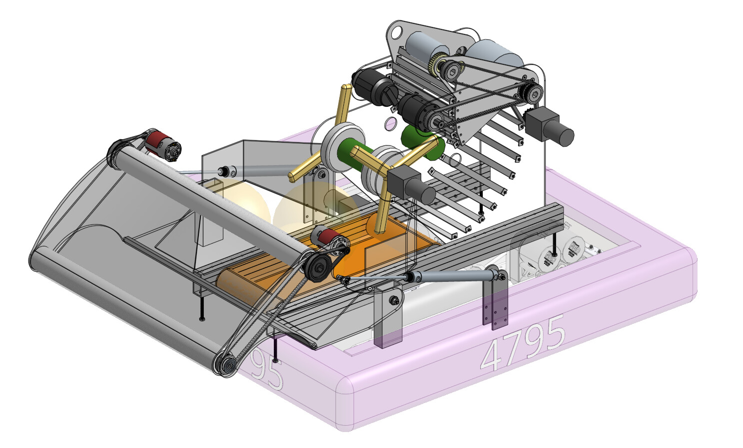

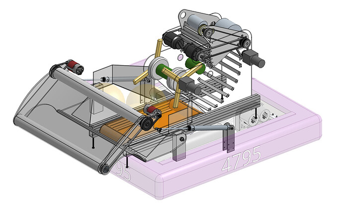

Edit: Here’s another solid example of concept CAD to start, this is from my team’s 2021 skills challenge robot.
You can see that the motors and wheels are all mocked up relatively primitively, and there are no shafts. Certain ideas were pursued and fleshed out more than others here as well, which is evident through the varying levels of detail.
