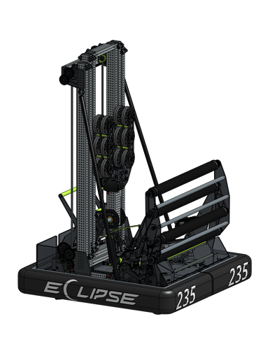

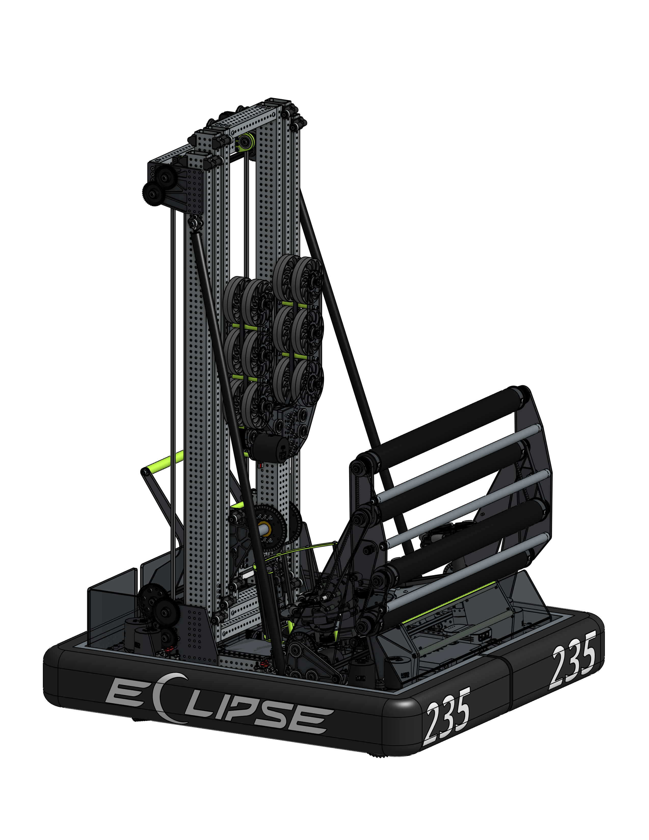

CADathon Team 235 Eclipse proudly presents Obelisk, our robot design submission for 2485’s Battery Battle CADathon. We were very happy to win the Robot Engineering & Industrial Design award. This robot and this design release was a collaboration between myself and @howlongismyname.
Main CAD Document
Technical Binder
2485 CADathon Awards Presentation

In order to keep Obelisk relatively realistic to manufacture, we set a series of rules for our design. These are intended to encourage effective use of COTS parts and create a robot that an FRC team with mid-level manufacturing capabilities could reasonably build. We decided against using any pneumatics; with increased motor slots on the REV Power Distribution Hub and increased legality of linear actuators, it’s just not worth the weight for most teams to run pneumatics for just one or two mechanisms. We also decided not to use any COTS parts from Vex/IFI, in light of recent events.
235 Design Constraints:
  • All custom parts must be able to be manufactured with the following equipment:
    • Prusa i3 MK3S or equivalent FDM 3D printer with all-metal hotend and hardened nozzle
    • Omio X8-2200 or equivalent CNC router
    • Glowforge Plus or equivalent 40W laser cutter
    • Band saw, chop saw, drill press, hand tools
  • No pneumatics
  • No more than 10 motors other than the drivebase
  • No Vex/IFI components

|336x433.46857265795256
This “Cardboard CAD” model was made on the first day of the CADathon as a very basic proof-of-concept for the layout of our mechanisms, and was used as a reference in the initial design stages. We did this before any of our master sketches, to get a better idea of how all the mechanisms would fit together in 3D.

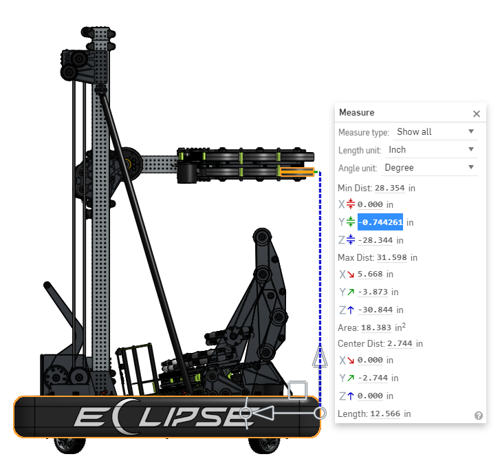

With the elevator mechanism, we knew we wanted to take advantage of the incredible COTS parts on the market right now to make our design as effective as possible while staying within our manufacturing constraints. We decided on the West Coast Products clamping bearing blocks, as they enabled us to make our elevator frame using tube plugs instead of gussets.
The carriage ended up getting in the way of the shaft for the sprockets at the top. So, we decided to split the shaft into two smaller pieces, supported by small bearing plates attached to the top cross frame using nut strips. We were worried this could cause the two sides to get out of alignment and cause problems, so we added a cross shaft connecting the two with gears. However, upon further design review, this addition is definitely more trouble than it’s worth.
We also couldn’t fit traditional box tube bracing, due to the footprint of the indexer and intake in the front. So, inspired in part by 6800’s 2022 robot, we decided on carbon fiber tubes for our bracing instead. They attach using ball joint rod ends screwed into tapped aluminum standoffs that are epoxied into the ends of the tubes. This also makes the tubes effectively act as turnbuckles, keeping the elevator in tension. The tubes are 1 meter long, as that was the most easily available size within the range we needed, and we didn’t want to have to cut any tubes, to avoid dealing with the risk of carcinogenic carbon fiber dust.
|384.89719626168215x635.0374564830215|379.39526159115934x624
Elevator Features:
  • 3 Stage elevator with approximately 10’ of extension enables us to reach the highest bay of the Power Bank easily with plenty of stage overlap
  • 2 NEO motors with 6.25:1 reduction extend the elevator to full height in approximately 2 seconds for quick cycle times while maintaining high stall load
  • West Coast Products bearing blocks provide an elegant solution without the need for any complex in-house machining
  • 20mm OD 1000mm long carbon fiber rods provide support and act as turnbuckles for structural tension
  • MAXtube light grid pattern for ultra light elevator to keep COG low
Disclaimer: This elevator’s rigging is mostly CADathon BS. The first stage chain drive would work but pretty much everything above that is just random pulleys. Please do not attempt to build this in real life.

Quick design question: Given that the lowest position that you would use the elevator in is shown in the starting config render - is there a reason you didn’t make the carriage stage taller? It seems like you could make the assembly more rigid that way as well as providing a hard stop to prevent a crashing condition upon power loss or sensor failure, since it is only travelling for the top third or so of that first stage.
Additionally, could a higher pivot point / longer arm allow you to reduce the elevator to just two stages? Maybe this game had some pesky extension rule that prevented that.
To answer your first question: The main render of the robot, while looking very pretty, is actually impossible. The elevator is rigged cascade-style, meaning you couldn’t actually raise the carriage to the middle without raising the other stages as well, thereby violating the starting height limit. The actual starting configuration of the robot would look something like this, with the carriage all the way down and the arm raised vertical.
As for your second question, a longer arm could probably have allowed us to use a two stage elevator, but that would also have meant scoring the VPs at an angle, which we didn’t want to do. The length of the arm was specifically chosen so that with the robot’s front bumper pressed up against the bottom of the Power Bank, the arm would still have about 0.75" of clearance at 90 degrees. This means we could raise and lower the elevator without worrying about any interference, as our goal is to score the 2 VPs in the roller claw in quick succession.
