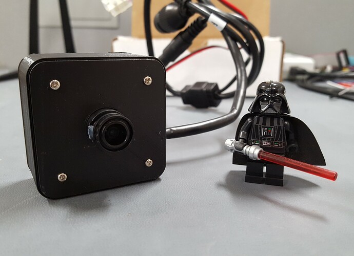

This year was the first we really found a need for a first person view from the robot for our driver in order to locate gears on the other side of the field. So we did some research into how to get the best quality back inside 2MB with decent latency.
The only way to get anything we deemed reasonable inside the 2MB was to use h.264 encoding. The Rio just isn’t capable of doing this while running robot code and keep any latency (lag) out of the system. The answer was in off the shelf security cameras. Most of them have 720p (20fps) output over RTSP with h.264 encoding. This worked well, but we dropped the resolution down to VGA (still at 20fps) to drop the latency down to just a few ms.
This is the specific camera we used: http://www.microcenter.com/product/470325/IP_Security_Camera_with_PoE
It was a pretty simple job to take it apart and make a smaller enclosure so it fit better.

What remained of the camera after you got rid of the shell? What kind of footprint?

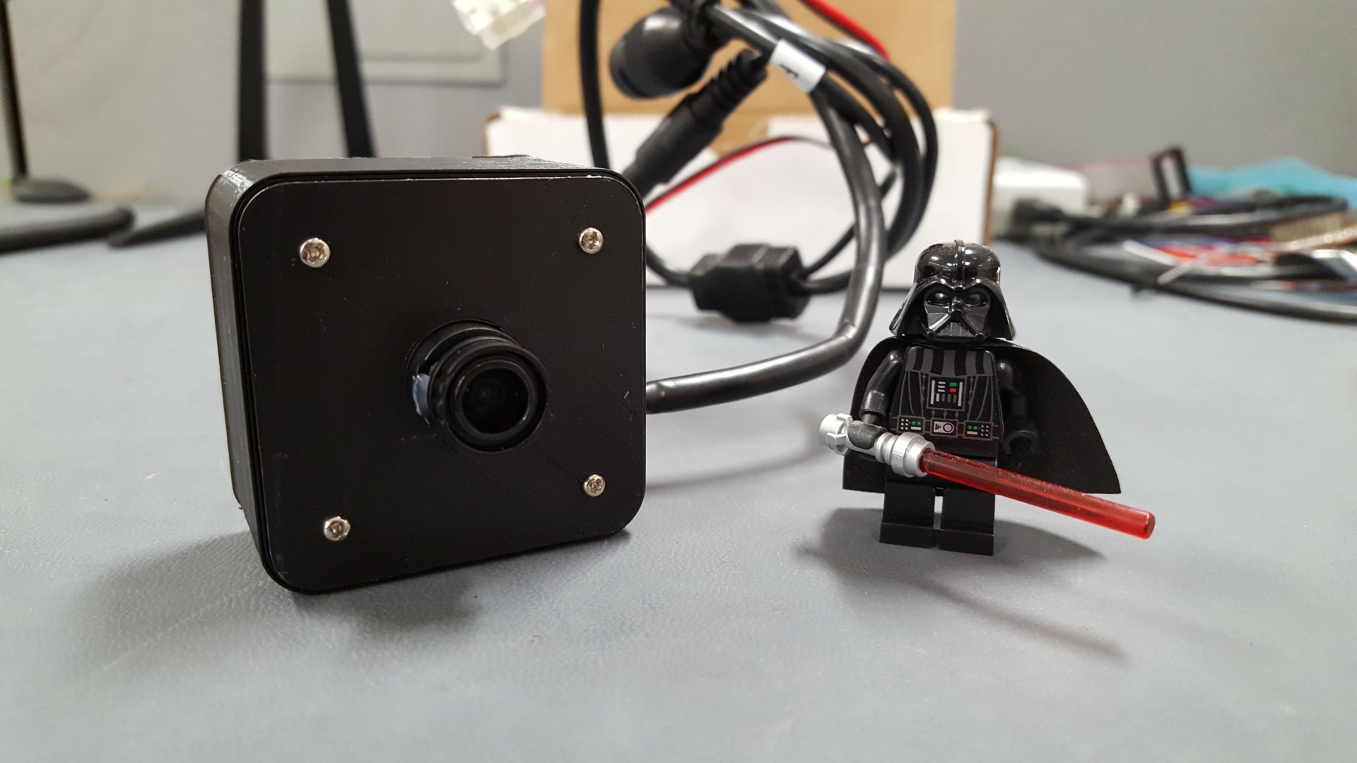

We were able to just disconnect the IR LEDs on the front, as well as the POE power supply that wasn’t needed anymore. So the whole thing got pretty small. The final enclosure that was printed for it is about 2"x2"x1" (I’d estimate 10% of the original size. Photo of it with a Lego Darth Vader for scale is attached.
