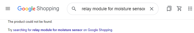

Our project is about automatic switching on and off a centrifugal pump of 3phase input, based on the moisture content of soil.
So we have selected a product from online. But we are not sure whether we can connect it’s relay directly to the pump… Can any one suggest a best way.
This is the product we selected
https://www.google.com/shopping/product/1?q=relay+module+for+moisture+sensor&prds=epd:10486653559732911773,eto:10486653559732911773_0,pid:10486653559732911773&sa=X&ved=0ahUKEwjP1Jqdvbv1AhVeSGwGHYr-Ct0Q9pwGCAU
Something seems a bit off with the link -

without a valid link to the sensor you have in mind, it’s not easy to answer.
