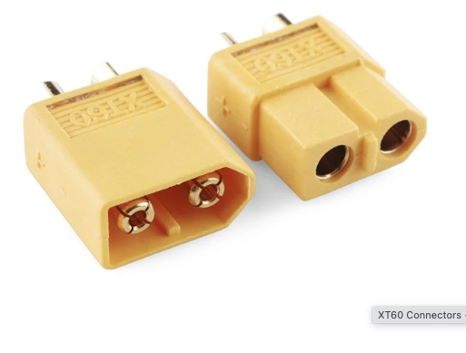

We switched to these XT60 Connectors - Male/Female Pair and they seem much better.
Screen Shot 2025-01-28 at 1.21.10 PM
And they are much smaller than the DTM’s (which are also a great choice).
