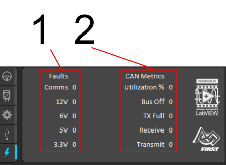

We have a mecanum drive (with 1 Falcon 500 per wheel). We are using CAN this year. Every time we run the drivetrain the motors intermittently start and stop (See this video).
If you look closely, you can see that the indicator light seems to flash orange in between red flashes, which may indicate some sort of CAN issue according to this chart from CTRE. This is supported by the fact that we are getting a “CAN frame not received / too-stale” error.
At the same time another Falcon motor that we are using for our index system seems to work fine without any stopping (you can see the index spinning smoothly at the end of the video). Also, the motors that display the stopping behavior seem to change every time we disable and re-enable the robot.

You are declaring the same TalonFX in both differential drive and mecanum drive. I suspect the motor safety in one is interfering with the other. Pick one and remove all references to the other.
What is the utilization of your CAN bus when this happens?
In general, it is often very helpful to use the log viewer to examine data from times when you have seen problems. Posting screenshots of this data can really help to answer some of these questions. In particular, “CAN %” normally shows up here. But, this data can really help to narrow the areas on which to focus for many different problems.
