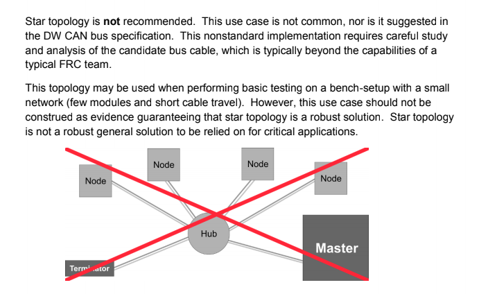

Due to a couple of consistent problems with checking CAN connections during the 2017 Power-Up season, our controls department has been looking for ways to simplify wiring to a central hub, so that only one central location has to be checked for any CAN related issues.
After some thought, I realized that since the order of connecting CAN devices together doesn’t matter, making a central board to manage the wiring should be a simple task.
To test the notion that centralizing CAN connections could work, I quickly whipped up a proto-board prototype, and to my surprise, it worked! (there will be pictures at the bottom of this post).
I tried changing the order of the CAN connections, and the RoboRIO web interface still recognized the motor controllers(victor spx & talon srx), and I was able to control the motors. After reading a bit more into the idea, a helpful mentor noted that CTRE apparently doesn’t recommend the hub, due to ‘star topology’. My main question is, why is connecting the CAN devices to a central hub regarded as “less stable”, and only recommended for test benches according to the talon manual(image below)? Additionally, doesn’t star topology actually benefit the reliability of the CAN connections, since if a cable fails, only one node will be brought down?

You might get away with it, but is that really the best approach to solve a problem where you’re trying to make a system more reliable?
You are right in that making a central hub won’t deter from any bad crimps or joints, which are a major problem. However, the main objective of this project is to make diagnosing which connections are faulty much easier. Additionally, we inevitably have motor controllers in separate parts of our robot, meaning that the CAN loop is (sometimes unavoidably) hard to access. This *solution attempts to centralize the connection point in order to help fix CAN issues faster during competition.
At the speed CANbus operates (1 Mbps), you have to think of the twisted pairs as transmission lines. In order to avoid causing reflections, which can potentially interfere with subsequent signals, a transmission line has to be terminated with its characteristic impedance (~120 ohm, for 20ish AWG twisted pair). Now, this can be done in a star topology, by terminating each of the “arms” of the star. However, the more arms there are, the lower the net resistance between the two sides of your bus (resistors in parallel). With lower differential resistance, it becomes harder for the CAN transceivers to rapidly assert a dominant voltage on the bus. (When the bus is left to float, and the sides are at approximately the same voltage due to the resistors, it’s called a “recessive” state. When the sides are driven apart, one side high and the other side low, it’s a “dominant” state.)
While we don’t use it in FRC, it’s interesting to note that there’s a different standard, called low speed or fault-tolerant CAN, that allows bus, star, and pretty much arbitrary topologies, at the cost of much lower bandwidth.
It’s not usually a problem to use star topology, if you’re confident in your wiring. CAN is not only very robust, but also tells you when you get CAN errors, so it’s possible to pick up any blips.
That being said, using bus topology is one less thing to worry about when debugging CAN. If you’ve only got Talons on the E-plate of your robot, right next to the RoboRIO and PDP, star can work easily. But if you have a branch of CAN going 10ft to the top of your elevator, you might start seeing issues.

That article seems to say that you can basically use star topology as long as the branches are less than 1ft long. So if you have a compact control board, star should work. But I wouldn’t risk it. 548 always solders their CAN in a chain/bus topology and I don’t think we’ve had any issues in the last few years.
Read down a bit further.
***Additional Information
The CAN bus is designed to be setup using a bus network topology. You cannot use a star or a ring topology. ***

Star topology networks almost always (perhaps always?) have an active device as the “star” to reduce (or in some cases eliminate) “packet collisions” where two or more nodes are trying to send data at the same time on the same piece of wire in the same bandwidth/channel, and which limits the amount of energy each node requires for transmission. A bus topology puts the nodes at a bit of a distance from each other, allowing collision mitigation, and, as Carlos notes, allows the ends of the bus to have an appropriate resistor to knock down reflections while not (significantly) increasing the power load requirement on each device as more are added.
CAN is quite robust and you’ll likely get away with this on most FRC robots - but you risk crossing that threshold and having to rebuild quickly at an inopportune time, and/or losing match(es) because your CAN is overloaded.
A bit of electrical background for those who might be viewing this thread and thinking “but it probably works right???”:
When frequencies are low, and wire lengths are short, you can make the assumption that electrical current and voltage travels instantaneously from one point on a wire to another, with no distortion in waveform.
As frequencies get higher and/or wire runs get longer, this assumption is no longer true. The effect is usually modeled with what’s called a Transmission Line.
1Mbps CAN on an FRC robot is just barely where this assumption flips to requiring having a transmission line in your model of the electrical signal.
A certain node on the bus will produce a waveform that is distorted in specific ways as it propagates down a wire. It gets rounded out (slower voltage slew rate as you switch between high and low voltage levels), and delayed. This can be bad, since CAN protocol relies on having all transmitters start talking at the same time, with some minimum low-to-high transition time. Devices & wiring schemes that cause these assumptions to be violated are no longer technically compliant with the standards for CAN, and all bets are off as to whether you can transfer data.
The ISO standards for CAN are set up to assume a transmission line in between each node, but not a transmission line from a common point to each CAN bus node device.
Again, for sufficiently short wire runs and CAN bus speeds, can you make it work? Maybe. Should you play with fire? I don’t think anyone will say “eeeh you’ll be fine”.

Are you plugging in both pairs of the CAN wires for each motor controller into your board or just one pair? If you plug both pairs into your board, the stub length is equal to the length of each pair of CAN wires. If you only plug in one of the two pairs, your stub length is roughly twice the length. This might cause greater signal distortion than if both pairs are plugged in. Please note that the length of each of the pairs of the CAN wires is 1 ft as delivered from the factory.
You can get the basic effect you are after (all connection points in one area) if you cut the solid wires running the length of the board to divide the connectors into pairs. You would plug one of the CAN wire pairs from a motor controller into one pair of connectors and the other CAN wire pair into a different pair of connectors. You may have to double the number of connectors you install on the board. This would change the star into a daisy chain. It would have the same effect as having a bunch of the CAN Connectors from AndyMark all on the same board.
The challenge with “getting away with it” is systems such as a CAN bus are nonlinear. Doubling the amount of noise or distortion may not lead to an degradation in system performance if the noise or distortion is small enough. Conversely, if the noise or distortion is just below the detection threshold, a small increase will cause a significant degradation in performance.

This is, in fact, a star topology, unless I misunderstand the layout. In the proper bus topology, the “stub length” is the distance (inside the Talon, etc.) from the PCB points that connect to the CAN bus to the CAN transceiver.
Star topology may “work” in FRC electronics, due to the short distances involved. However, by introducing a multi-arm topology, you’re eating into the safety margin provided by the CAN protocol physical layer. Unless absolutely unavoidable, I’d prefer to do correct CAN wiring and avoid invading the margin.
