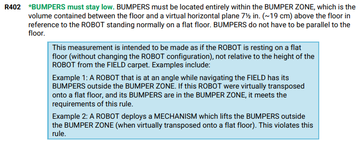

Hello everyone, we planned to deploy a mechanism from under the robot while on the chains but were unsure if any rules prevent this. What will the robot’s inspection look like when ensuring it fits within the 4ft height limit? Thanks!

Rules that govern this type of action are: G412, G413, R402.
G412 is the on-field enforcement of R402, so those two overlap. Violations are Fouls for both G412 and G413, but if you’re in violation of G413 and you’re helping your scoring, it becomes a Tech Foul.
Here’s why it’s tough: The Bumper Zone is in reference to the robot “resting normally on a flat floor”. In other words: If the chain vanishes and your robot lands on the floor, how it would come to rest is what governs whether there’s a violation. R402’s Blue Box includes an example of an extension lifting bumpers out of the Bumper Zone, which according to that is a violation.
How would you get it inspected? Simple: Deploy it. Work with your inspector to do a measurement with it deployed, and I would do both a “accidental while driving” deploy scenario (robot on a flat floor, deploy mechanism, measure) and a “fell off the chain” scenario (pick the robot up, deploy mechanism, set robot down). The results of those will inform the inspectors, who are likely to inform the referees as to what’s up with your device.
A consideration: You may want to make sure that if the mechanism is landed on, it folds up enough to keep your bumpers in the zone and the height under 4’. This would also help protect the mechanism.

I believe this rule means that no matter what, your bumpers cannot be more than 7.5 inches higher than the lowest point of your robot, making under the robot extensions non-viable unless the bumper moves with them. There is always considered to be a virtual floor under your robot, even when suspended, and the bumpers have to be in the bumper zone relative to that virtual floor. A good example of this would be the 4907’s jump climb in 2022. The bumpers are always the lowest part of the robot.

Looking at it further: That is definitely the case as defined by the examples under rule R402.

I’m going to suggest re-checking your phrasing.
Because bumpers CAN be more than 7.5 inches higher than the lowest point of your robot, in cases where the robot is at an angle. If the rule meant what your initial assertion says, every single robot out there would be illegal at one point or another. Given Example 1, that’s obviously incorrect.
That said: If you read Example 2 of R402 again, you’ll find that if an under-robot extension does not lift the bumpers outside the bumper zone, it’s actually going to be legal. The illegal part is the “lift the bumpers out of the zone” part. So an under-robot extension MAY be a viable option. It’s going to depend a lot on the design and use. Under-bumper horizontal extensions, for example, could be an interesting solution to a problem or two… or not.
