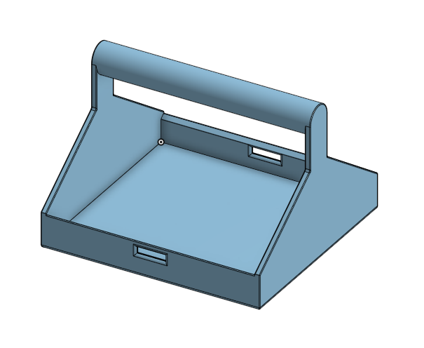

This is my thought for my case what do you think?
Screenshot 2025-02-04 141610
Sure looks like a case to me!
longevity and versatility.
Do you believe it meets these design goals?
What testing or evaluation has been done to back up those assertions?
That is my next question, how do I make it better, and add integrity?
Personally I would make those walls thicker. That battery is a lot of mass and depending on how violent the collision that could easy snap with enough acceleration. If this is going inside a metal plate thats fine but then I ask how are you planning to secure this to the frame or belly pan, etc. I see you have a thin slot for what i’m guessing is Velcro. Personally I would use a pretty thick one, like 3in wide and make sure you’re using the metal frame to secure this whole assemvly and not just letting gravity hold it down
