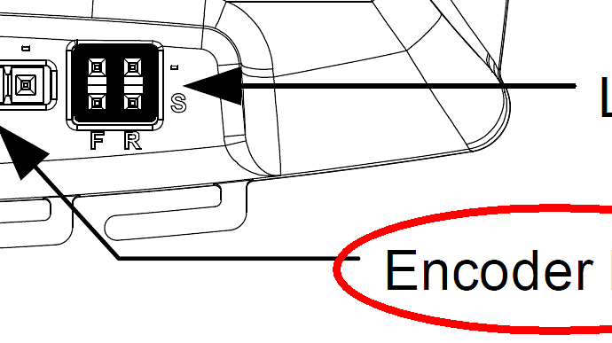

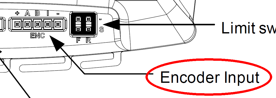

We are using jaguars to control cim motors and also how might you hook up a encoder directly into the jaguar for use with the pid loop
I think you’re assuming that the PID values control only the motor output. In reality, these values are used to control an entire system. One person’s kitbot transmission may be different from someone else’s which would mean that their values will be different. You have to sit down and tune your robot to how you think it responds better.
The P, I and D will all cause the robot to behave differently. I can recommend as a general rule of thumb to try a value < 1 for I and something around 20~30 for P (I’m not exactly sure on this value). Leave the D at 0 until you tune these.
You should definitely read the document mentioned above in order to understand what each value does to the system. Only then will you be able to see what it does and how it reacts.
See attachments.
Ether is correct, that’s exactly how we’ve been connecting our encoders for years! Also, keep in mind that if you want to use the built in PID features of the JAGs, you’re going to have to implement the CAN Bus. You won’t be able to use PWM anymore.
