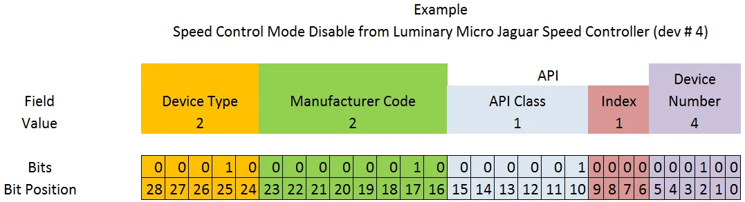

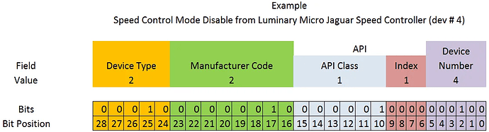

Actually not. the device number is part of the canID. If you look at the example below, the device number is only part of the canID. Multiple devices on the bus with the same can ID will make you sad.
Thad_House explained it very well in his post. (As he always does)
Yes im well aware of that. My post was using the colloquial usage of the term “CAN ID”, which as you alluded to is the device ID field. Given this usage, my comment is perfectly accurate
