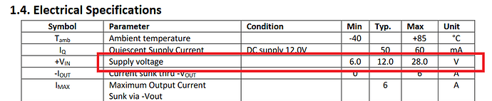

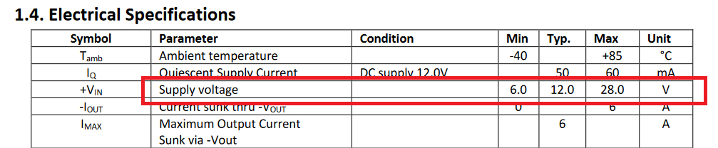

CANdle needs a 12 Volt power input.
User manual snippet for reference:
For 5V LEDs, CANdle has a regulated 5V output that can be used. The input power needs to still be 12V though.
If CANdle is being powered by less than the 6 volt minimum it’s very likely the CAN comms hardware is not functioning or functioning incorrectly, which could cause what you’re seeing.
