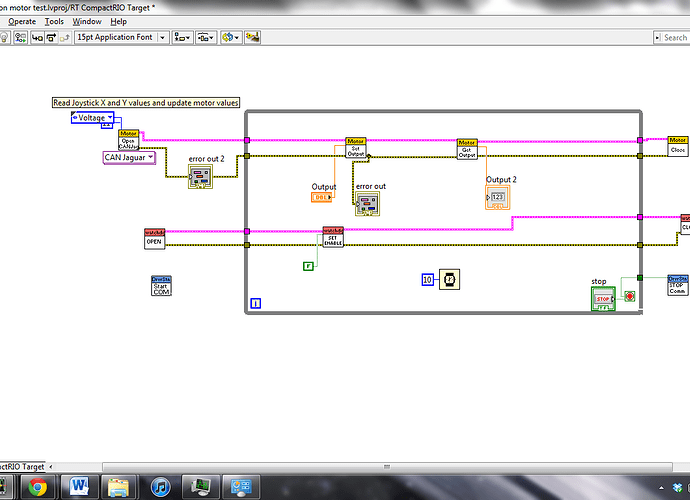

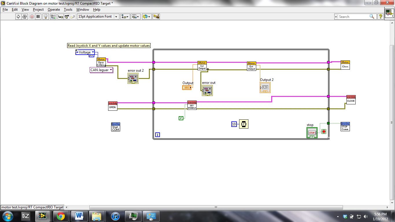

Here is a snapshot of the VI that we built to run a motor. the Jags stopped changing the rate of blinking, and are now not showing any indication of being connected outside of Enum.http://www.chiefdelphi.com/forums/attachment.php?attachmentid=11460&stc=1&d=1327021294
We are going to use PWM for now, if anyone sees a problem in the test code, please alert me.
Thank you everybody for the advice. The problem turned out to be a faulty cRio. We received our new cRios on Friday and everything is working fine.
