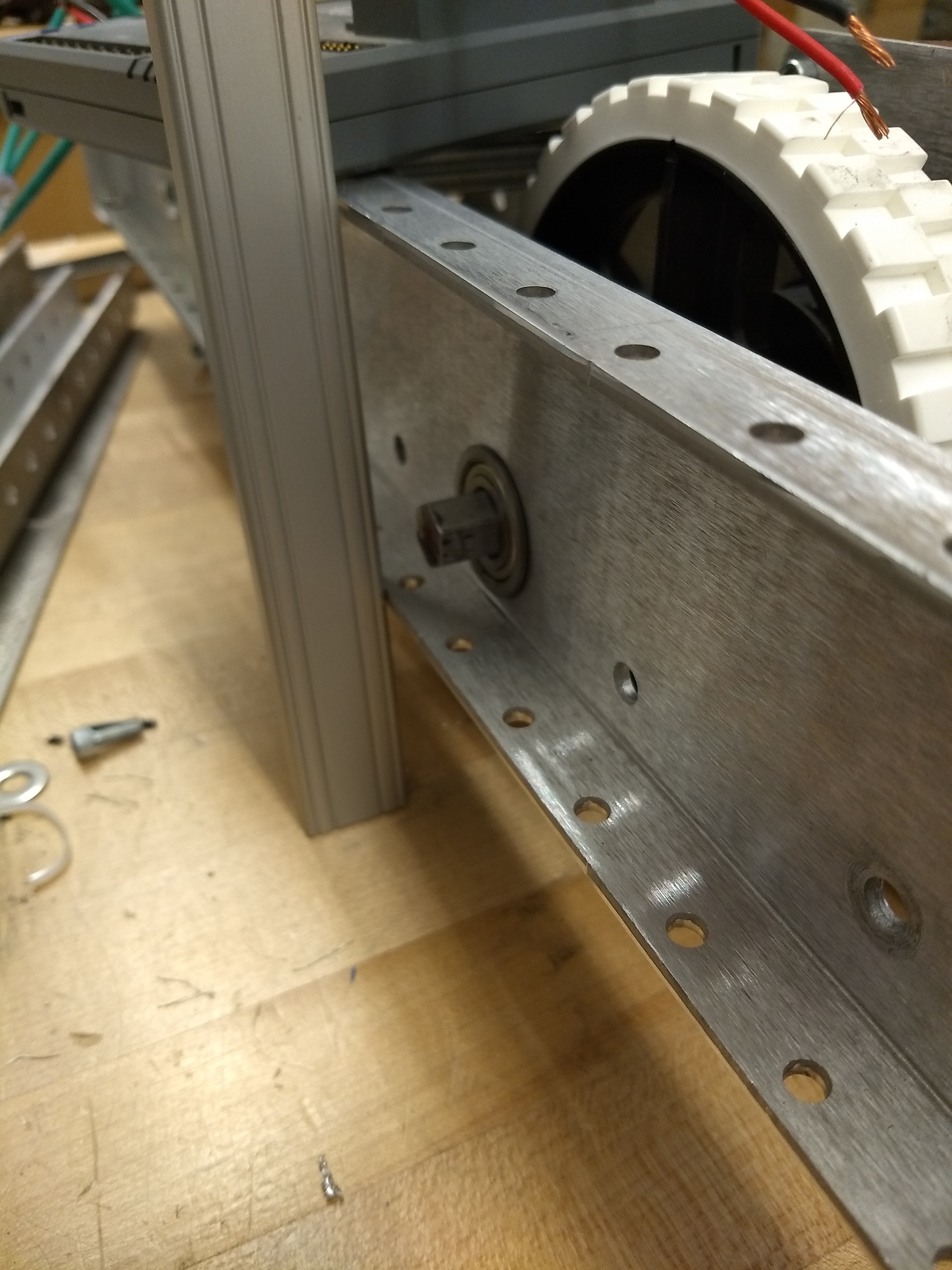

Can the axle shaft stick out
We are dealing with mounting encoders & realize that we need to swap out our axles. Is there a problem if the end of our axle comes through the bearing by 1/2", but stays inside the perimeter of the frame?
If the axle stays inside the frame perimeter, there’s no problem legally. If it sticks out though, that would then define the new frame perimeter and since it’s articulated it would be illegal.

He’s asking if the axles sticking out from the outer frame, but within the perimeter are legal.
If he’s asking what you think he’s asking, then I think we need pictures. What you’re describing may end up defining the Frame Perimeter, which would be illegal.

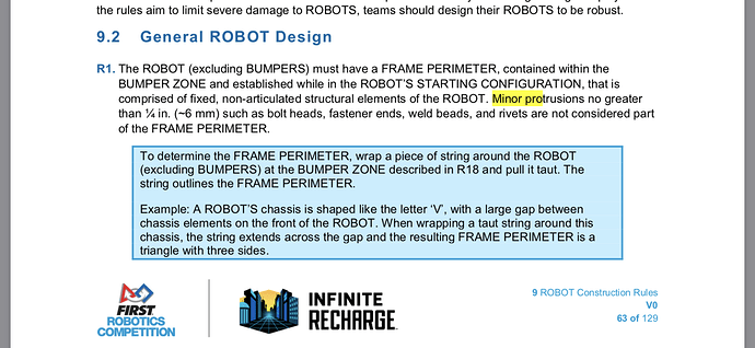

Minor Protrusions that exceed the frame perimeter are allowed if they are less than 1/4 inch.
I believe that shafts qualify as ā€œminor protrusionsā€ as the year that minor protrusions were not legal (2015?) I seem to remember the kit bot was illegal without modification due to the shafts slightly sticking out of the frame perimeter.
Yeah, that’s totally fine. I’m guessing what happened is that the inside rail was installed one hole too far out from the end. No bigs.
But just to be sure, when you look straight down from the top can you see the axle sticking out?

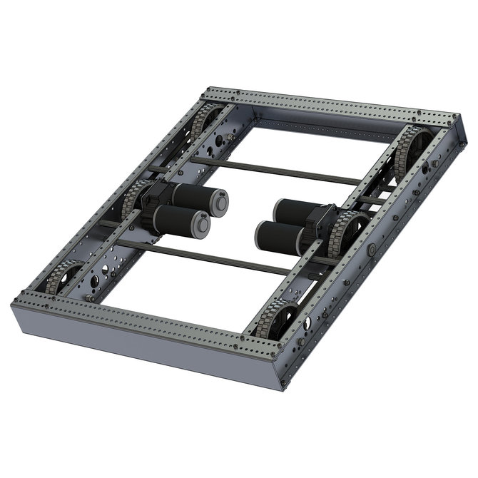

https://andymark-weblinc.netdna-ssl.com/product_images/am14u4-kit-of-parts-chassis/5c2fa4e661a10d20e10dd2b1/zoom.jpg?c=1546626278
Are your outer plates turned inward like that?
If they are, then you’re OK rules-wise (as long as you don’t put the axle too far out).

I would be concerned if a moving part (I assume your axles are going to move) are going to be deemed a ā€œminor protrusionā€. Also the rule is 1/4" not 1/2". As long as they are inside the FP they are not an issue. I would want clarification before I build something with them being part of defining the FP. In previous years (insert required statement about the past meaning nothing, nothing I say) mechanism bits other than fasteners typically were not allowed as ā€œminor protrusionsā€.
I would not list the ends of drive shafts as similar to ā€œbolt heads, fastener ends, weld beads, and rivetsā€. All of those are rigid, non-moving, fasteners connecting two or more structural elements, which is not the case for a drive axle. To be safe this would be a good question for the Q&A.

Sorry I am not understanding the point you are making. The quote attributed to Al states that bearing are pushing that definition. A reasonable conclusion from that statement is that axles protruding ā€œpastā€ the bearing would be pushing it even more. Ie they would not be considered as minor protrusions. I really struggle to fit a bearing or axle into the language of R1 which states:
ā€œfixed, non-articulated structural elements of the ROBOTā€
At a minimum I would Q&A it and plan on showing up for tech inspection with a printout of the answer rather than hanging the legality of your design on a 6 year old forum post (which has even less weight than a Q&A answer)
Note: this is in no way disparaging Al, it is pointing out that Chief Delphi posts even by FRC heavyweights, do not have official standing at tech inspection. Q&A answers also can be overruled, but they at least carry ā€œwe intentā€, or ā€œour interpretation isā€ weight.
Also, they have been fairly consistent with applying the everything inside the FP in starting config (R2) to apply to everything except ā€œminor protrusionsā€. Both at events and in Q&A answers they have been pretty restrictive as to what gets exempted as a minor protrusion, and I would bet a shaft sticking 1/2" past your FP is not going to get exempted.

I hope that a few statements here will help in the understanding…
  1. When any part protrudes from the frame, it is evaluated for FRAME PERIMETER or minor protrusion. If it is obvious structure (axles would be included in this illustration in most cases, then the perimeter still needs to be under 120".
  2. Bumpers need to be mounted on the FRAME PERIMETER. As such, to cover these ā€˜major’ protrusions, additional material may be needed to satisfy bumper mounting rules.
  3. One of the biggest concerns to vendors and inspectors is that team sometimes do not read the assembly instructions fully. As shown in the drawing above, the assembly of the kit frame would allow for the bearing and about 3/8" of shaft to protrude from the inner surface of the C channel. However, the FRAME PERIMETER is defined by the outer edge of the C channel and therefore even the shafts are likely to rest behind the perimeter.
  4. The definition of minor protrusions has not changed in many years. The words ā€œsuch as bolt heads, fastener ends, rivets, cable ties, etcā€ does not include structural parts or axles. The 1/4" specification is used with this definition to allow teams to weld their frame, mount mechanical devices without the need of specialized hardware and to use kit bot chassis kits where the heads of all the bolts supplied are 1/4" or less in height (when inserted with the bolt head on the outside of the frame).
It is impractical to ship sizing boxes to all events so they were eliminated long ago. To visualize this, think about your design and evaluate if your robot could slide into a sizing box without contacting axles or other structural parts.

Trying to attach a photo. Not sure why this would be an issue as it is inside the frame perimeter. Please advise.
That’s fine.
Yeah that is fine.
