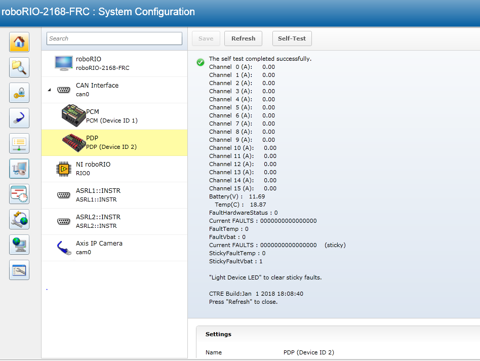

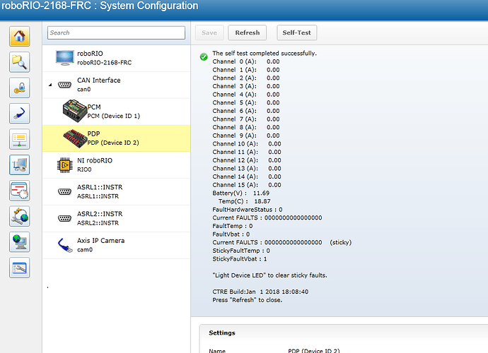

Please contact support (support@ctr-electronics.com) with a screen shot of the PDP self-test.
Sent email but posting picture here in case anyone else has ideas: seems to be software/protocol related at the moment.

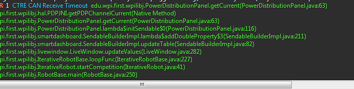

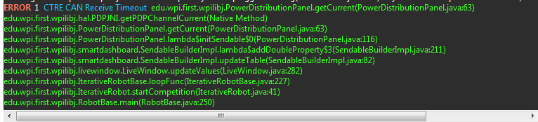

It would appear that the stack trace above (from 2017 code ported over to 2018) has issue in code that is not written by us, but by WPI LiveWindow? I think 2018 has an automated telemetry feature because our code is not in the loop in the above stack trace.
So we found a work around or possibly a solution. For some reason the PDP is not happy when our code runs and the new 2018 Telemetry feature is enabled.
We have our own thread that polls the PDP at a rate of 20ms. This worked flawlessly in 2016 and 2017. 2018 adding the new Telemetry feature which is enabled by default i believe is polling the PDP, while we are polling the PDP and is it possible that the double calls are causing the timeouts?
In any event Ensuring PDP was set to ID 0 for WPI lib, and disabling the new 2018 Telemetry feature made all CAN timeouts go away and our system became stable again, and our personal polling thread provided all PDP can data properly.

If you construct the PowerDistributionPanel with ID=0, and your PDP is not at ID=0, you’ll see CAN timeouts from the LiveWindow code because it is trying to get information for ID=0. If your PDP is at some other ID, you should construct PowerDistributionPanel at that ID instead (which you said works fine in a new project). Is it possible your 2017 code is constructing PowerDistributionPanel with ID=0 somewhere? It looks like you might be?

The CAN timeouts only happened with GetVoltage and GetCurrent calls, not with any other PDP methods, which means we could communicate to the PDP. After looking at the stack trace, it can be seen that it isn’t our code that is timing out, but the code from LiveWindow. Since we don’t use Livewindow, immediately jumped out to us that it could be the new 2018 telemetry link.
Turning that off resolved all timeouts. If we disable our thread, but leave telemetry on, timeout errors stop as well. So it would appear that our calls at 50hz and livewindow calls (which I think runs at the rate of the TimedRobot class default at 50hz as well) is bombarding the Can bus.
