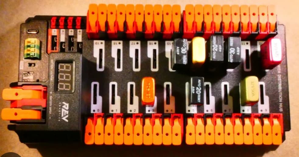

Can you mix the old black 40 amps breakers with the new gold 40 amp breakers. See picture. Is this mix use advisable?
Each circuit is individual so there is nothing wrong with mixing breakers.
Just be aware the old black 40A breakers are larger and will not fit into the PDH.
