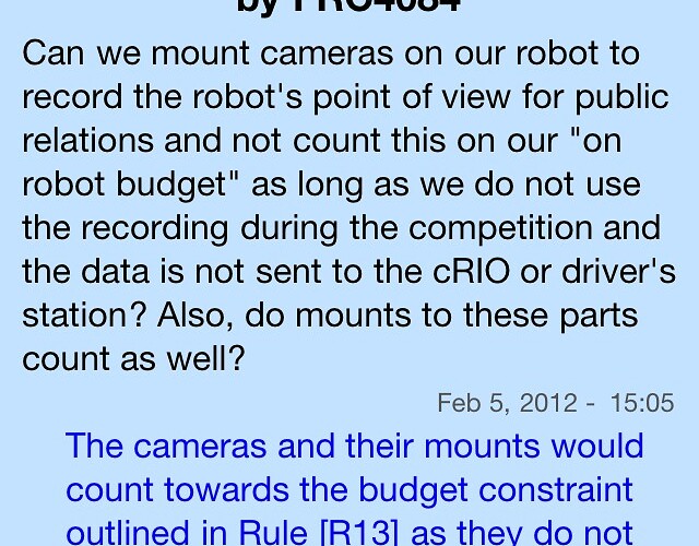

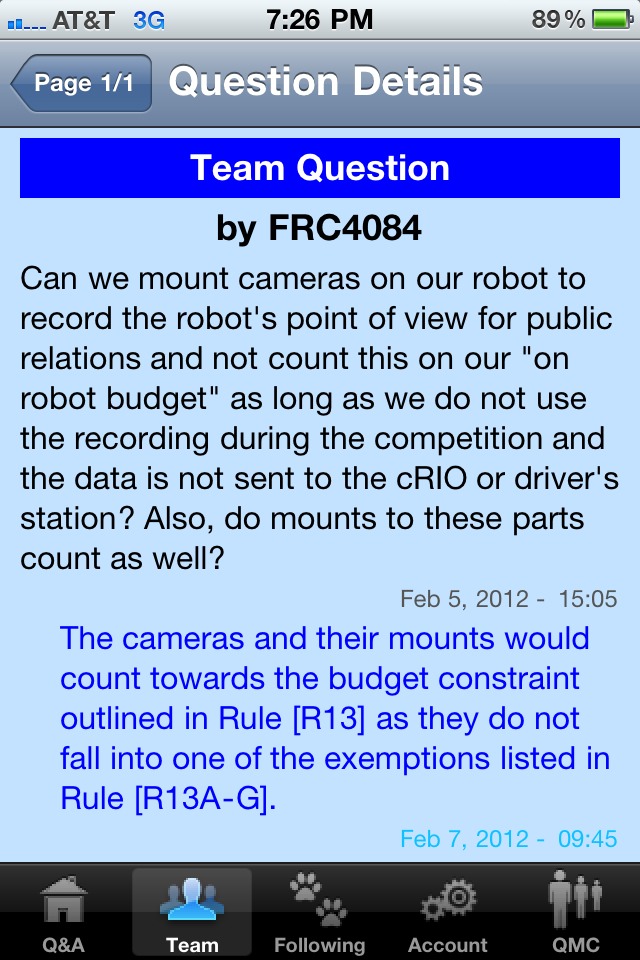

Sorry I’m on my iPhone, but we asked this exact question to the Q&A and found based off this that we cannot mount then because our robot costs too much.

I guess the GDC answer above says otherwise, but I gathered by some of the rules that a camera not used during the match could be considered a “non-functional decoration” and thus exempt from the cost and transmission rules. Specifically…
[R05]
Any non-functional decorations included on the Robot must not affect the outcome of the match and must be in the spirit of Gracious Professionalism.
I would think a GoPro camera intended for PR only would fall within this rule.
[R67]
Any decorations that involve broadcasting a signal to/from the Robot, such as remote cameras, must be approved by FIRST (via e-mail to [email protected]) prior to the event and tested for communications interference at the venue. Such devices, if reviewed and approved, are excluded from Rule [R55].
Thus, it is possible to have a “decoration” that broadcasts a signal. And it is allowed to broadcast…
[R55]
One D-Link DAP-1522 is the only permitted device for communicating to and from the Robot during the match. All signals must originate from the Operator Console and be transmitted to the Robot via the official Arena hardware. No other form of wireless communications shall be used to communicate to, from or within the Robot (e.g. radio modems from previous FIRST competitions and Bluetooth devices are not permitted on the Robot during competition).
And…
[R13]
The total cost of all non-KOP items shall not exceed $3,500.00 USD. All costs are to be determined as explained in Section 4.1.3: Budget Constraints.
The following items are excluded from the total cost calculation:
items listed on any KOP Checklist (qty is limited to the total listed in the most recent checklist),
items obtained via a Product Donation Voucher included in the KOP,
items ever distributed to the team via FIRST Choice,
** any non-functional decorations,**
individual fasteners, adhesives, or lubricants that are less than $1.00 each,
spare parts, and
parts of the Operator Console.
…exempt from cost rules.
I guess the GDC thinks otherwise, though…
