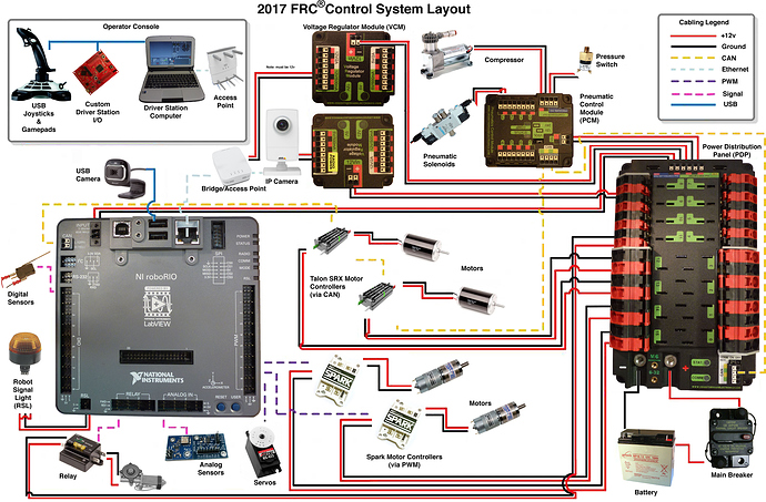

We can reverse the slots where the VRM and PCM receive power from the PDP, correct?
VRM for your Radio (and only your radio) has to use one of the two sets of power push connectors connected to the 20AMP fuse, does not matter which. (R48)
The PCM controlling the compressor can be attached there as well (R48) or to one of the smaller wago connectors with a 20amp breaker. (R52)
I meant the black and red wires on one end of the PDP (non-battery end). On the 2017 diagram, the PCM is on the furthest right, and the VRM is in the center, with the Rio being far left.
Can we swap the PCM to be in the center and the VRM to be on the right?
Yes

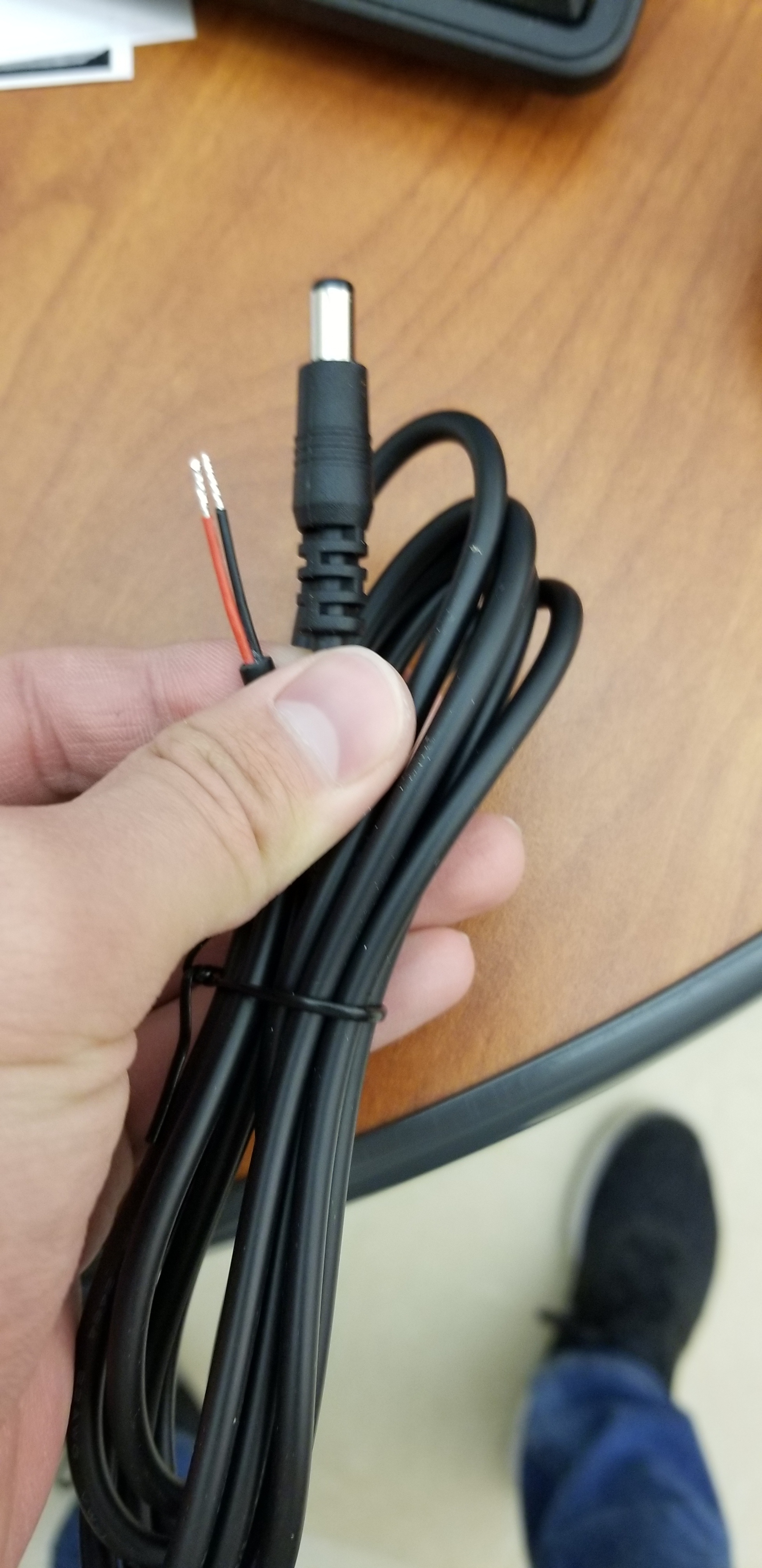

Radio power.

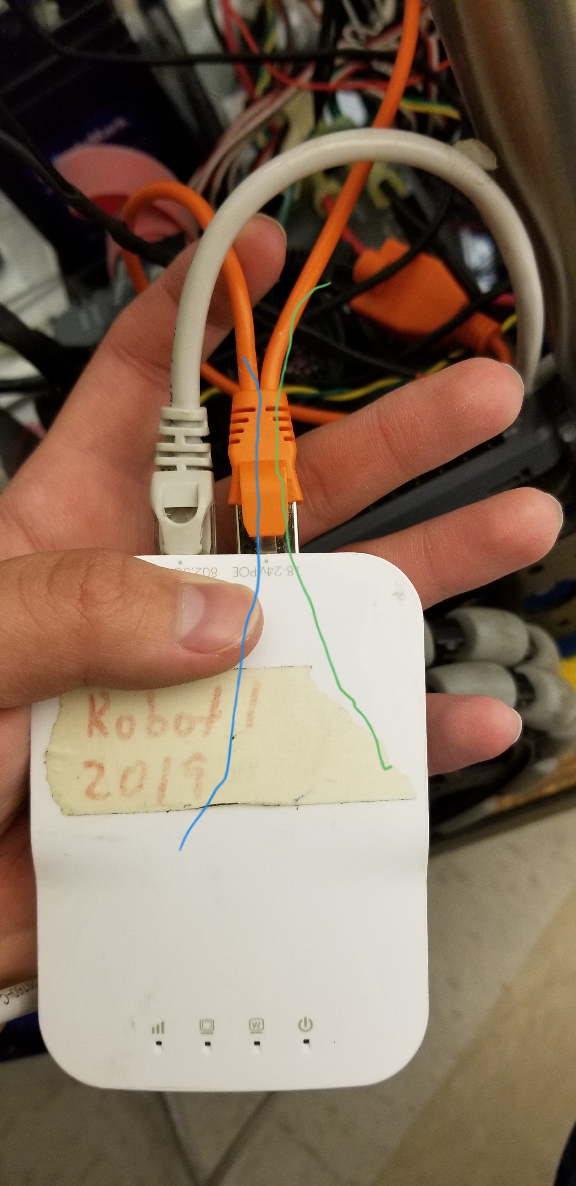

This was in the KOP. I assume it’s for the Radio. If using this, we would plug into the VRM and still have the ethernet from the rio but in separate lines?
The blue line is the ethernet, the green is the VRM power line.
The grey ethernet cable is to limelight.
Correct. You can have both the barrel jack adapter and the POE connected to the VRM. Redundant power to the radio is your friend.

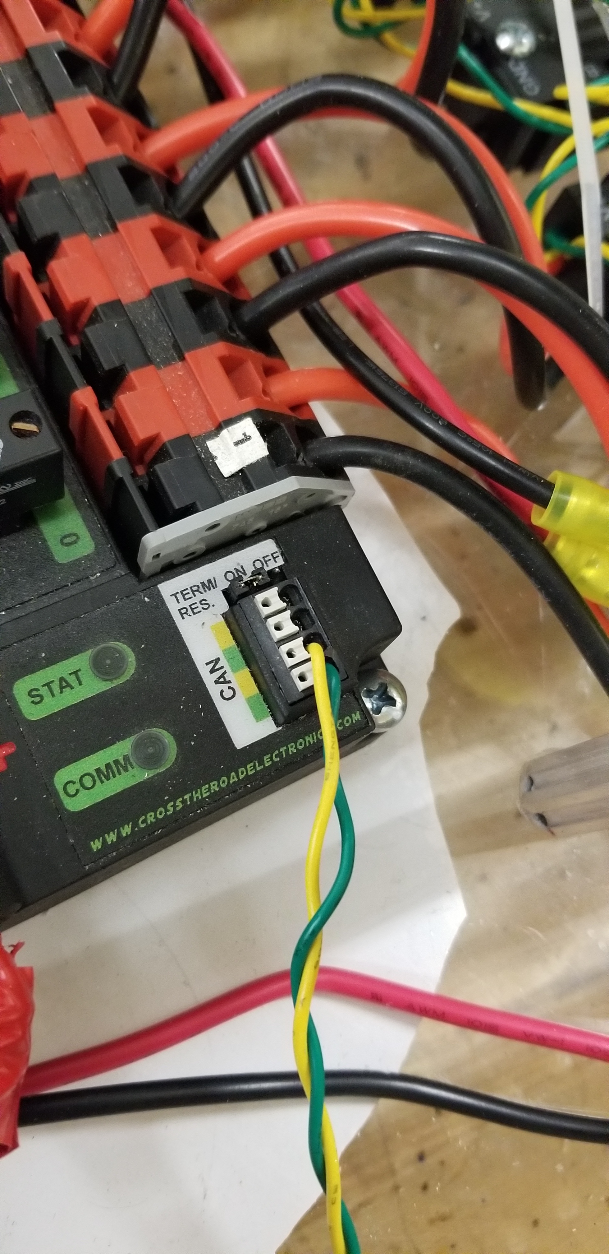

Is this ok if left like this? the PDP only has the one set of CAN
Yes, you just need to make sure the “TERM RES.” jumper is set to ON, which it looks like it is from your picture.

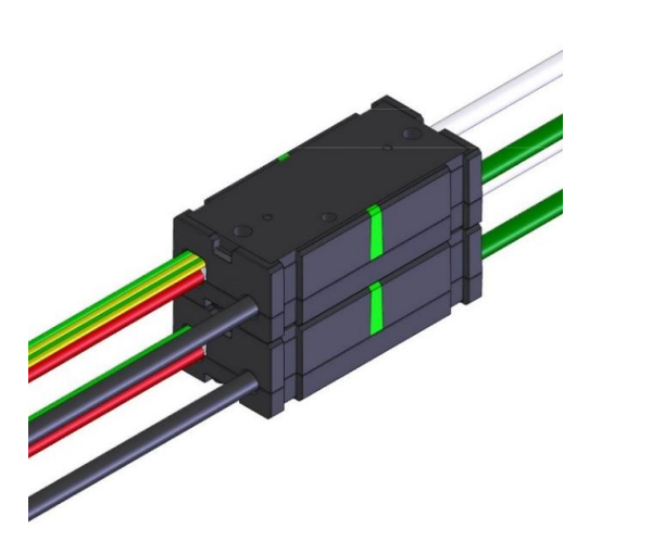

According to this picture, Victor SPXs can be stacked. Should you stack them?
Edit: We currently have thme in a row, screwed onto polycarb without an aluminum plate.
Untitled
I have seen that done on quite a few robots. I think they were designed to allow the LED’s to still be visible when stacked. Long, thin zip ties would work too.
