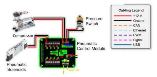

My team is using a pnaumatics system on our robot. The problem is, it loses pressure very quickly (even with two air tanks as part of the system). We are manually adding air to the tanks by connecting the compressor to the battery directly. Is there a way to operate the compressor programmatically with Java (turn it on and off)? Perhaps using the Compressor class? We figure this might be the best approach to prevent the robot from losing air pressure half-way through a match. Any help is appreciated!

If you wire your compressor into a Pneumatic Control Module (PCM), and have also wired the pressure switch into the PCM, then all you need to do is instantiate a Solenoid or DoubleSolenoid class in your code. If any amount of either of these exist in your code, the compressor will automatically run in closed loop control mode.
Meaning if the pressure drops (below 90PSI? I’m not sure what the switch is set at), the compressor will be turned on, and when the pressure reaches 120PSI, the compressor will be turned off. You don’t need to do anything else to make this happen.
This means you don’t need to use the Compressor class, unless for example, you wanted to force the compressor off during a climb for example. Note, you can’t force the compressor on if the pressure switch is open.
Untitled
Edit: Added diagram

Interesting – you mention " the compressor will automatically run in closed loop control mode. Meaning if the pressure drops (below 90PSI? I’m not sure what the switch is set at), the compressor will be turned on, and when the pressure reaches 120PSI, the compressor will be turned off." We are not seeing this functionality happen. We are using a DoubleSolenoid, but the compressor (which is connected correctly as specified in your diagram) is not being activate at all. We are manually connecting the compressor to the battery to add pressure to the tanks. Below is the code:

There is a couple of things I would like to check.
  • Are you instantiating your PneumaticsSubsystem class? (Sharing your entire code base can help us validate this or find other potential problems)
  • You mentioned the compressor is correctly connected to the PCM, is the pressure switch also connected?
  • Can you confirm using Phoenix Tuner that the PCM does in fact have an ID of 0
  • That you have a Driver Station connected to the robot and are enabling the robot (the compressor won’t run otherwise)
  • When you try to extend or retract the piston, do the indicator LEDs on the solenoid ports light up? (See attached image)
  • When the robot is enabled, does the STATUS LED flash differently (faster) then when the robot is disabled?
  • When the robot is enabled, and the pressure is low, is the COMP LED on?
