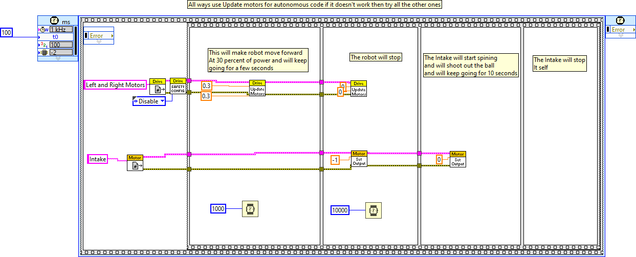

try this to find the intake Team358.org - Robotic Eagles - FIRST® Robotics Competition it didn’t have the Autonomous intake, then I try getting rid of the saftey code in Autonomous id didn’t work I try many joysticks for the intake a see if that has something to do with it in teleop and it didn’t work The intake work when we actitvate the teleop it work fine but when we try Autonomous the robot moves but the intake won’t move at all. So can anyone tell me what should I do because I have know I ideas on what to do. Right now I am about to try a timed loop and see if it work let hope, but does anyone out there have any other ideas.
Could you make a zip of your Autonomous Independent.vi and one of your Begin.vi and post those?
I’d like to see what else is happening in that vi.
Did you try setting the Intake motor safety to “Disabled” before removing it entirely?
Is a motor safety Enabled for Intake in Begin.vi?
How do I create a zip of my Autonomous Independent.vi and my Begin.vi and also I did try disable it and it didn’t work.

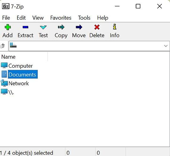

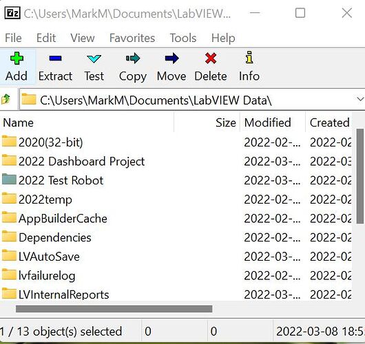

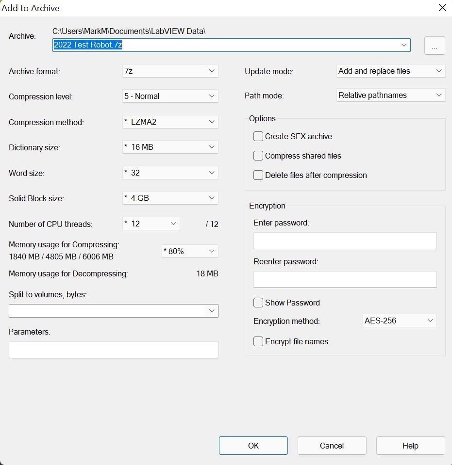

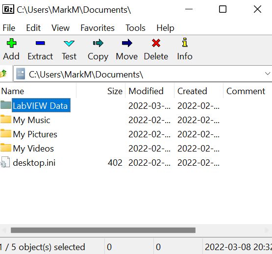

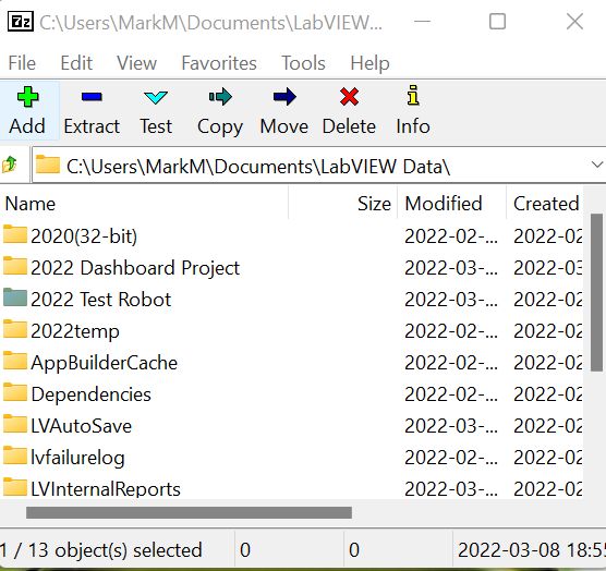

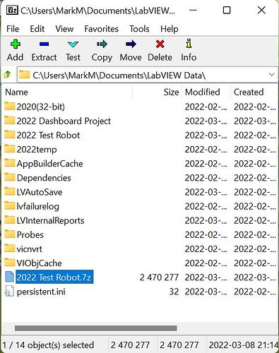

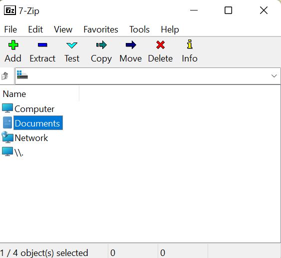

Here are screen shots of each of the steps to see if this helps:
  • Start the 7zip app
  • Double-click on “Documents”
  • Double-click on “LabVIEW Data”
  • SINGLE-click on 2022 Test Robot to highlight it (my project name)
  • Click on Add in the top menu bar
  • Click on OK
  • Click and drag 2022 Test Robot.7z to your desktop

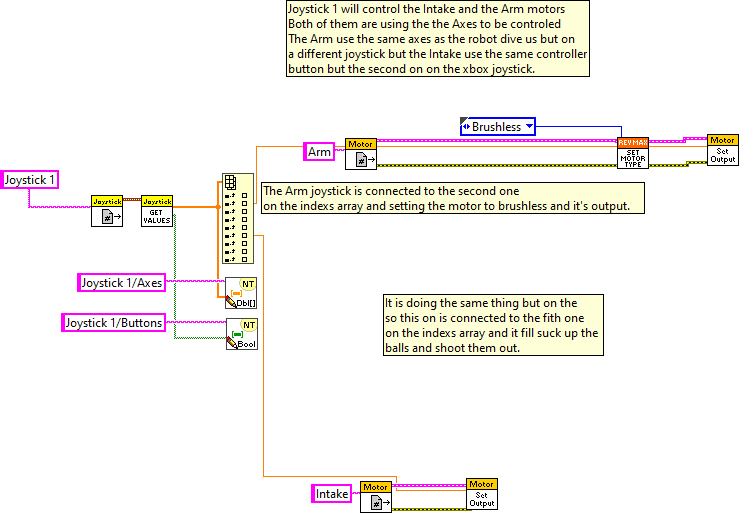

For some reason It won’t let me but the code into it can I just take a photo of the code so that you can se it
It’s what’s not in the photo that I want to see.
I think there is something else going on and it takes a minute to track it down if we can see it.

Begin.zip (20.8 KB) Autonomous Independent.zip (39.0 KB) Here the two files you need
You are setting the Safety Config on your Intake Motor in Begin.vi
Change that to Disabled instead.
okay anything else I need to do
You don’t have any way to execute that code in the “Your Turn” case.
It won’t run in Autonomous.
The other cases can be run but they have bugs that will prevent them from working fully.
So what should I do to fix it and make it work then
You can fix “Alternative 1” by changing “Enabled” to “Disabled”
(This assumes you fix the same problem in Begin.vi too)

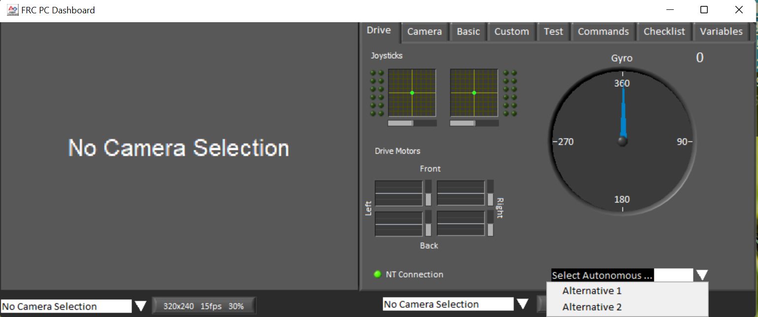

Do you know how to select the different autonomous cases from the Dashboard?
Alternative 2 has joysticks in it.
Those do not work during Autonomous
I think you have to choose the different case and deploy it what case you have choosen.
Can I replace what I have in Your Turn frame and replace it into Alternative 2 to get it to work
All your code gets deployed, and you can switch between those autonomous setups you have using the Dashboard.
It’s here on the Dashboard:
okay can I replace what I have in Your Turn frame and replace it into Alternative 2 to get it to work
Yes, that would work.
Later I can describe how you add more cases like “Your Turn” to that pull down list.
