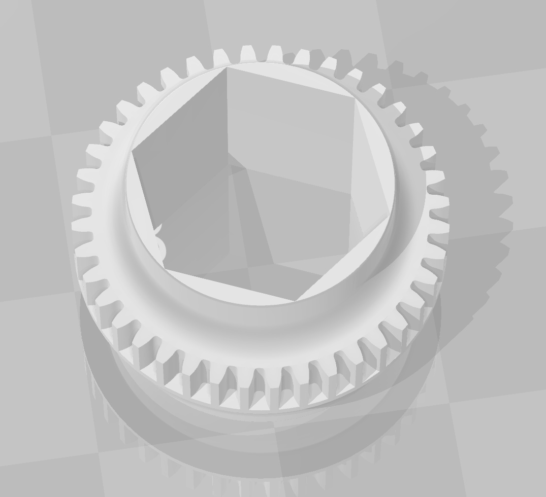

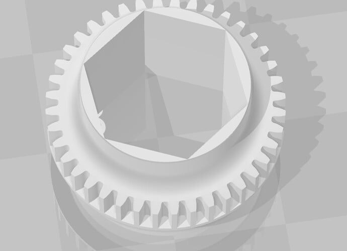

That said, I too would prefer an encoder option that could incorporate a hex through hole. This fall, we’ve played around with the 3D printed solution from the thread the OP linked, and it’s pretty straight forward and functional. Just printing on the team’s Makerbot got something that worked, although the gear teeth weren’t the greatest - I wouldn’t want to put it on a competition robot with it. We’ve been looking at possibly getting a sponsor with a professional 3D printer to make a batch for us that would be higher quality.
Fun fact, you can actually make something very similar to that utilizing the versaplanetary integrated encoder and a 3D printer. We utilized the VP encoder housing / mag encoder with a 3D printed (.5 HEX through hole) replacement internal gear and just bolted the thing to the side of our 2017 shooter. [strike]I tried to find the model or a picture but was not able to find anything quickly. I should be able to get a picture when I visit our shop tonight if you would like to see it. [/strike]
We did not seem to have any issue using it with a PID to control our RPM. YMMV.
I can personally vouch for a similar solution. My students found one designed by team 5406 that has a full mount. It is designed to fit over the .5" hex axle and bolt to the Versablock mounts. We used it with fantastic results last year.
They have it posted on Thingiverse here.
