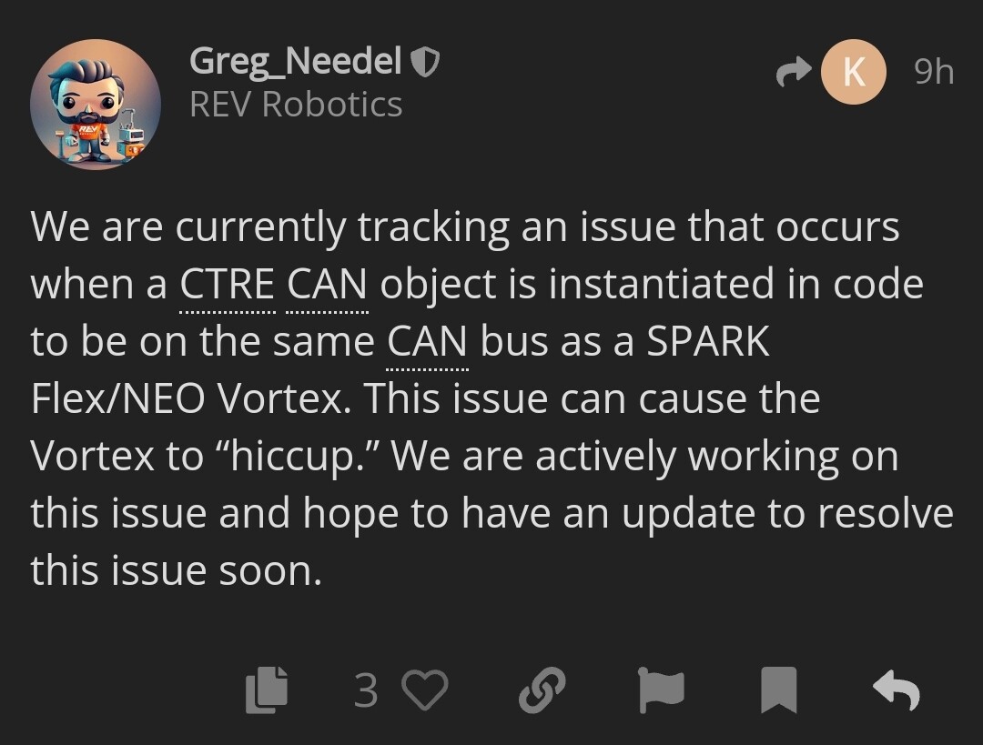

Also if you are using cancoders from CTRE there is a know issue REV is working on to fix. Having Cancoders on the same CAN bus with a flex motor controller will make the vortex motor stutter or hiccup as Greg stated
