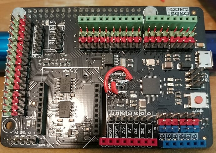

One solution I’ve used in the past is one of these RPi Arduino Shields from DFRobot Arduino Shields for Raspberry Pi B+/2B/3B/3B+/4B - DFRobot and use Serial, however the Serial for the Pi and Arduino aren’t actually connected to each other… The Switch just changes which device is talking to the XBEE Socket, so I ended up removing the switch and soldering it myself…

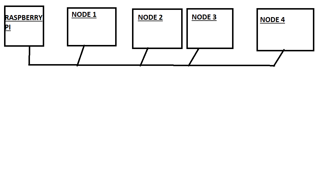

This is the basic idea. I want to be able to have the nodes talk to the Raspberry pi which we call the brain. The brain will then communicate back and forth with the nodes. I’ve looked in to spi that has to many pins for the way i’m planning on connecting to it. I2c, I have to make a address for each one but if I could make it that the brain gives them an address then i would use that, but i dont think you can do that.
Gotcha, I think.
Address negotiation definitely adds an extra layer of complexity. At least for what I’ve seen, address negotiation isn’t part of normal I2C operation.
FWIW CAN, by itself, does not do device addressing, which might suit your purposes well. But, it’s a double-edged sword - in order to understand which node is sending data, I think you’d have to use some other higher-level protocol (ex: J1939’s address claim) or make one yourself.

Unless you’re trying to achieve very-long distances (already mentioned in another comment), the KISS solution to your goal is to use an I2C bus with 3.3V Arduinos as the slave modules (thereby avoiding all the level-shifting requirements). (The Seeeduino v4.2 is a good example of a Uno-style Arduino-compatible board that supports 3.3V I/O; Adafruit and Sparkfun sell many other Arduino-compatible boards in other form factors that support 3.3V.) The RPi and Arduinos already have all the I2C port hardware and drivers built in, so no further interfacing or conversion hardware cost and complexity are required.
If you need to go more than 10’ to the slaves, use (shielded) twisted-pair wiring for the I2C connection for better noise tolerance; using RS-485 connectors with COTS Ethernet cables is a simple solution for this.
The I2C bus architecture assumes each slave has a preset address. But you could run an I2C port scanner at each boot-up on the RPi to find the connected slaves addresses, thereby eliminating the need for pre-definition of slave address on the master.
would that mean I would still have to pre-define the slave addresses?
Yes, you’ll need to pre-define slave addresses. I2C supports 7 bit addresses (that’s 127 unique addresses), so it’s not a significant limitation for small local systems.
is there a way to give the slaves a generic address then have the brain give the address to them on first time boot up for the slaves?
You could experiment with that. But I doubt it would work on Arduinos. The critical parts of the program setting up the I2C link on a slave node are shown below. “Wire.begin(8);” sets up the I2C port (with address 8), and “Wire.onRequest(requestEvent);” sets up the required interrupt handler. I’ve never seen these commands placed outside the setup() section of code. There’s also not a Wire.end() command to stop and clear or release the I2C port. You’d need both these capabilities to change the I2C port address and restart communications.

I suggested I2C as the KISS solution because it only requires 3 wires to communicate. But if you chose the SPI interface instead, you’d need 4-5 wires to each slave but addresses are no longer a factor because it uses the Slave Select wire (unique to each slave node) instead of unique addressing. No address hacking required, with the penalty of at least one additional wire required per slave. Is that a better fit?
