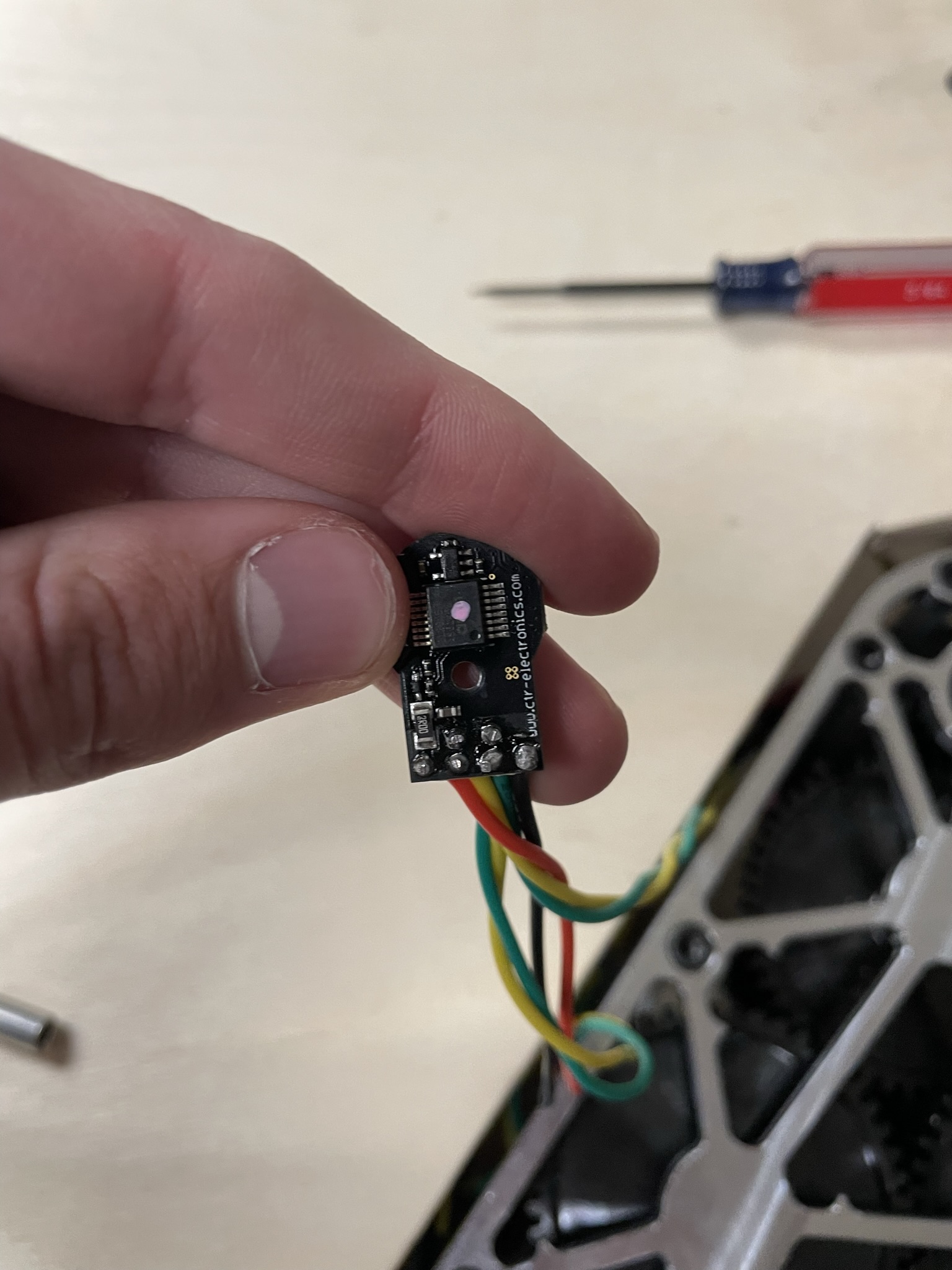

Hello, we are having trouble with one of the CANCoders on our swerve modules. All of other encoders are blinking green and show up in Phoenix Tuner however this one does not show any lights and is not in Phoenix Tuner. With a voltmeter it is seen that it is getting 12 volts. It is also hot to the touch. Is it reasonable to assume that it is just fried?

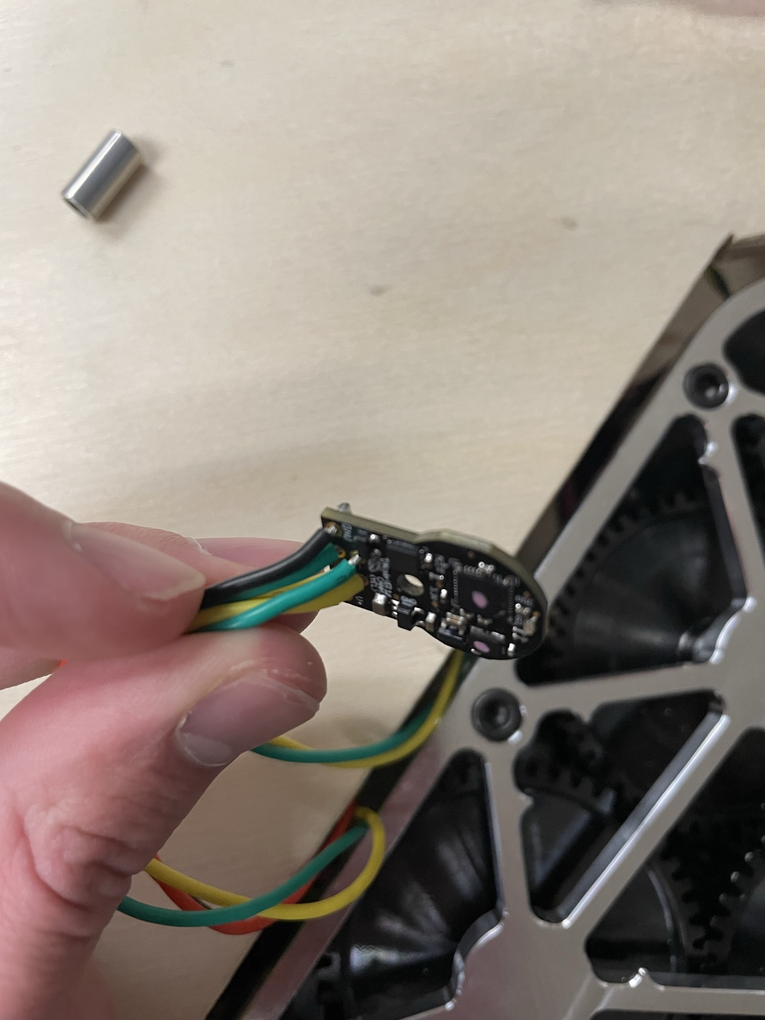

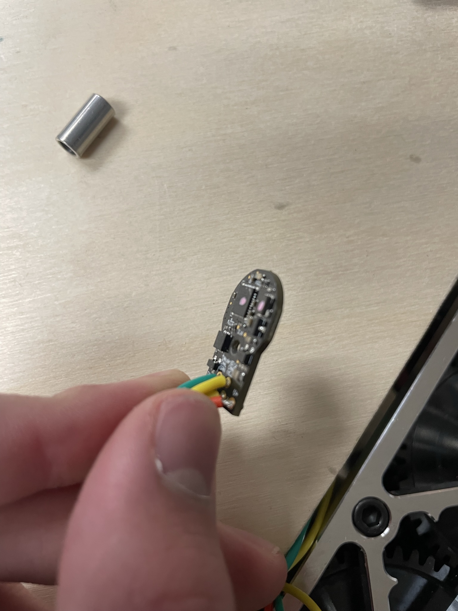

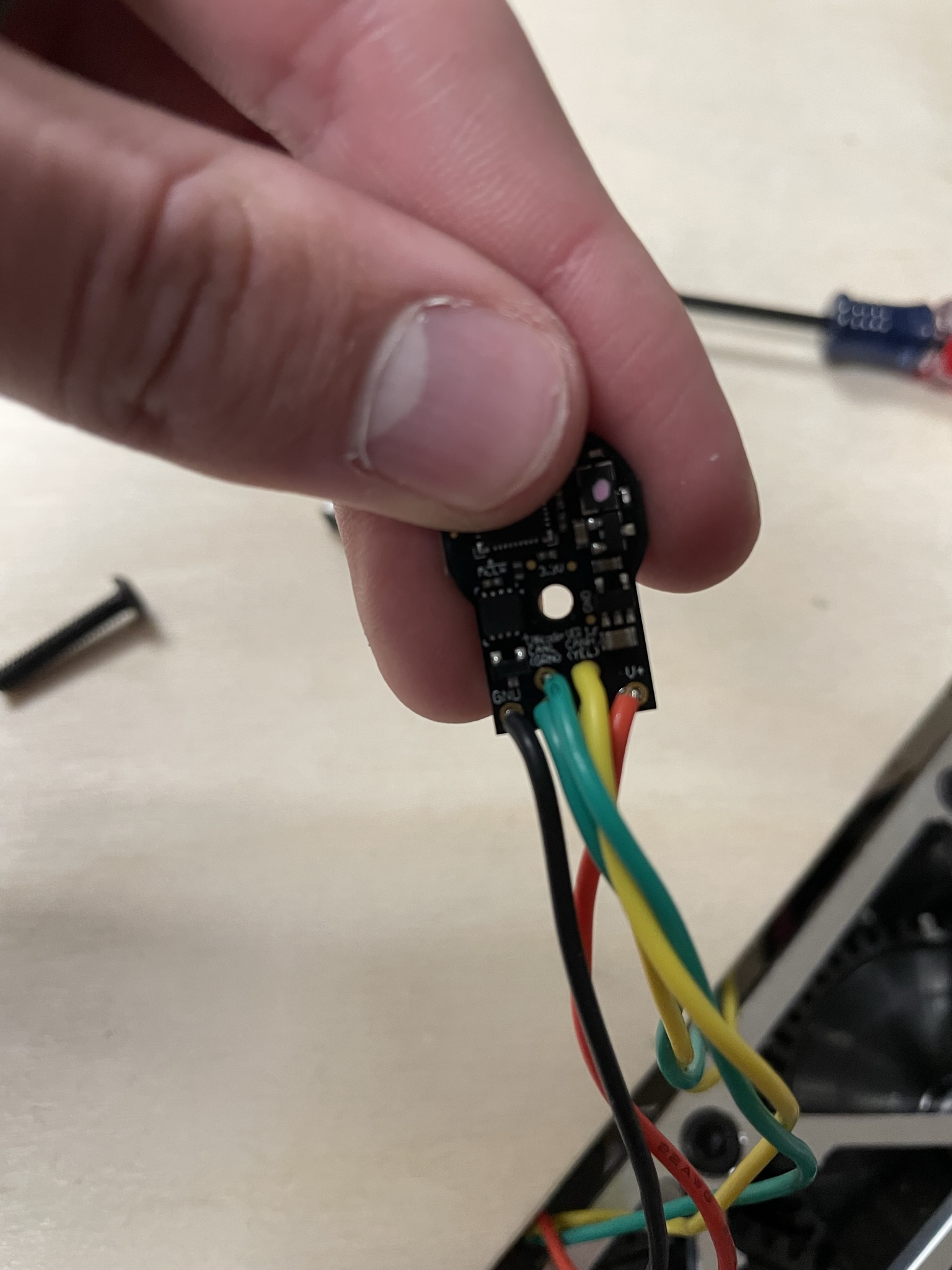

Here are some images:
Thanks. I don’t see anything obviously wrong there.
