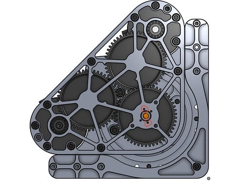

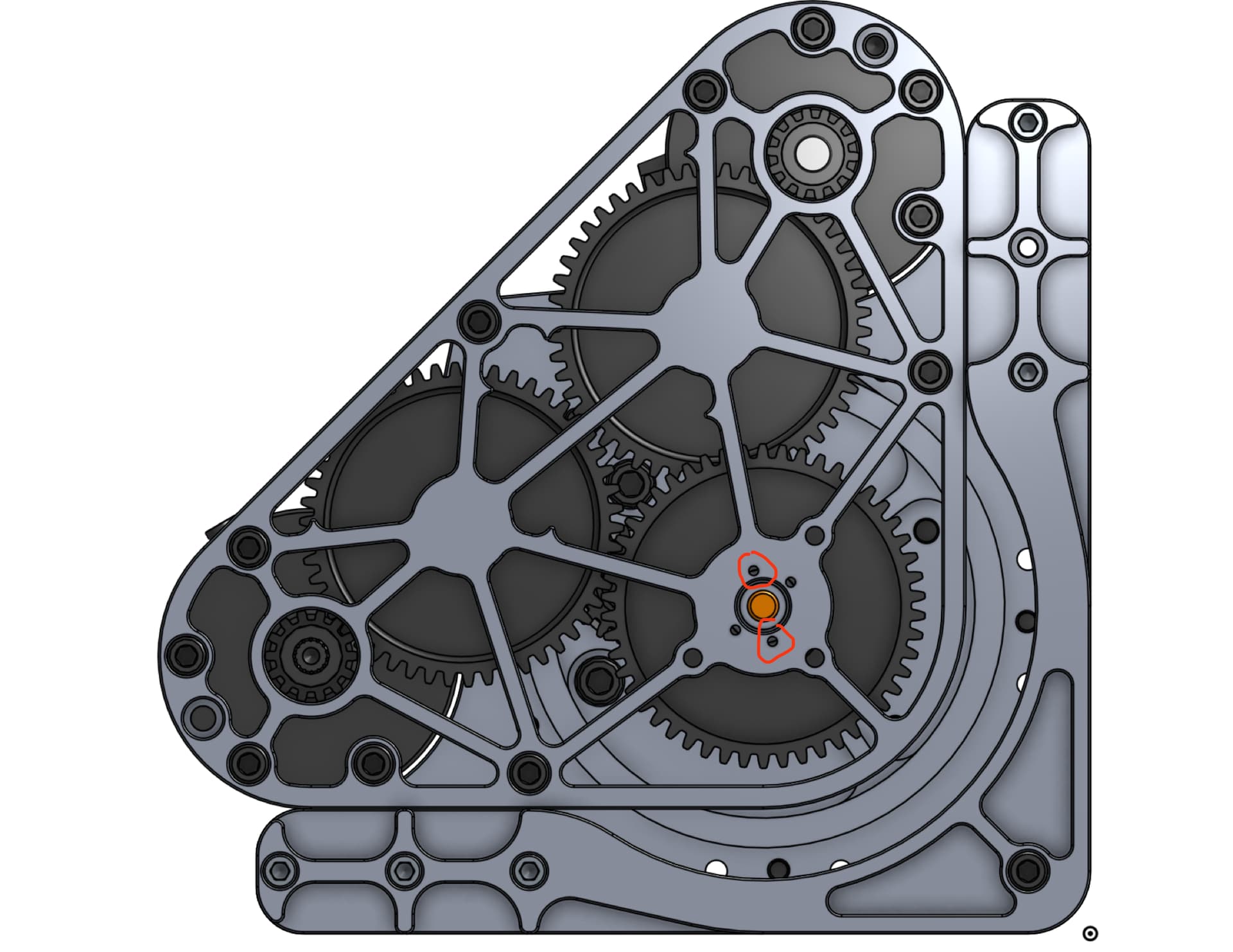

In the context of SDS swerve, there are two #3-48 screws that go through the CANCoder case and into tapped holes in the swerve plate (see image). There are four holes on the plate so you can mount it in two different directions.
The magnet for the encoder is glued down into hole (orange part of image) so that when the wheel rotates the magnet will also rotate.
